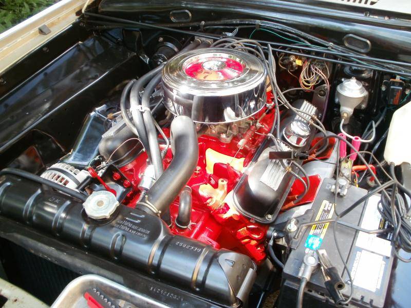

What do you have for a 273? Here's my 66
Mike
That's what my 273 should look like. Mine was in my 71 Demon when I bought it. The Demon is long gone but still have the 273. If I remember right it is a 67 or 69. I had 2 of them. I kept it around because it ran pretty good for a little engine
