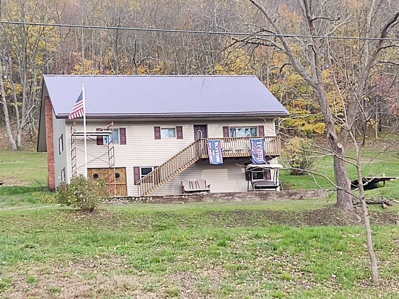

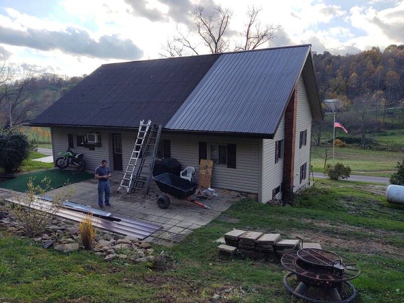

Just a few months ago I decided I was going to roof my house myself after seeing the quotes... Nope not happening! Last week I crawled up on dad's roof to find a leak, it was shot, the whole thing needed replaced and it being dad I wasn't about to tell him to hire it out but I sure as hell am hiring mine out!
If it wasn't for whiskey I wouldn't have made it but boy am I feeling it and it isn't even done yet!

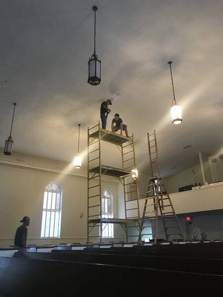

I think with age comes wisdom. There used to be a time when I would walk fire sprinkler lines from one end of a building to the other. Im talking 4 inch or bigger lines not the small stuff. But now? Not on your life I guess i realize I am not nearly as bullet proof as I once thought. We had to build a scaffold 3 high to work in a church sanctuary. I tried to go up and stand there my legs and nerves were not having it. Instead my 21 year old son went up there fearless like I once was. Here is that picture. And on another job there was a foyer fixture in the middle of an open staircase. My dumbass gets up on a pallet on a duct lift. That was my last height thing. Also is a video of that.

I’m just curious. Is that an optical illusion or is the roof blocking the chimney?
It's blocked off, he hasn't used it in 20 years and didn't feel like tearing it down so we knocked it down below the roofline.

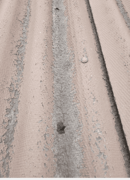

Is the old roof on your dad's Ondura panels ?
Yes, I hate that crap! They claim an impressive warranty but you really have to keep up on the paint or it won't last 10 years. They've since changed the way it's made, what they offer nowadays looks better?
I almost used Ondura panels when I re-roofed my house but went with Galvalume and am damn glad I did. The new roof on your dads house will outlive him and you but might need to recheck the screws for seal tightness after 10 years or so. They say to check the screws every couple of years for tight seal but with the technology used in today's roofing screw washers they last a lot longer than they did 20 - 30 years ago.
I feel bad because I did roof my house with it which is what led him to doing the same, it looked great, had a great warranty so what could go wrong? Here's what we found as the culprit behind his leak. The sun literally bakes the asphalt right out of the material to where it's absorbent, how it turned into little holes I don't know but it's enough for me to never use it again. My roof is holding up a bit better, possibly because his faces east and west and gets way more sun. He also elected to install it directly over purlins, I advised against it but that was after hurricane Katrina and plywood was through the roof. Oh well, he should be good for life now.
