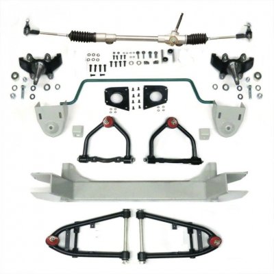

Has anyone used this kit? Its over 1/2 off...not sure but comes with a cross member, but then says it works with QA1 and other components....

The upper control arms? just don't look right.
I thought they look like gm...I'm going to reach out to mfg ( Helix) tommorow. I'm curious if the track width is different... The price was what peaked my curiosity. Its only slightly more than a front rebuild kit with the added benefits of header clearence and a rack....I can't afford an Altercation or Schmidt ....
The ad says the stock photo may not be exact.
Seems like a good price if the quality is there.

Keep in mind that it does not come with the coil overs. So that will be an added expense that can be costly as well before you pull the trigger.

It is as pictured, spoke to Jim at JLM, it does not come with rotors, calipers or coilivers, those are additional $$$ but over all not a bad price. Track with can be narrowed to 58 1/2"
They have another complete ifs hub to hub on sale now for $1500 ( norm $3-4k) w drilled/slotted big rotors...he went on to say that all components are designed here but some pieces are outsourced.....
It's very tempting, ijdk...It is Helix brand

From what I can tell that is a universal kit not going to be a simple install. I went on the helix web site and they don't make anything specifically for our cars.
The listing showed b&e body mopars, now that being said I kind of take it with a grain of salt and would expect some not bolt in fabrication to be done...
Friend is putting in a Fat man set up in his 55 bird and we have had to do some "fitting" to get it to work...

This setup really has me curious. I would really like to see some photos of one installed in a late 60's b body. I watched some video on youtube of an install and they had to do some frame boxing. now with our unibody setup that part may be more difficult and how is this fitting around the k frame or are you eliminating the k frame and mounting the engine mounts to the new cross member?
When I spoke to Jim, he confirmed that that the k member goes away as do the torsion bars...and I guess that's what intrigued me along with having a rack. It's a mustang 2 minus rotors, calipers, shocks/coilovers...
sounds almost to good to be true. Would be nice to actually see one done and have a true review on how it works in our cars.
