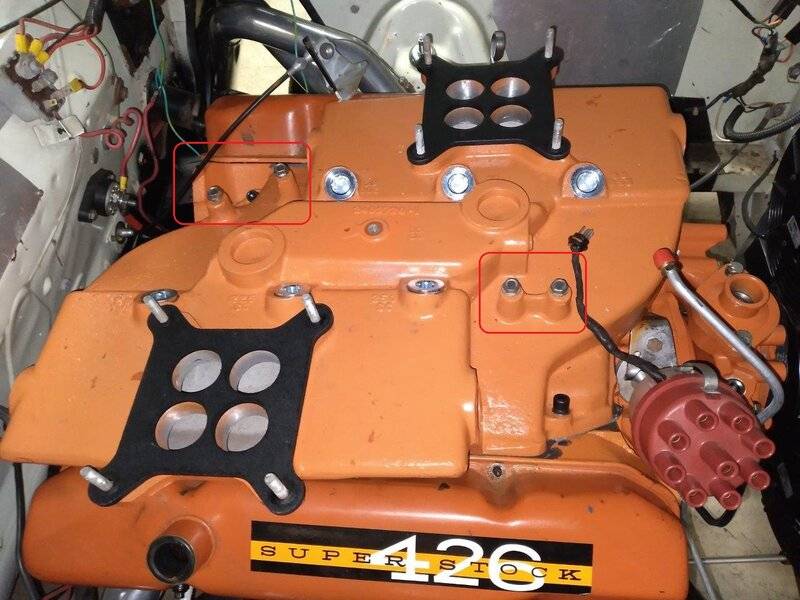

Yup, I did that. Yes, I'm an idiot. I post this in an effort to warn those after me. I installed the MW crossram backwards. In my defense, this is my first experience with MW cross rams and I failed to realize that I could actually do that. In the interest of full disclosure, this is my post. I discovered this when I was installing the MW XRAM linkages. To those that follow, verify that you have it right. The easiest way to do that is visually verify that the throttle linkage plate mates and bolts up at the REAR of the intake and the coil mounting bracket is at the FRONT of the intake. It is entirely possible to swap these (as I had done) in error. Rookie move for sure at the ripe old age of 65 in my case. Embarrassing for sure but at my advanced age of 65 I'm past that. I could have spared myself the embarrassment but it is what it is, go ahead and laugh, I will laugh along with you, it is funny after all.
I've attached a pic to keep other dumbasses from duplicating my error.
