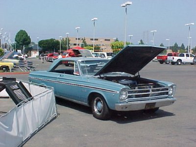

About 15 years ago, I picked up a 1965 Plymouth Belvedere II with the Poly 318. Despite everyone saying "it's a boat anchor" and "ditch it for a big block", I liked the uniqueness of the Poly, and set about making my car unique.
This was when I first bought the car, and installed a set of cop car wheels because the stock wheels were too skinny for me:

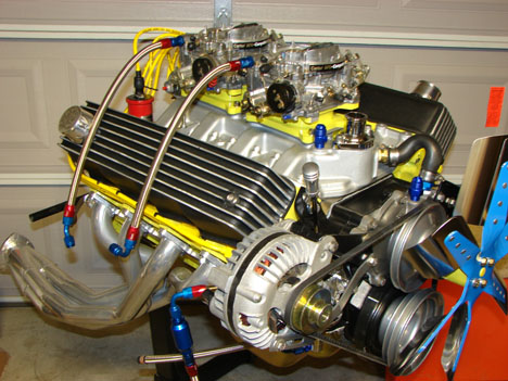

I spent some time with building a new engine, using another '65 Poly and spent a couple years' worth of tax refunds on it:
Then it was time to drop in the new motor:

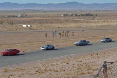

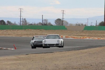

That's how the car sat, for a while, until one day I put some Hellwig sway bars on the the car and took it out to Willow Springs. I loved the fact that I could catch this Porsche in the fast corners:

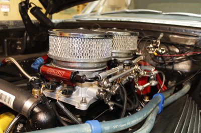

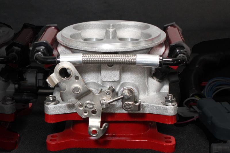

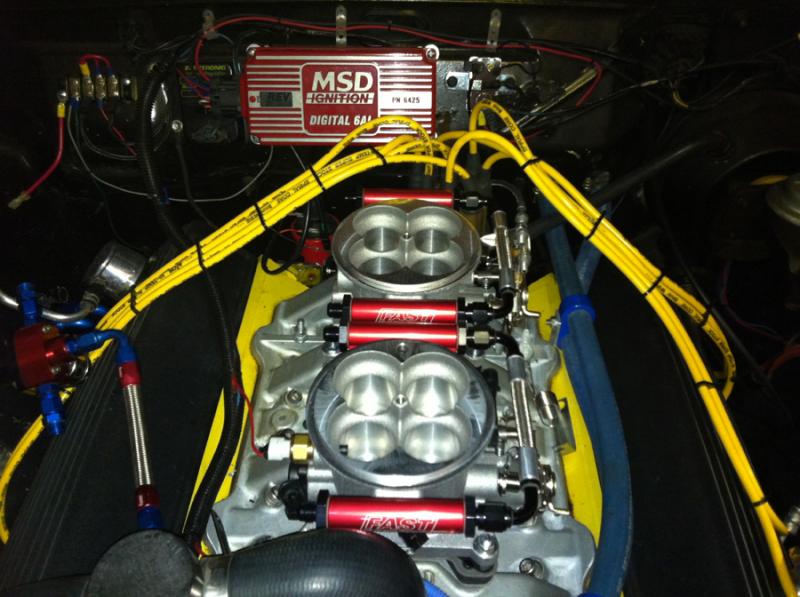

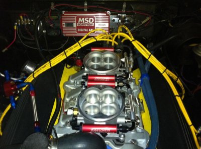

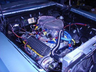

From there, I knew that it was time to get serious about some other things. I installed a FAST EZ-EFI on my Weiand dual quad intake, and had to get a little creative since the bolt patterns didn't match from intake to throttle body. This two inch spacer was perfect:
So the EFI was test-fit, and it was close, but it was going to work:
I got the EFI installed, and surprisingly it improved not only the MPG, but I also gained about 20 RWHP:

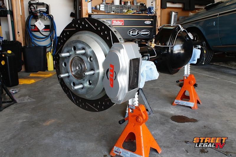

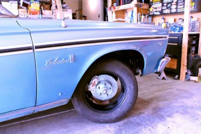

The brakes needed to upgraded before I went out on the track, I had installed a Mopar front disc brake upgrade, but I needed something better, so I went to a four-wheel disc setup from Master Power Brakes:

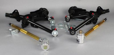

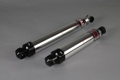

The next step was to upgrade the suspension to get a little better corner carving at the track with QA1 control arms, adjustable shocks, and dynamic strut rods. I also upgraded to a Hemi torsion bar:

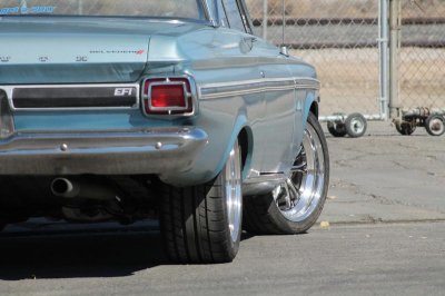

My first set of brakes fit inside my 15-inch cop car wheels, but since you can no longer buy 15-inch 50-series tires, I opted to step up to Weld Racinng Wheels and Mickey Thompson Street Comp tires... and bigger front brakes:
After these upgrades, I was really starting to improve my lap times, and the car was getting a lot more fun at the track. I was starting to pass modern musclecars in the turns, like Mustangs and even some Corvettes, and keeping up with cars that should have been much faster in the turns than I am:

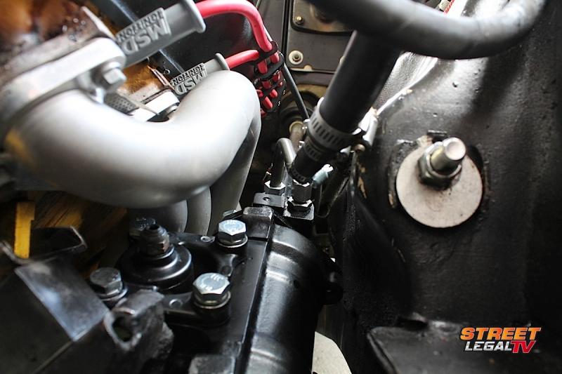

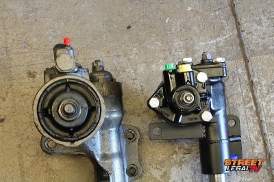

The steering was a little sloppy, so we upgraded to a Borgeson steering box, and removed 13 pounds, got a quicker ratio, and firmer steering:

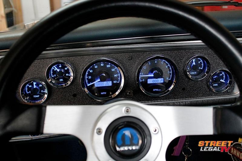

Wanting to keep better track of my engine's vitals, I opted to install a set of Dakota Digital gauges, and I'm absolutely in love with them... the functionality and the ability to program things like the speedometer, the fuel sender, etc., are awesome:

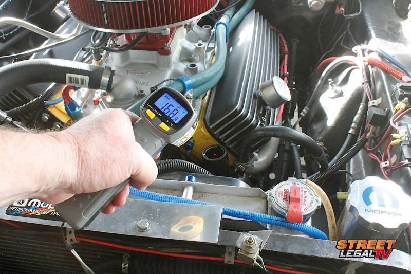

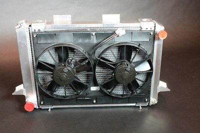

I started to notice that my track temps were rising, so I purchased a Be Cool radiator, and decided to perform a real-world test. I took my car to the track, raced a session, then came into the pits and installed the Be Cool radiator and put cooling in it for the first time, then headed back out on the track. I actually saw my on-track temperature drop from over 230º down to about 180º:

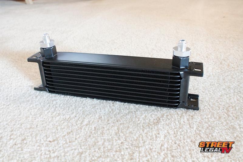

I also kept things like power steering cooled down with a Derale cooler, which dropped my in-pump fluid temperature 8º:

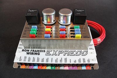

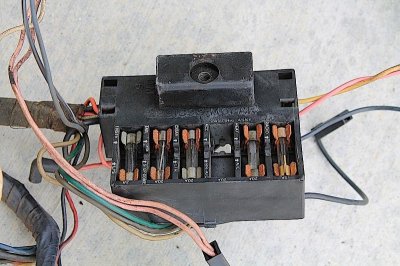

And with all of these electrical add-ons, I decided that rewiring the car was a good idea, and replaced the old harness with a new kit from Ron Francis Wiring:

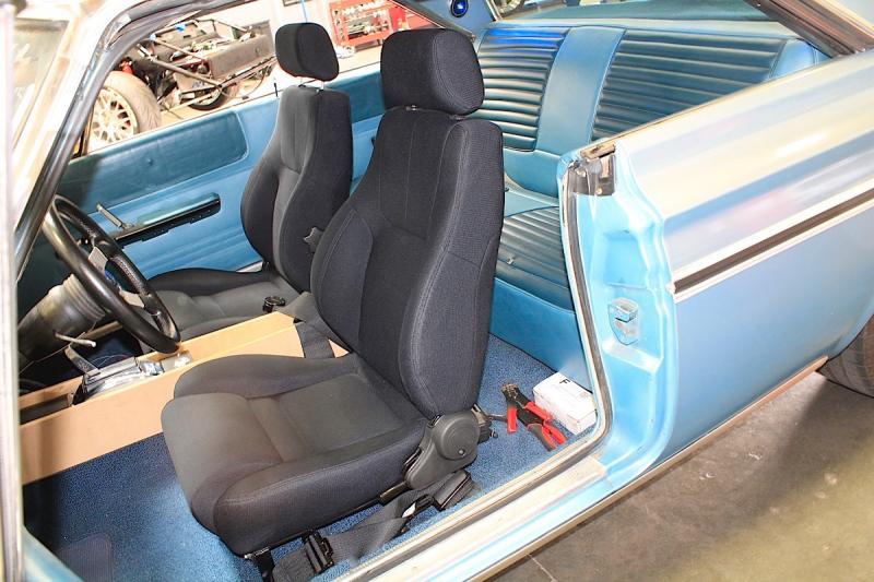

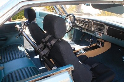

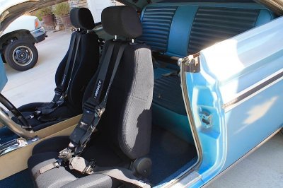

For the past two years, I've been racing at Willow Springs with the factory bench seat and lap belt, so I decided it was time to install buckets and harnesses. Procar Lumbar Elite seats were a perfect choice for street/road racing, with Impact Racing five-point harnesses. To attach the shoulder belt, Chris Alston's Chassisworks created a new universal harness bar, inspired by my need for something removeable:

We ran an article on the wheels and tires, but unfortunately Weld Racing doesn't make that wheel anymore (it's the S74). I'm running an 18x8.5 front and 18x9.5 rear with 245/40R18 and 275/40R18 Mickey Thompson Street Comp tires. My plan (for now) is to run the 275 in the front and a 295/35R18 in the rear. I know they'll clear everything now, and they'll fit the current wheels.

Love what you have done with the car, and use ideas from what you did with my build. Why did you go with the MP brakes as opposed to Wilwoods?? Just curious..
