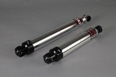

The next step was to upgrade the suspension to get a little better corner carving at the track with QA1 control arms, adjustable shocks, and dynamic strut rods. I also upgraded to a Hemi torsion bar:

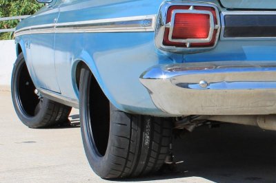

My first set of brakes fit inside my 15-inch cop car wheels, but since you can no longer buy 15-inch 50-series tires, I opted to step up to Weld Racinng Wheels and Mickey Thompson Street Comp tires... and bigger front brakes:
After these upgrades, I was really starting to improve my lap times, and the car was getting a lot more fun at the track. I was starting to pass modern musclecars in the turns, like Mustangs and even some Corvettes, and keeping up with cars that should have been much faster in the turns than I am:

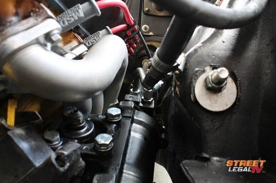

The steering was a little sloppy, so we upgraded to a Borgeson steering box, and removed 13 pounds, got a quicker ratio, and firmer steering:

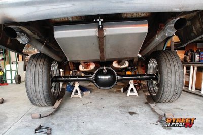

The car was really starting to handle the turns and I was going a bit faster. My deficit was that I have about 340 HP and the gearing in the trans isn't that great... coming out of a turn, 2nd is revving too high, and 3rd is not revving high enough, but after about five trips to Willow Springs, I was able to knock about 8 seconds off my lap times. But one real issue I was dealing with was fuel slosh, so I got a custom tank made by Rick's Tanks:
I had previously installed a set of Moser axles and a Detroit Truetrac, but later installed a complete, brand new Moser Engineering 8-3/4 rearend:

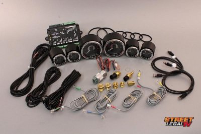

Wanting to keep better track of my engine's vitals, I opted to install a set of Dakota Digital gauges, and I'm absolutely in love with them... the functionality and the ability to program things like the speedometer, the fuel sender, etc., are awesome:

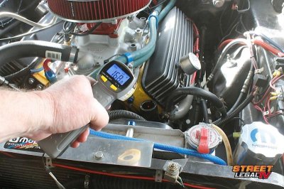

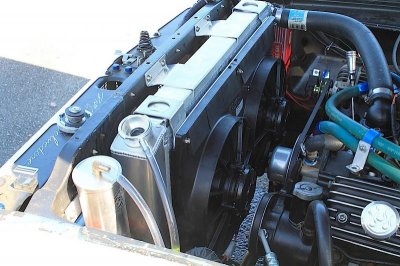

I started to notice that my track temps were rising, so I purchased a Be Cool radiator, and decided to perform a real-world test. I took my car to the track, raced a session, then came into the pits and installed the Be Cool radiator and put cooling in it for the first time, then headed back out on the track. I actually saw my on-track temperature drop from over 230º down to about 180º:

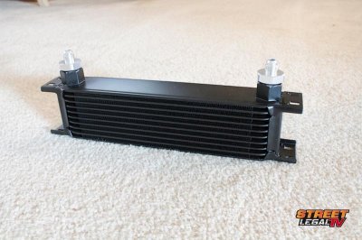

I also kept things like power steering cooled down with a Derale cooler, which dropped my in-pump fluid temperature 8º:

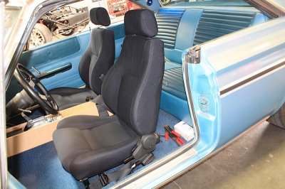

For the past two years, I've been racing at Willow Springs with the factory bench seat and lap belt, so I decided it was time to install buckets and harnesses. Procar Lumbar Elite seats were a perfect choice for street/road racing, with Impact Racing five-point harnesses. To attach the shoulder belt, Chris Alston's Chassisworks created a new universal harness bar, inspired by my need for something removeable:

The tank from Rick's runs about $1200, and that includes a new ss strap and gauge sending unit. They'll provide a pump, or flange it to fit whatever pump you're using. I had bought a tank locally from a hot rod place in San Bernardino, CA, and it was crap. It was supposed to be baffled for road racing, but even at a half-tank the pump would starve. I had to fill the tank to run, and then it would slosh out of the filler next!
Believe it or not, the clown that sold it to me yelled at me because I called to complain.
After that, I went to Rick's and even at very low fuel, my pump doesn't starve during cornering. It's about an 18 gallon tank, too, so it's a step up from the factory and is a little narrower to allow for exhaust. I'm very happy with it.
