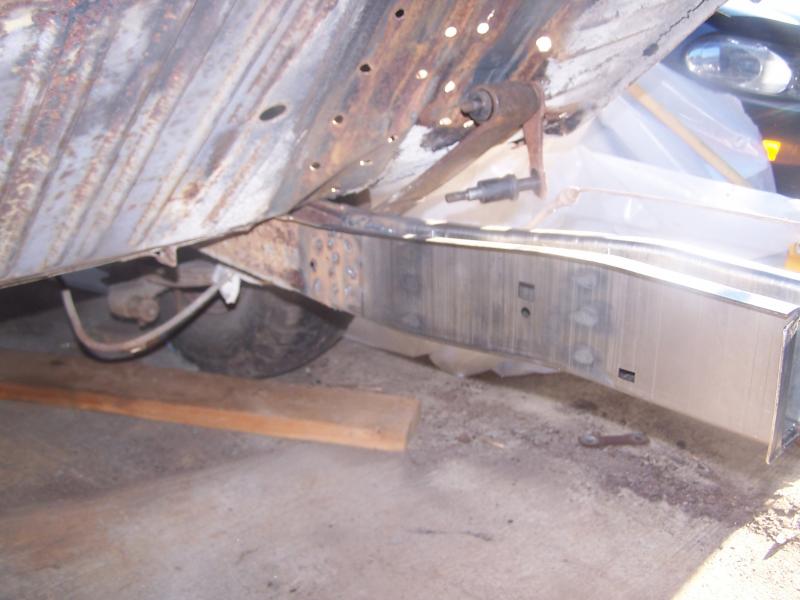

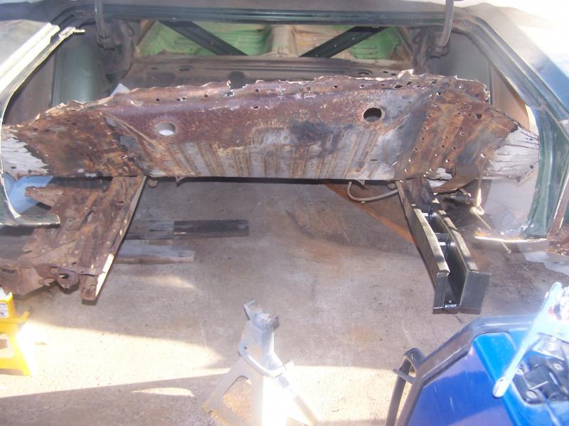

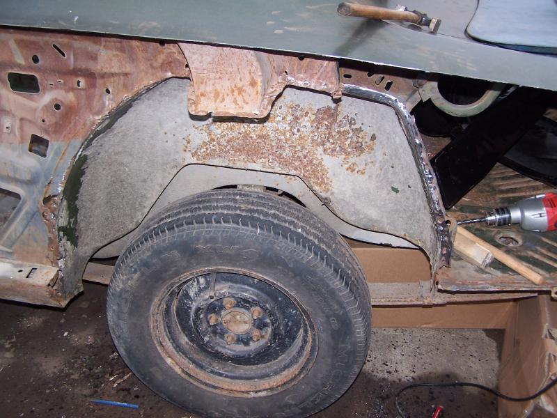

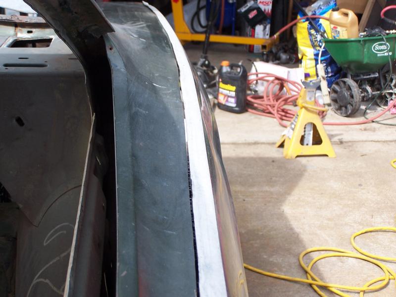

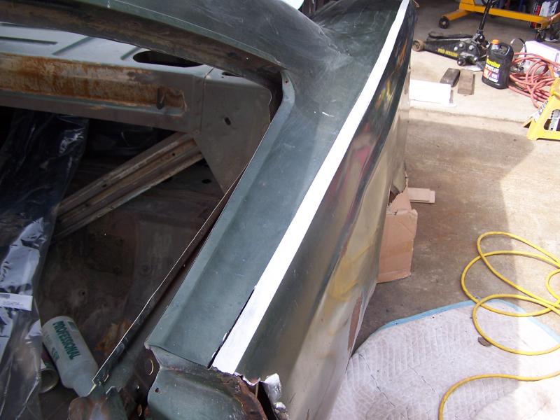

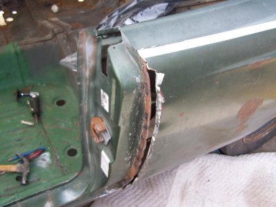

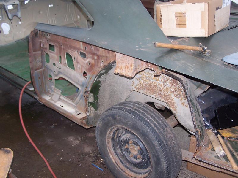

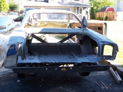

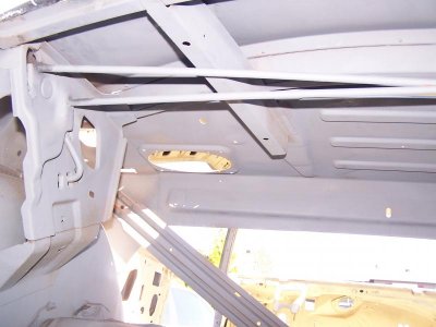

Prepping the rail

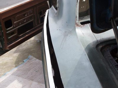

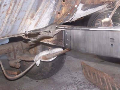

fitting it up

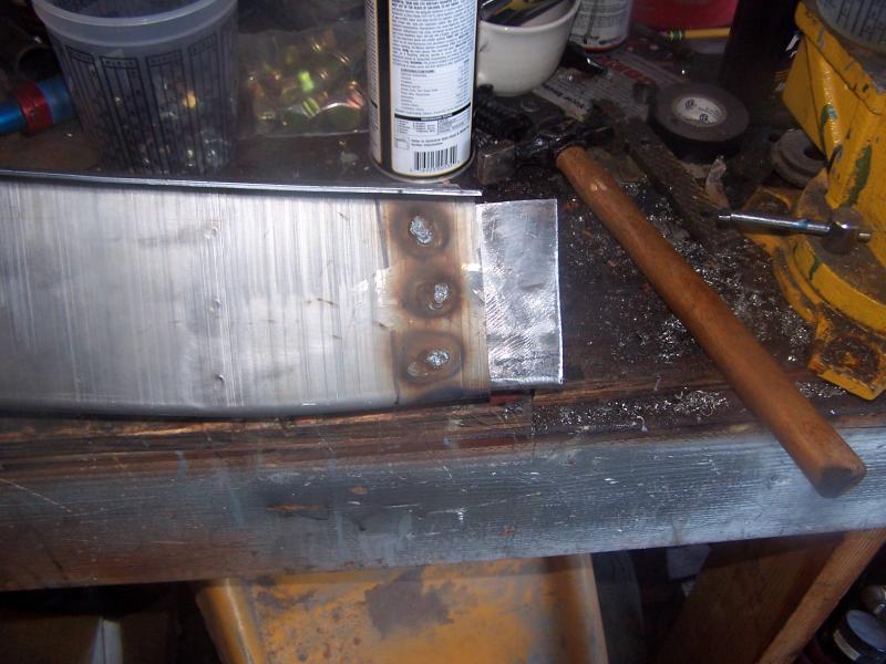

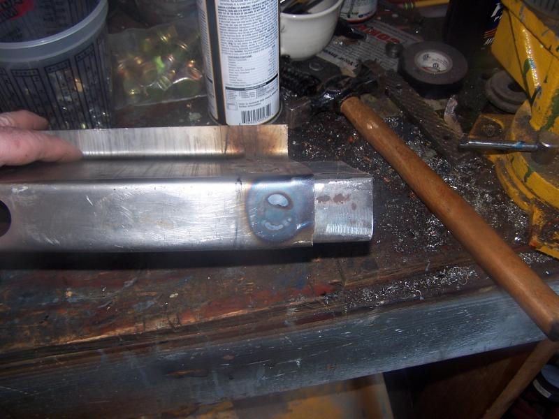

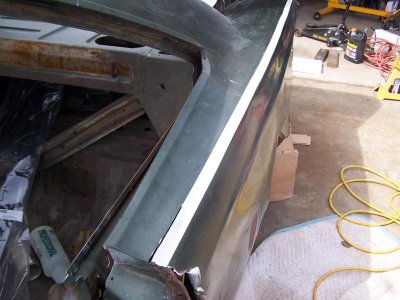

new rail with sleeve

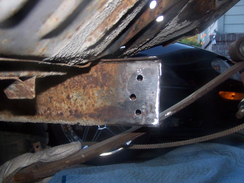

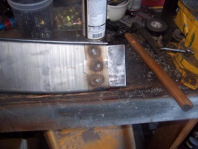

I think the welds are good
one rail one, one to go !
I measured and checked length width and height (level) and it seems to be dead on or within an 1/8 inch anyway...LOL
Lookin Good. Nice job on the sleeves. Remember to leave a slight (1 to 2 thickness of the metal) gap so you get good penetration into your backer where you but them up.
Yep, got a decent gap in there and welded the crap out of it :)
Note the blanket in the picture Roger ?....LOL saves the knees from the pavement
That sleeve looks good and you can't get any closer on your measurements. Glad you are using the blanket. I wouldn't want you to not be able to do anything with your kids cause your knees don't feel up to it.

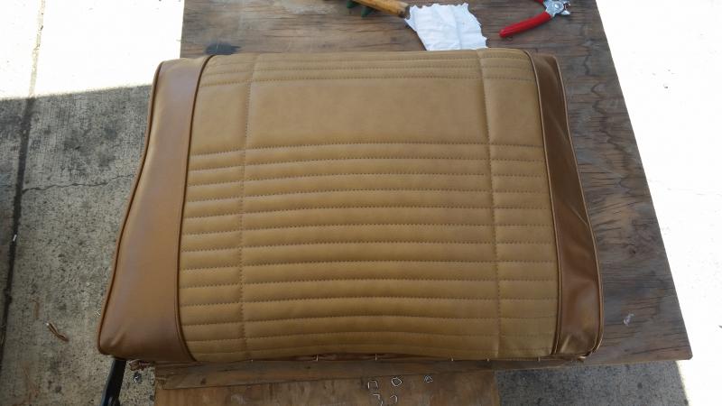

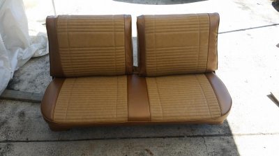

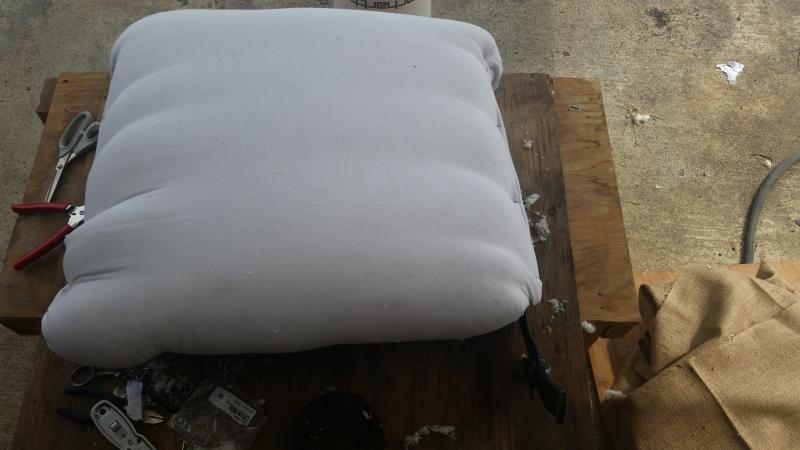

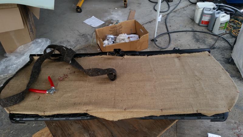

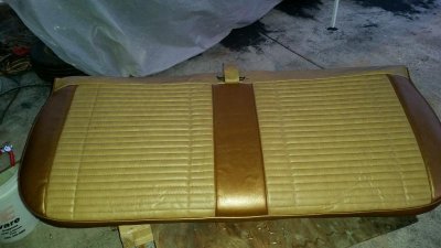

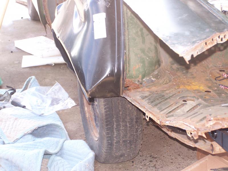

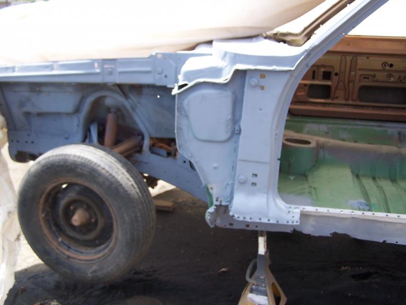

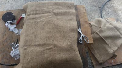

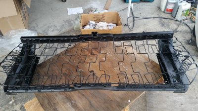

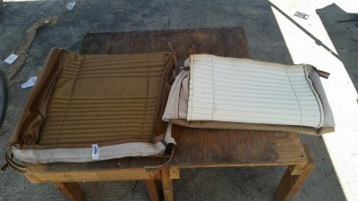

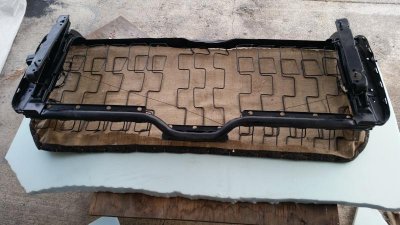

seats

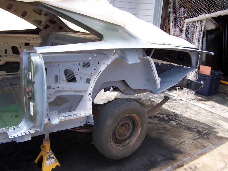

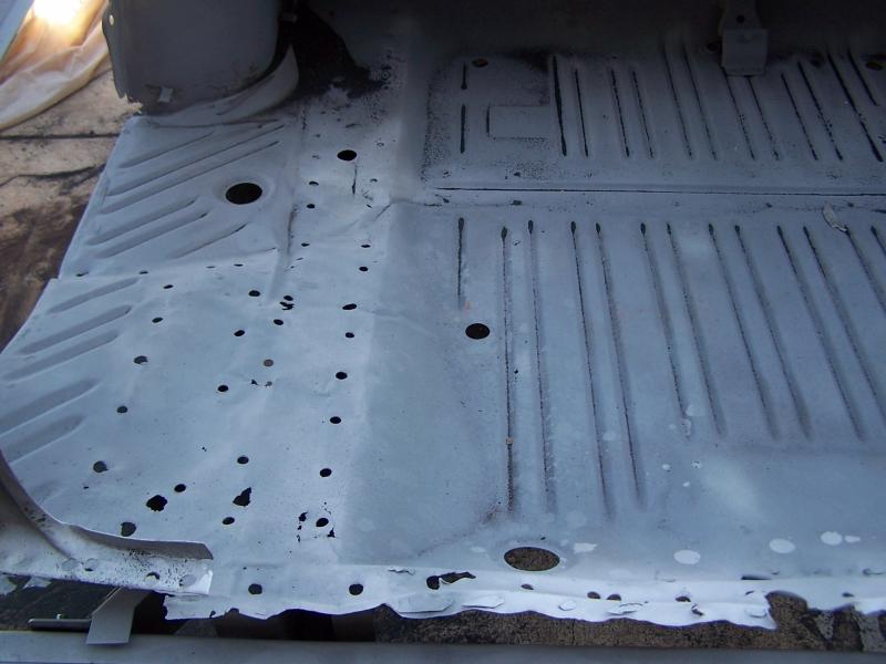

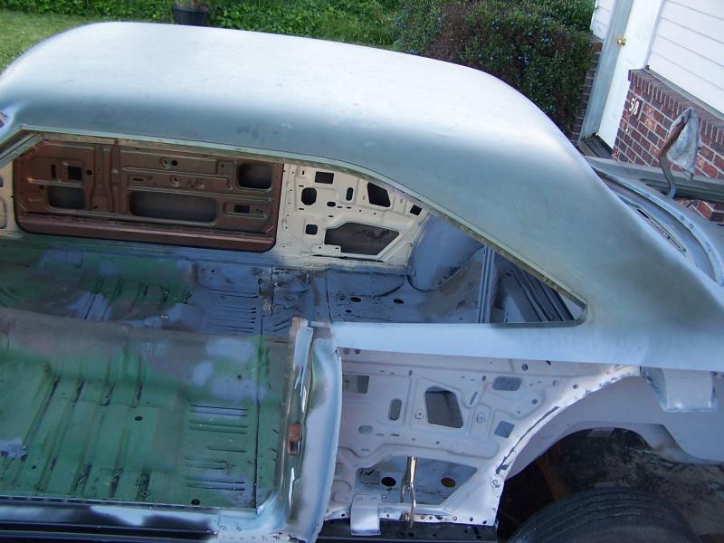

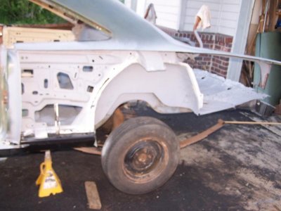

1/4's

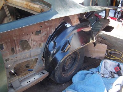

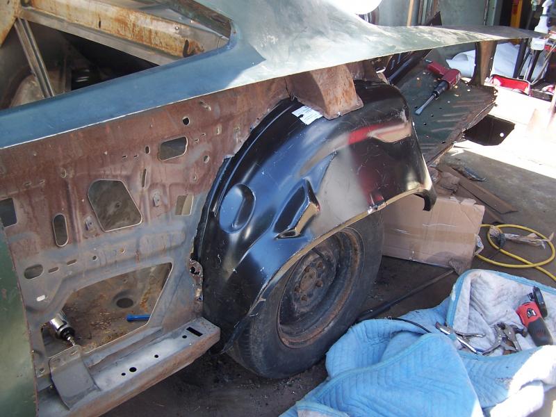

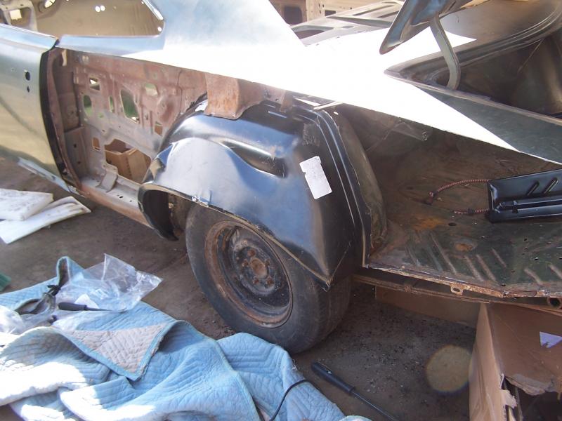

rocker outer wheel well
