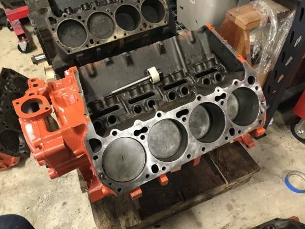

I figured I would make this thread to document my misadventures in building an engine for the first time. If I even get that far.

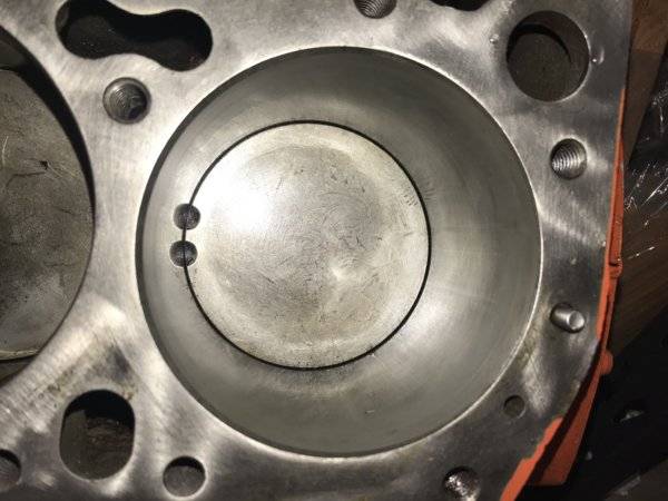

After doing some block research I went ahead a dropped some cash on a ‘76 440 long block off CL. Supposedly this thing had 50k on it when pulled and had never need touched. Just like every engine on CL! Before I purchased I confirmed it had a virgin bore and the cylinder walls looked great. Only “downside” is that it has a cast crank. Well...

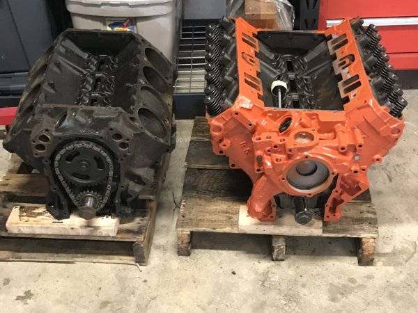

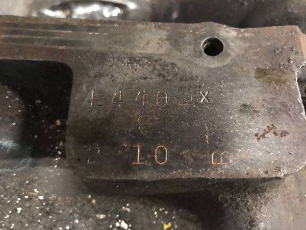

Turns out this guy was also selling a ‘69 440 short block that was very dirty but also a virgin bore and a forged crank. Only downside is it’s a Maltese cross + block, which I found out means the crank was .010 under from the factory.
I think I want a forged crank in my build so I made a deal for both including a bunch of extra parts that came off both engines.
Was going to do $400 for just the 77 but made a deal for both at $600. I figured I could take the forged crank out of the 69 and sell the block for at least $200.
So now I’m sitting here thinking “what did I just do?”
I have dreams of building a pump gas 500 hp at the wheels street car. My 69 Coronet has a 340 in it now and it just doesn’t do it for me anymore.
I saw a guy on CL selling a brand new 4.15” crank. The bought of a 500 stroker is cool but he sold it before I could grab it.
So, I’m not sure what I’m going to do with these. I need to balance my want for HP with the want to not spend money.
Opinions are welcome.

You can confirm if the crank is undersized by looking on the outside face of counterweights. Think it's on 5/6 rod counterweight. I have a factory crank that's .001 on number 5 main and 5/6 and 7/8 rod journal. It's stamped M5 R5678. Don't know what would be on your crank, maybe M/R -.010 . You don't have to remove crank from block, you just spin the crank.
