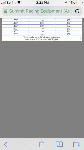

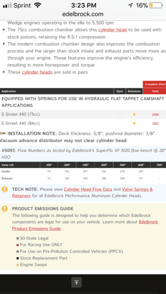

E street are a good head, but they don’t flow nearly as good as the TF 240’s, e Street are cheaper and you can get them with the 75cc chamber to bump up the CR A bit. Here’s a flow chart for each head

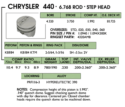

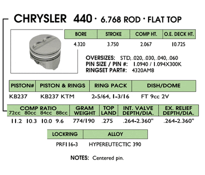

Seems like KB makes two of the same piston for a 440 .030 over. A flat top and Step head.

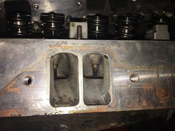

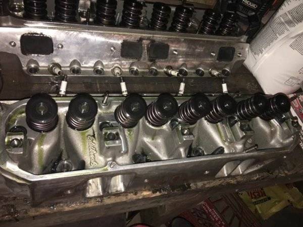

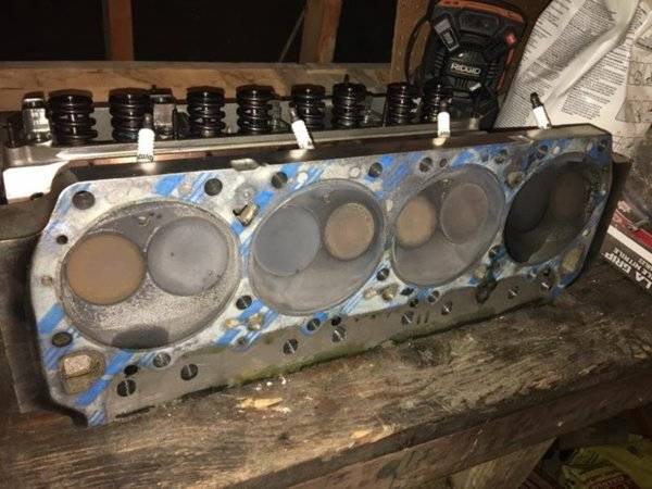

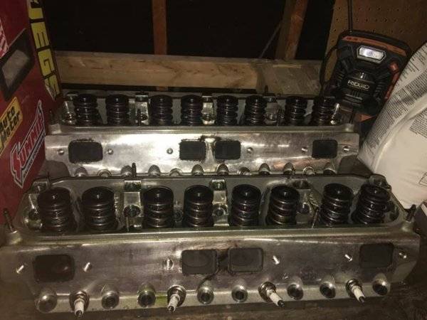

Can anyone comment on these heads that are for sale? Anything specific I should ask?
Eddy Performer $1500
Here are he comments by the poster.
“Just pulled off my 440 they were the 84cc performer RPM heads. Bought new in spring had some port work done and gained 30 CFM on low end also valves were done properly, added 10 degree locks and retainers and heads were milled .030" to 77 cc for better quench with my 440 stock intake still fits. Heads are in perfect shape and only had about 30 Passes on them. I sold my car so don't need them. Have over $2000 in heads and have flow sheets with heads. “
Here are some pics
View attachment 536515 View attachment 536516
No wars wanted, just a statement of opinion having Flowed them all.... TF240/Sidewinders/E-Street & RPM/ Stealth
But having owned a Flowbench for over 35 years, the first one homebuilt using an 8/71 Blower on VFD, with the most recent one now being a SuperFlow SF750 Bench with all the Bells & Whistles, which we also get to Dyno the Engines correlating our Airflow data from porting.....
I would then strongly agree with Hughes Engines, Rehr Morrison, BRODIX, AFR, etc., etc., and on and on....
That Flow numbers by themselves are a very poor way to judge a head ! with equally important power producing features like port velocity, and wet flow characteristics, that very simply.... can not be seen in FLOW numbers by themselves as the primary criterion for a given "application".
Just saying....
Here are some pics
View attachment 536985 View attachment 536986 View attachment 536987 View attachment 536988
In this case a Flow Sheet with Bench used may offer some insights vs ootb ?
Look pretty darn filthy for "new" last spring ?
