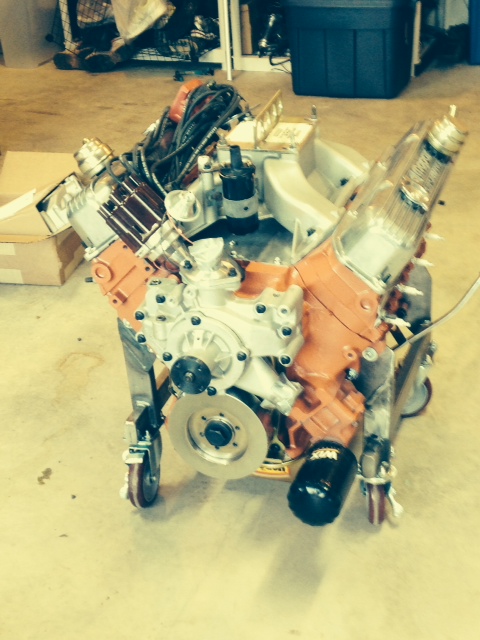

My new engine. I got to hear it on the test stand through my thrush mufflers. Sounds great!

Walls cleaned up .30, forged crank, Harland sharp rockers, milodon pan with 1/2" pickup, bullet cam 257 intake, 262 exhaust. melling hv pump, quick fuel 750, M1 intake, 440 source parts throughout, 10.03 static compression, custom curved dist. from Don at four seconds flat, 906 heads massaged. More to this list, but those are the highlights.
Sweet heart beat you have there...... What's your expectation on the dyno?
Thanks. Computer dyno put it at around 550 and close to 600 tq. I'm very proud of it. Took a long time and a lot of money. The builder is from this site mike stahl. Good guy and a hell of a good engine builder. I learned a lot. I will try to post a video of the break in.
