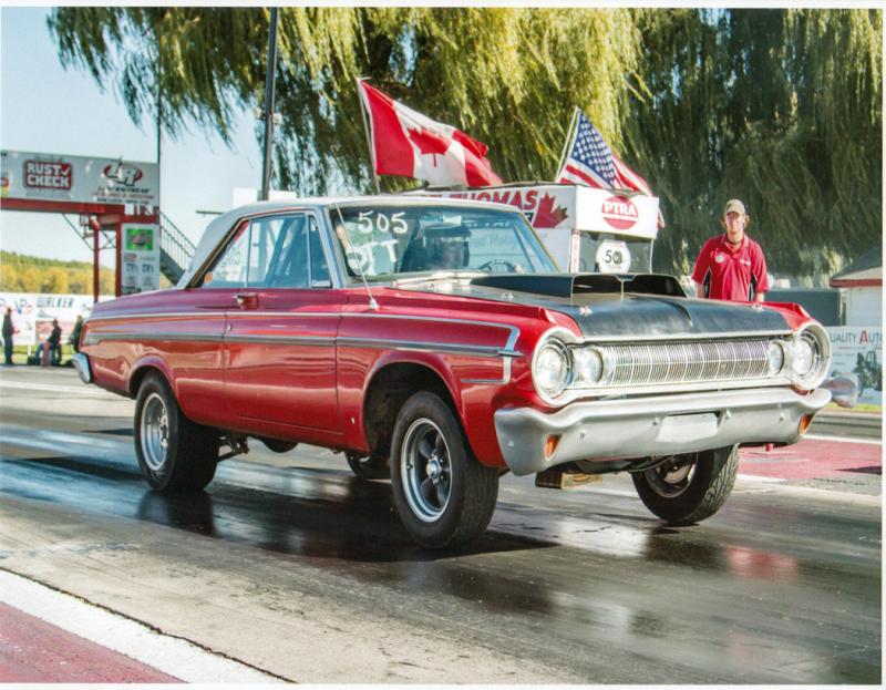

Nothing wrong with a "505"..that's what mine is and I'll give a few details to help out
Eagle stroker kit, 7.1" rods, Mahle pistons. 10.7 CR
iNDY EZ heads, max wedge ported be Modern Cylinder head, Manley valves, comp springs and roller rockers
Comp custom solid roller with .630 lift, duration at .050 253/262
Super Victor intake, with Quickfuel 1050 cfm 4500 series.
TTI 2" headers, 3" exhaust to the back
727 with forward pattern, low band apply manual Cheetah valve body, 4000 stall convertor
.373 gears, 8 3/4 diff with Detroit Locker, Strange axles, 28.1" W series M/T slicks
Car is a 64 Polara with 4 wheel disc brakes, Hotchkiss upper A arms , roll bar, frame connectors, SS springs, Caltrac bars, weighs 3650 with me in it
Best to date.....10.55 at 128 mph
Car is plated, insured, street legal, street driveable and gets rotten fuel mileage...LOL
Hope this may help...If you have questions, let me know
John B.

Splicer, Thanks for the info on your car. It looks like a great car with really sweet performance.

John you have a nice build and a good running car ! My 493 is close to your 505 but I use a flat tappet cam (.585 & .592 lift and I use 1.6 rockers) and I run the Indy dual plane intake with an 850 DP carb. Alot of the rest of my build is close to yours as I run the basic EZ heads that flowed 329 @ .600 on the intakes. I use dished pistons for 10.6 comp and it has good quench to run fine on 92 pump. I have 2" TTI headers and 3" TTI exh out to the back bumper. Its a 727 with a Dynamic conveter and Turbo Action reverse manual valve body that drives good on the street and flashes about 4200 at the track. It has 4.30's with the Hoosier 30 x 9 radial slicks. Rear suspension is SS springs and the long MP shocks. I also use a Detroit Locker in the 8-3/4 rear. I also have a 6 point rollbar and frame connectors. I race it as I drive it through the pipes on 92 pump. My best when driving the 45 miles to the track has been 10.76 @ 124.79. It weighs just over 3700 lbs and its all steel but I do have a glass hood. I really want to try a nice single plane and more carb like a 1050 Dominator one day but the driveability is really nice with the dual plane intake and 850 DP.
Nice to know we think alot alike on our builds and yours is a real good looking Mopar that runs great ! Ron
