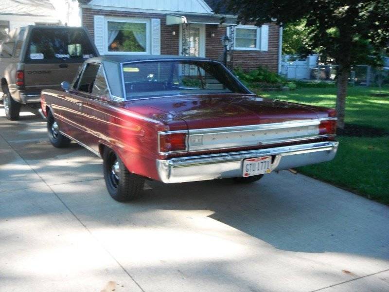

It's been two years this coming month since I started replacing the torsion bar anchor and redid the brake lines. She had a tired three eighteen, so I replaced it with 440. Dealing with a dishonest machine shop, whose ad claimed they knew MOPARs. I trusted them, big mistake, they carelessly misaligned the oil passage holes on the number four cam journal. Something I didn't see until months later when I was able to get back working on the car. I with information from a member here invested in a cam-bearing installation tool. The first attempt didn't go too well as one bearing cocked so much that the cam wouldn't go into that particular one. Bought a second set and the cam went in but turned hard. With some croakis coth and a short three-quarter wood dowel. I was able to gain better clearance by sanding each bearing while in the block with a circular motion. Rebuilt the trans before it's installed. One of the most time-consuming things was cleaning, sandblasting, and repainting parts I took off.
Currently, I have been reinstalling the interior, and refinished the glove box door and cluster surround in satin black.
I'm pretty much alone on the project, waiting for a friend who lives an hour away, to get the time to help install the engine and trans.
She's not perfect, but after all this, I have a car that I could afford, just not the B-body I really wanted but was out of reach.
Looking forward to the Woodward Dream Cruise this summer.

It's one of those "Twenty footers". Looks good till you get up close. It's just a cruiser, happy to just have one.
Nothing wrong with a "Twenty footer" at all. In fact I purposely chose to have a car like that, and everytime I'm out driving it, or in the garage working on it, I'm glad I made that choice.
