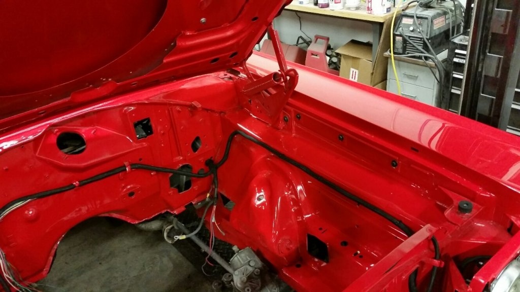

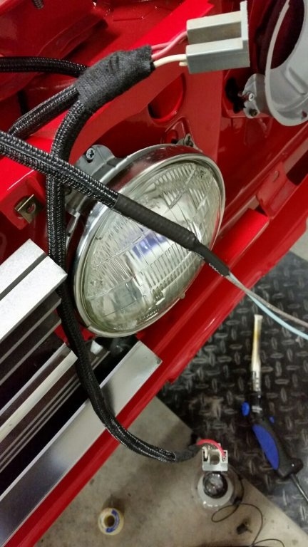

Some pictures of the wiring, the car has a painless kit, techflex loom, tesa cloth harness wrap and standard heat-shrink.
20160831_211119_1472693123616_resized.jpg 20160831_200039_1472693122032_resized.jpg
