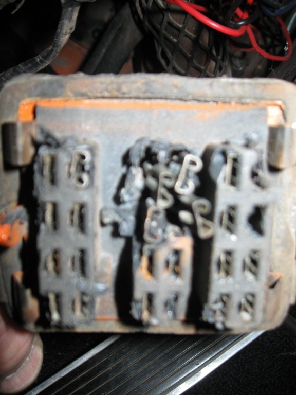

Great info, my Roadrunner did almost the same thing, lost all electrical power. I took the bulkhead connector apart and it was full of corrosion too. The other problem was, it had over heated over the years and had a melt-down. Now I have to replace the firewall part {when I can find one} then transfer 24 wires to the new one. Thanks for sharing this great info. Mr Budnicks
