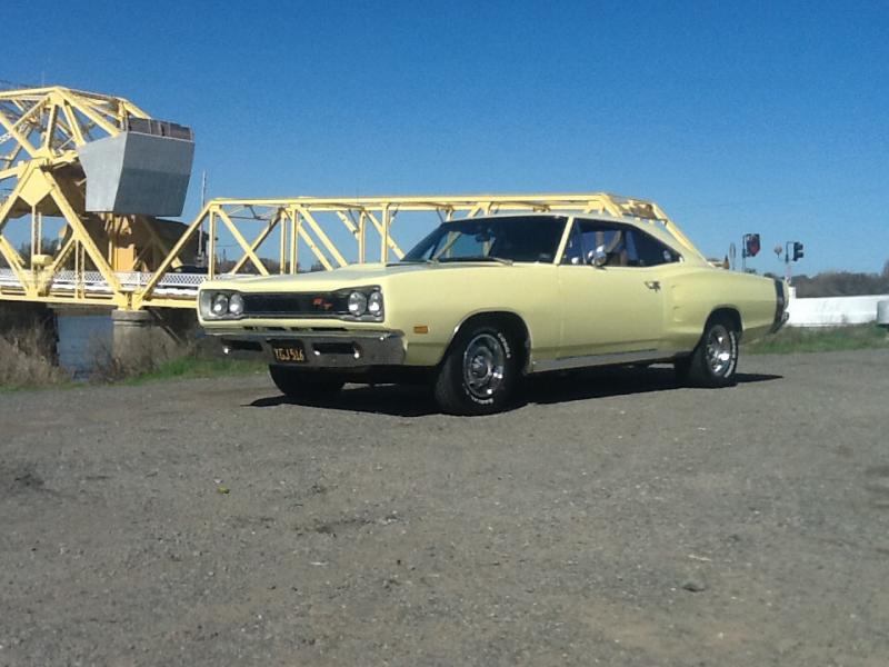

Y2! image.jpg All the best in your journey. Maybe the first born OF the first born will be required too.

Y2! View attachment 294904 All the best in your journey. Maybe the first born OF the first born will be required too.
dennis i would not doubt that one bit!!!! very nice r/t by the way.
