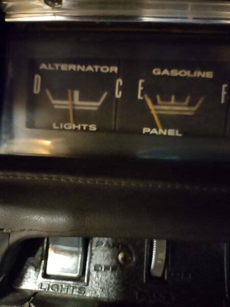

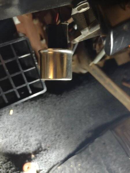

Ok I check some things. Found this under the dash and unplugged it and plugged it back in. Now the car turns over and has lights but won't start. When turning over the ammeter is on the D side but I guess that's normal til it starts.

You've got a loose connection under the dash. Maybe at your ignition switch. Start the wiggle test on the harness as you try to crank.
