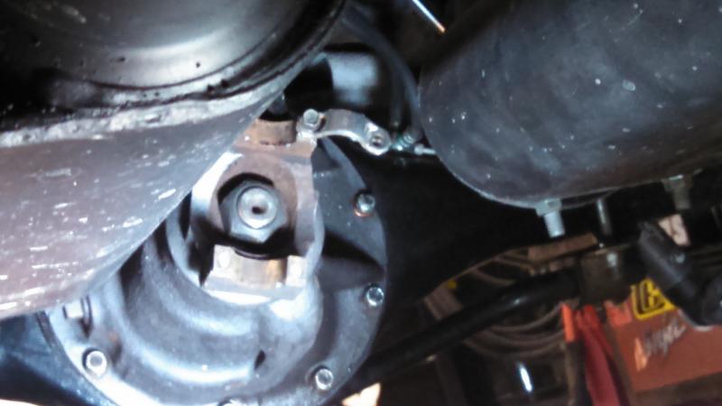

RUT RO RAGGY....look what my hemi did. bad hemi. i used the stock retainer clips are these way to weak or is it that i have to lower my rearend bump stop lower to limit some of the twist. i have never broken a driveshaft before. im thinking some of you guys might have some solutions for me. im already looking for some heavy duty retainers. I NEED SOME FER RACIN PARTS...lmao

Wow! I wouldn't think the straps would need to be really strong as long as they are holding the universal in the pockets? I think I'd look elsewhere for the problem, bad yoke (loose fit), possible striped threads, maybe over tightened bolts, or binding like you said?? I think somebody has been having to much fun.
How about a bolt through strap kit .. this is chevy but same premise
Brewers .. http://www.brewersperformance.com/proddetail.asp?prod=UJUB1330&cat=121

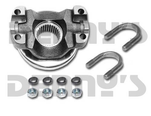

That's what I've done in the past. Seems like mine was a Spicer. U bolts are much stronger. I wonder if there is enough metal and room to just drill the stock yoke holes out to fit the U-bolts?

Wow! Bad Hemi...LOL. I'd recommend upgrading to a 1350 series joint. In the end, after a new pinion yoke at the diff, new forward yoke, driveshaft and U-Joints, you'd probably spend 5-6 hundred bucks, and most likely never have to worry about that issue again. Here's where I upgraded my bird from:

He could also just replace the yolk for now and run a conversion joint if he didn't want to spend the money on the shaft quite yet. Realistically he will probably have no problems with a small joint as long as he replaced the yolk with something with the u bolt style. I am running the small 7260 joint right now with no issues but I also don't have the 6.1....only the 5.7 :p

only upates GOON, i gotta get my tank sent out, getting a new yolk new u-bolt design retainers new u-joint an getting driveshaft rebalanced and the SCOWL will be back in action for the spring. the HEMI and the 6 speed are freaking awesome. people were amazed to see this thing crusing at 75mph on the inter-state.
