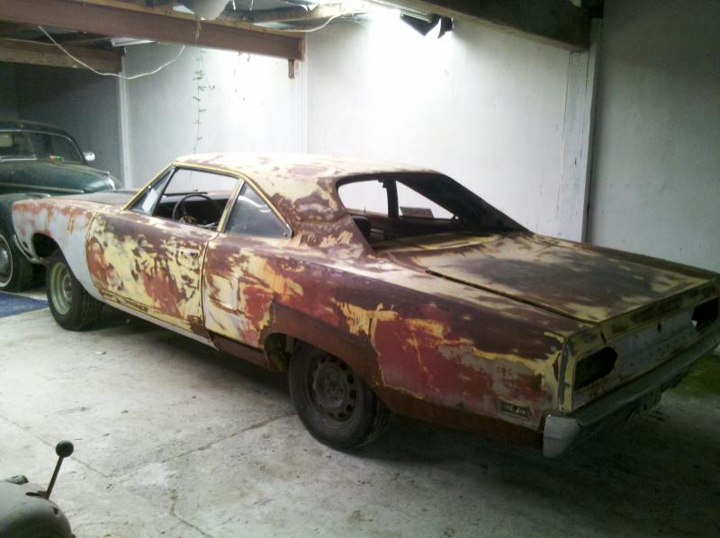

I have been working on my Viper powered Roadrunner for the last 2 years and thought it as about time to post up some photos of what I have been up to.
The car certainly didn't look pretty when I bought it but knew it could be brought back to a good body. The floor pan and chassis rails were rust free. It had the usual issues in the trunk , quarters etc.

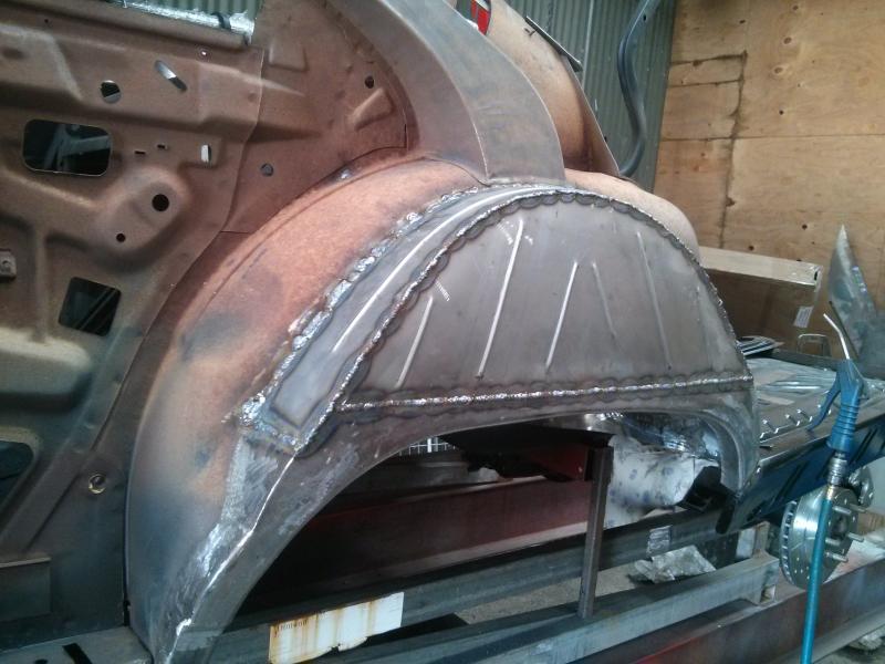

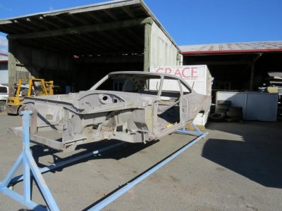

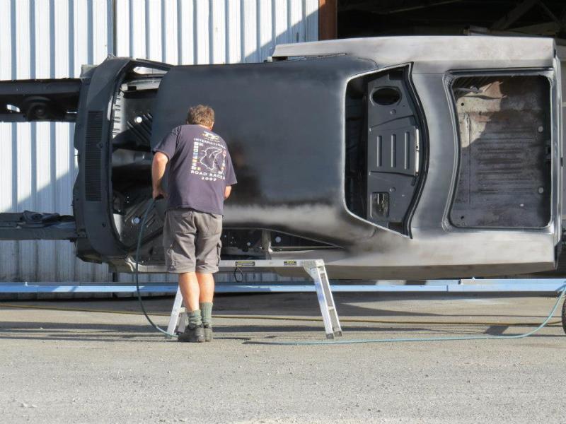

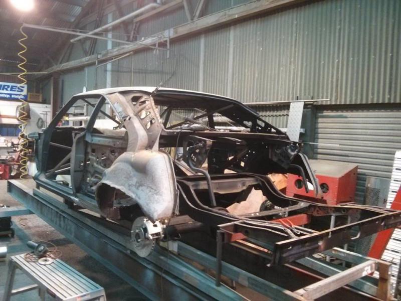

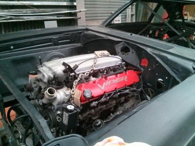

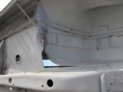

As seen in the last pics, I had shell media blasted and then gave it a coat of etch primer before tearing into body work. Early on I decided to renew both quarters and fit a one piece trunk floor with new extensions also. The roof had some rust damage above drip rails at rear pillars. I wasn't going to replace roof but the bloke who did the blasting managed to warp the skin. I have tidied up the mess that someone made doing mini tubs previously and modified the outer wheel housings. I have modified the rear of the chassis rails to get hanger pivots higher up. The car has a spring relocation kit fitted when the mini tubs were initially done. Engine is a Gen3 8.3 out of a Quad Cab Ram, as I wanted an auto trans. I have retained the 489 differential and have added disc brakes. I picked up a good used cone type LSD for it and will run with the 3.23 gears at this stage. I am sure I will change the ratio later on, probably a 3.9 would suit it better.

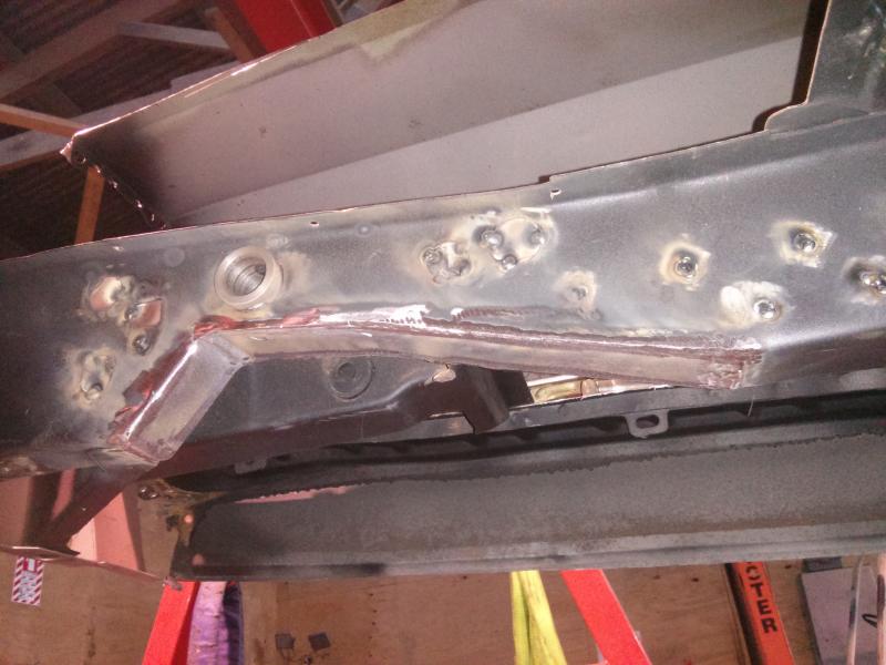

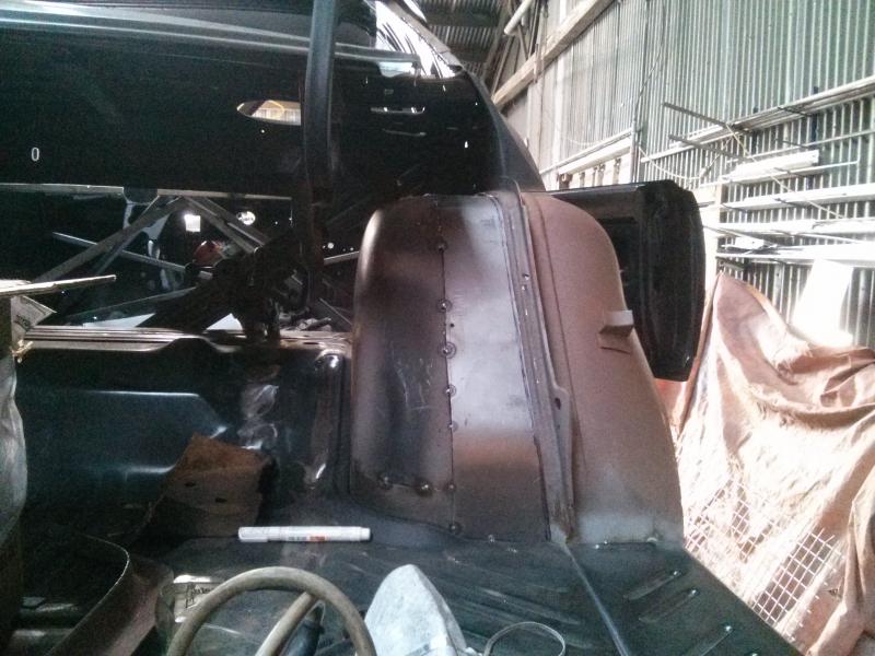

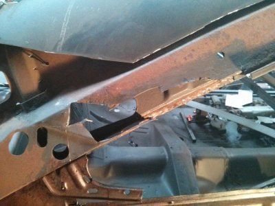

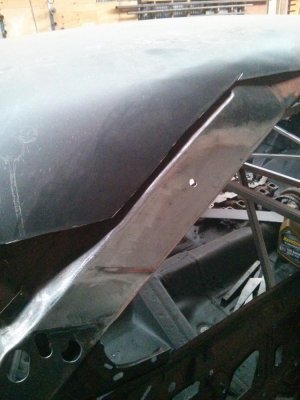

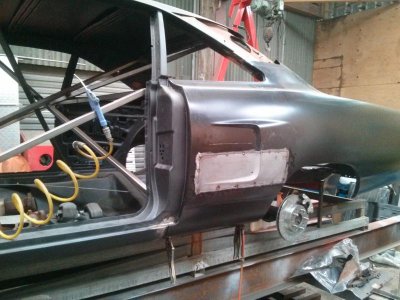

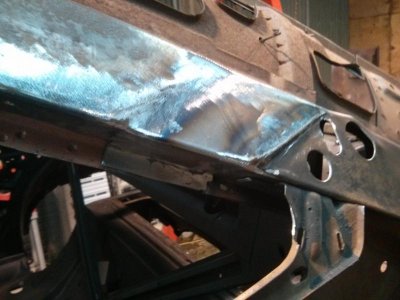

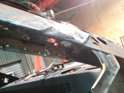

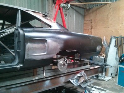

Some more pics of the rust I found in rear pillars under roof skin. Obviously had some very average repairs done at some stage in the last 45 years in this area. I have increased the size of the side scoops in the quarter panels. I used the lower sections off my original quarters and butt welded them in. I plan the make a mold of original scoop trims and then extend the mold and manufacture new trims with carbon fiber. So far I have replaced both quarters, deck filler panel. trunk floor and extensions, r/h rocker, r/h door, roof skin and hood with new AMD panels. The AMD panels are good but I did find I had to make a lot of adjustments to get them fitting nice2013-09-29 14.47.40.jpg2013-09-29 17.49.13.jpg[/ATTACH]2013-10-13 11.31.32.jpg2013-11-02 11.11.17.jpg2013-11-03 16.18.04.jpg

Wow, great looking work so far and bad@ss choice of drivetrain! All I could afford to Viperize my Charger were a pair of gen 3 bucket seats lol! Very cool modification to the side "scoops," too. Looking forward to seeing more progress
Love the enlarged scoops, looks right!

I did make up a test loom to run engine when I got it. It started and ran for a few seconds then would cutout... security key signal not present. I sent computer to Arrington Performance and had security function removed and a re-flash done to give it a little more grunt. I haven't attempted to run it again yet.

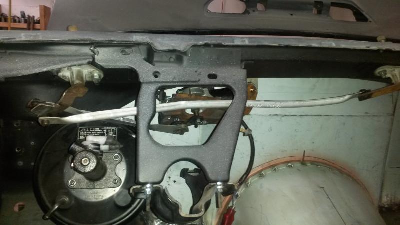

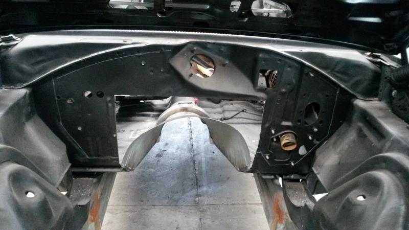

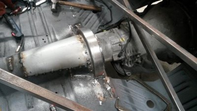

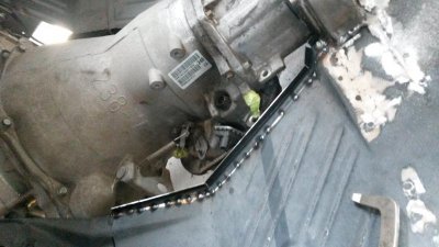

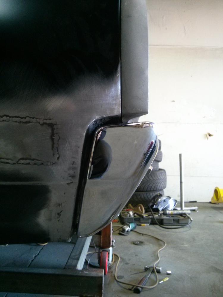

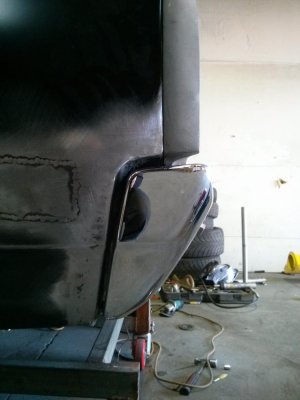

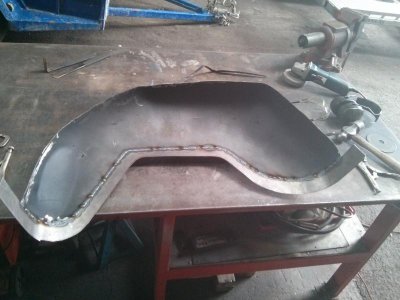

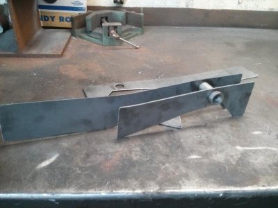

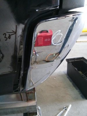

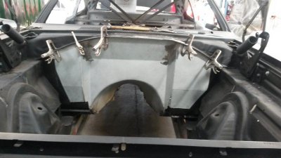

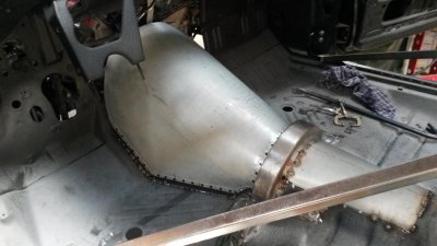

Did a huge amount of test fitting and fixing gaps on quarters. The gaps when rear bumper was fitted was terrible so cut open and welded in filler pieces. It looks a little rough but pics were taken before I had finished working repair. I have made a new trans tunnel and joined torsion bar crossmember with new center section. I made a new firewall section to smooth it out and have relocated wiper motor and brake booster under the dash. I used a wiper motor and brake booster assy from a Toyota Hiace van and made new mounting brackets.
