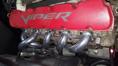

Thanks, yep have got the headers and x-pipe back from coating. Ceramic coating and a polished alloy look. More pics to come soon.

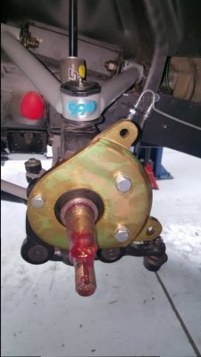

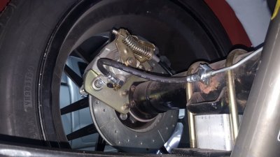

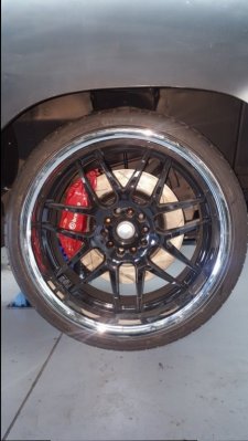

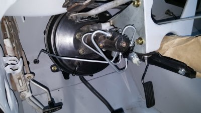

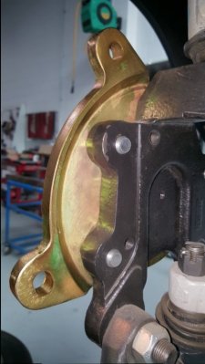

some pics of the brake set up. The fronts are 14" rotors with brembo 4 piston calipers off a Mitsubishi Evo X. The rears are a hotrod kit I bought off ebay, 11" rotors and Eldorado calipers. I had cables custom made to hook up with the original parking brake cable. The brake master cylinder and booster is mounted beside the steering column and came out of a Toyota Hiace commercial van. I have a wilwood combination proportioning valve mounted next to the master cylinder. The front brakes utilize drum brake hubs mounted on Magnum 2" drop spindles. To mount these I only had to machine out the back of the hub for a larger seal and use a different inner bearing to suit spindle. The caliper bracket was machined out of some 20mm steel plate, they are a bit chunkier than I would have liked but it will keep the modification certifiers happy. I still have to bleed hydraulics to finish them off completely. I snuck a pic of coated header sitting in place too.

Do you know what the calipers for the rears came off of? Been thinking about converting to rear disc myself.
They are the same as a Cadillac El Dorado around 1980 I think. They are okay and they were the right price, but if I was going to do it again I would pay a bit more and get the Wilwood ones with the internal brake shoes for the E-brake. They just look nicer through the large alloy wheel and the E-brake is a more efficient set-up

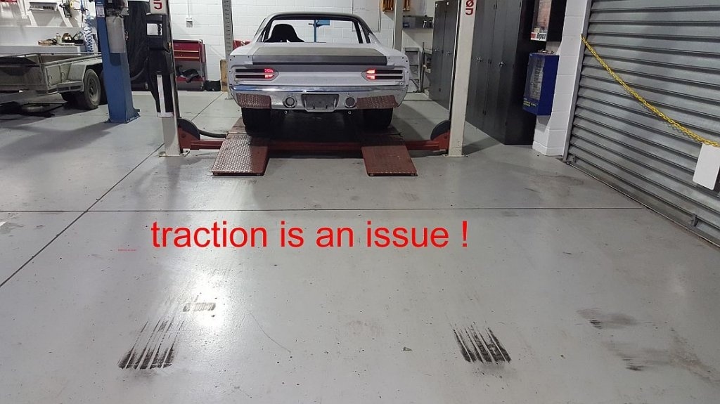

I have been steadily working on the car but there hasn't been many photo worthy moments. The most exciting part is the car runs and drives, although some adjustments are required. I feel I need to go to a 1" brake master cylinder to reduce the amount of pedal travel. Its not bad but not as good as I would like. he other issue I have is heavy power steering. it appears to be an issue with the box. The reaction springs are a lot thicker than the original box I had. I may have been supplied a rebuilt firm feel box, which will be beneficial when I have sorted it out.
