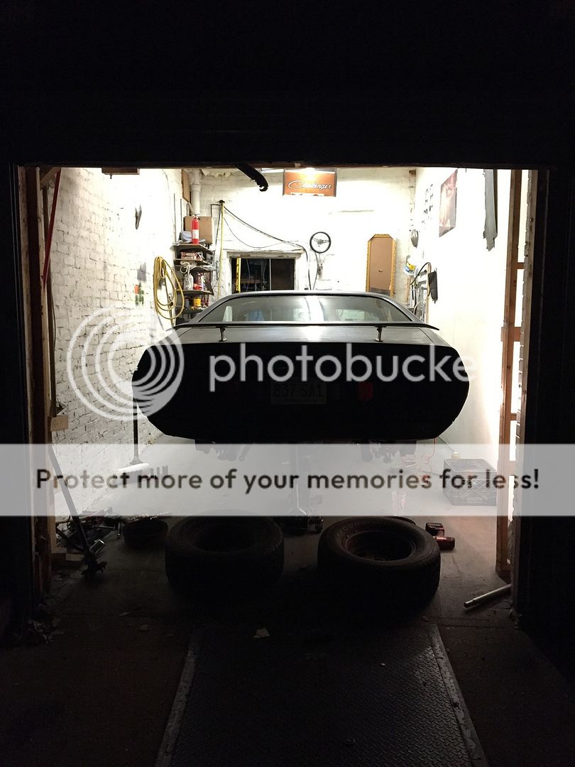

Sup DUDES. So, tonight I got a hair under my *** and decided to take apart my rear end on my 71 Charger. Been working on this car for a bout a year, rebuilt the engine and trans this winter. The previous owner had it as his drag racing toy, with street use, and it had been sitting for a while before i got to it.

So, tonight I jacked it up and went about yanking the axles.
The first thing that I discovered was that the previous owner had installed green bearings. Now, I've always heard that green bearings were a no-no for the street due to a lack of side-load capabilities. Furthermore, I had already went online and bought a set of new tapered Timken bearings, and accompanying seals, assuming I would go ahead and replace the bearings and seals while I was in there. So, I was kind of disappointed to see the green bearing set up. I also noted that on the passenger side, the seals were badly leaking diff oil into the brakes. Would it be easy to switch back to tapered bearings? Would it be worth it?
Anyway. With the axles out, pulling the center section was a cinch.
