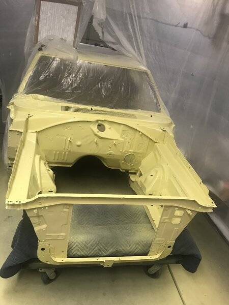

My Bee has color!!!
Nicely done! I think you'll be glad you repainted the engine compartment.
Car is looking great!
Thank you to everyone who replied. It’s been a long restoration. Feels good to have it in paint and having parts arrive to start reassembly.
Tad

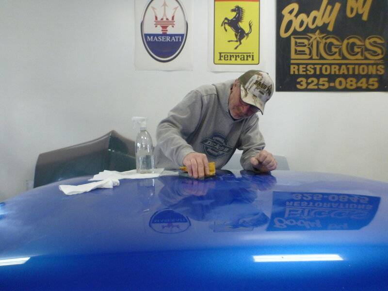

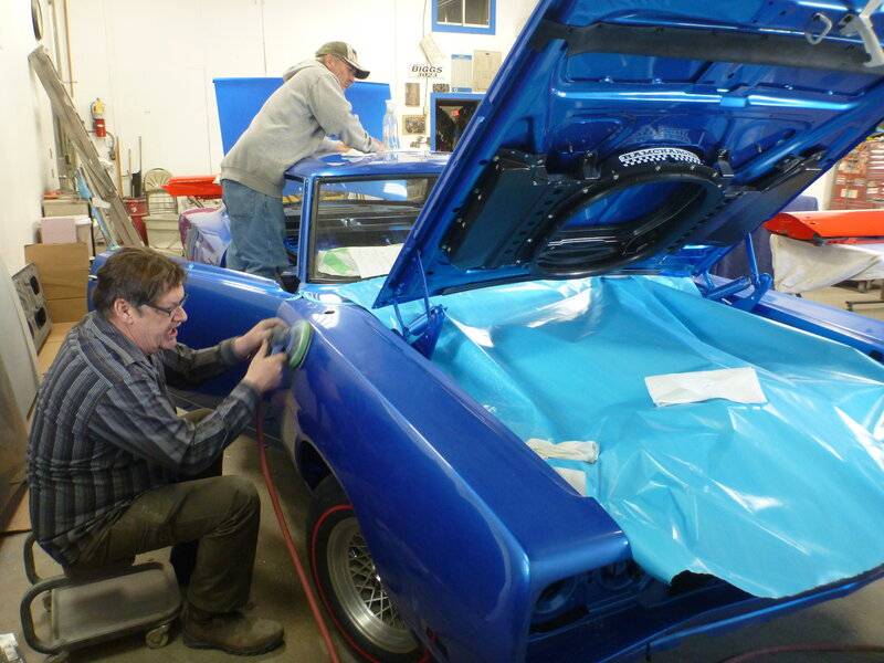

As noted here in my restoration thread. I had my car mostly together, still driving it on a milk crate for a seat, when I took it back to the painter for cut and polish a FULL year after paint. How he likes it, clear nice and hard to do his magic.
