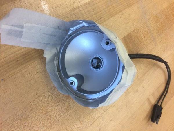

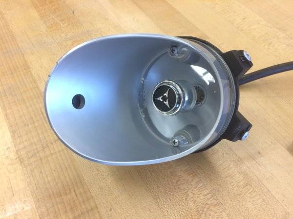

Still have not had the time to put in much work the charger but I have picked, here and there, on some little things. I cleaned and brightened up the front running lights and installed new lenses.

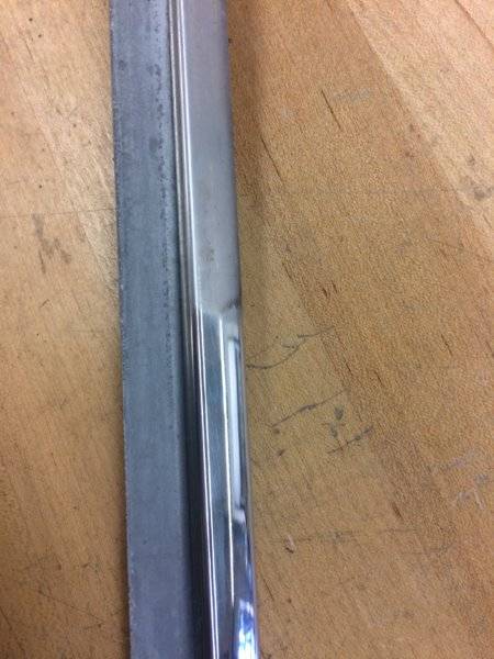

I have still been spending time behind the buffer. Re-polishing all of the chrome has taken a lot of time but the chrome is looking good.

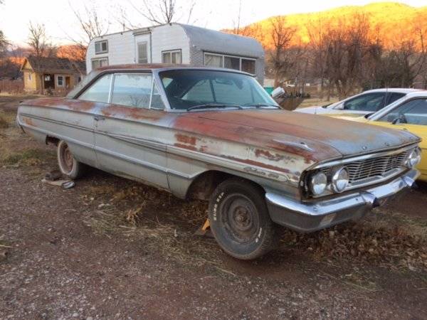

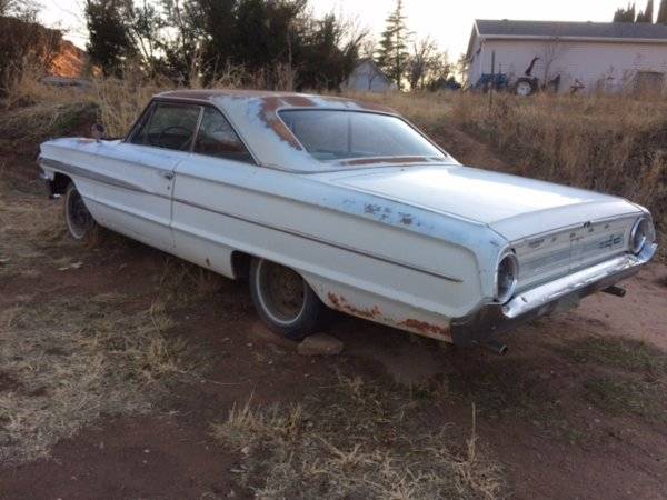

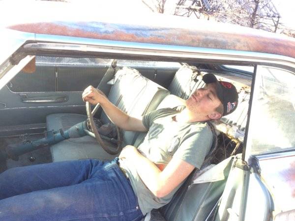

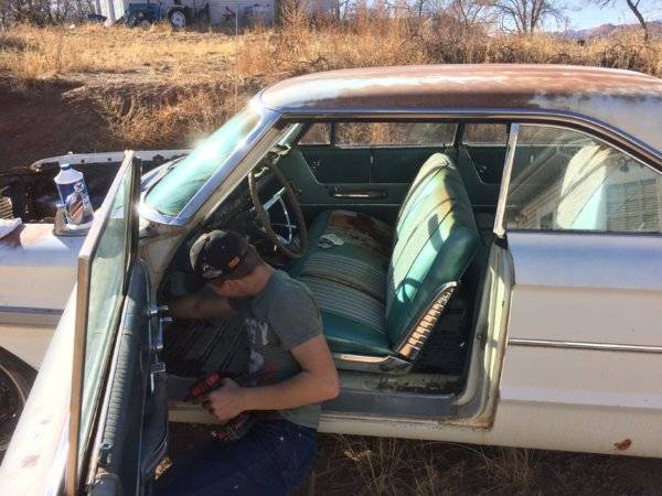

I did help my son on his project (64 Galaxie)
I think I wore him our. "Dreaming of future drives."

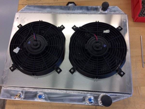

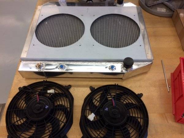

Do you think the mounting sheet for fans could be to restrictive? Looks like it may block to much air flow to me.
When I put my electric fan shroud on my radiator many of us noticed how close the shroud and fans were to the radiator and wondered if it would allow enough air flow. I was concerned and wanted to find out if I was doing it right. I looked at the Performance Cooling installation videos and other Performance Cooling customer projects and they were all close and closed like mine. I sent some pictures to them and asked for their advice. They were good to reply fast. Here is their reply:
"Sherman,
You're doing everything right and I know it looks close but it supposed to be like that. I will do my best and try to explain.
We did some wind tunnel research and tests on are original shroud that was 1.25" spacing to see if needed louvers as we used to have those on them too. Results showed that the air flowed through the core and as it came out it was sucked out by the fans. So we eliminated the louvers for better suction from behind shroud. After that we did another test and found air flow was disturbed and didn't go immediately through fans. So we changed the gap to 75" and what happened there is instead of allowing the air to build up behind shroud with the shroud closure it creates more pressure and accelerates the air flow and actually causes air to speed up and right out through fans.
Hopefully that makes sense
Tony Martin
Performance Cooling"
It sounds like they did their testing and seems to work the way they have set it up.

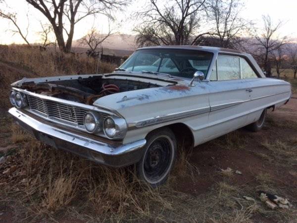

The Ford has a 390 with a C-6 tranny. They are ready to drop back in as soon as we get a couple things ready for it.
I always liked the 64 Galaxie. It is the first car I learned to drive. It had a 390 with 3 on the tree and overdrive. It is still in my dad's yard waiting to be resurrected some day.

We need more Galaxie pics!
63-64 galaxies are one of my favorites! Thats a great looking project for your son. Its nice to see someone so young into these cars.

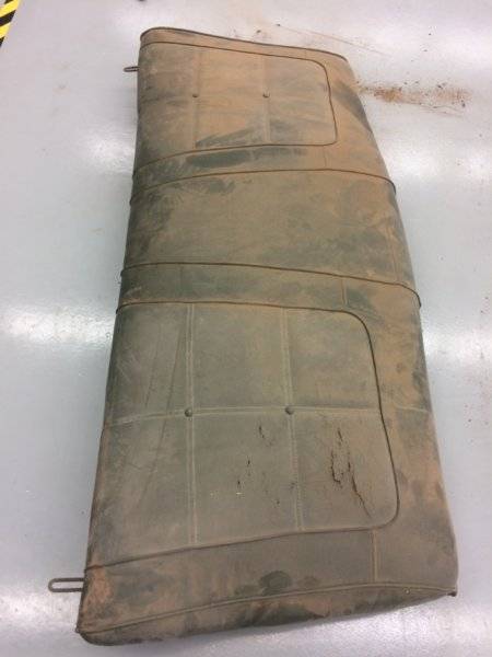

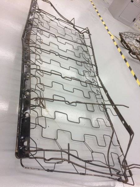

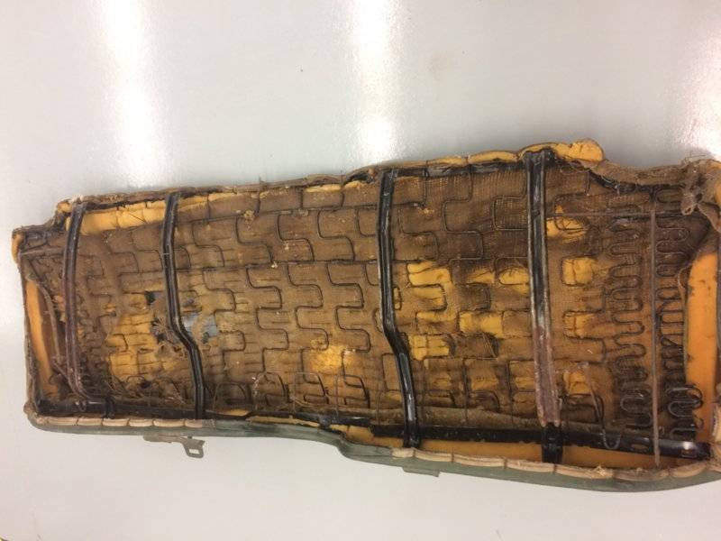

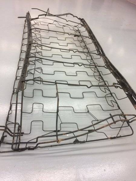

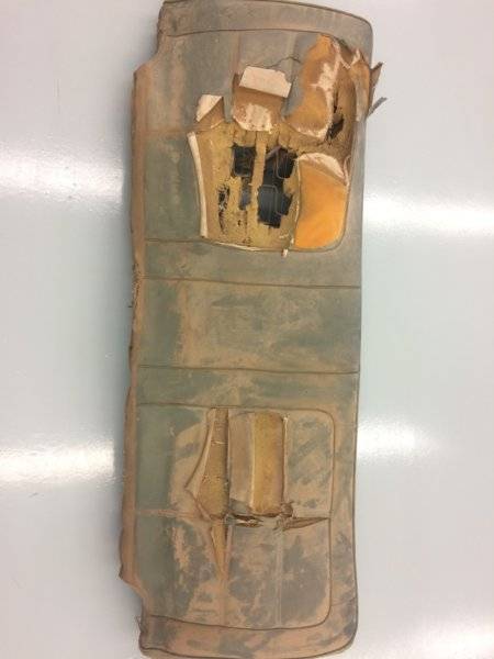

I got the rear seats out of storage and started getting the frames cleaned and ready for the new material.
As you can see, sometime in my car's life, the 68 seats got traded out for 69 seats.

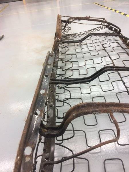

These seat frames were thrashed. It looks like they were just ripped out of the car without un-clipping them. The back rest is bent almost in half and the bottom seat is also bent up.
No build sheet!
A little tweaked but decent shape otherwise. I had to do some spot welding on the frame of mine. Otherwise looking good!
