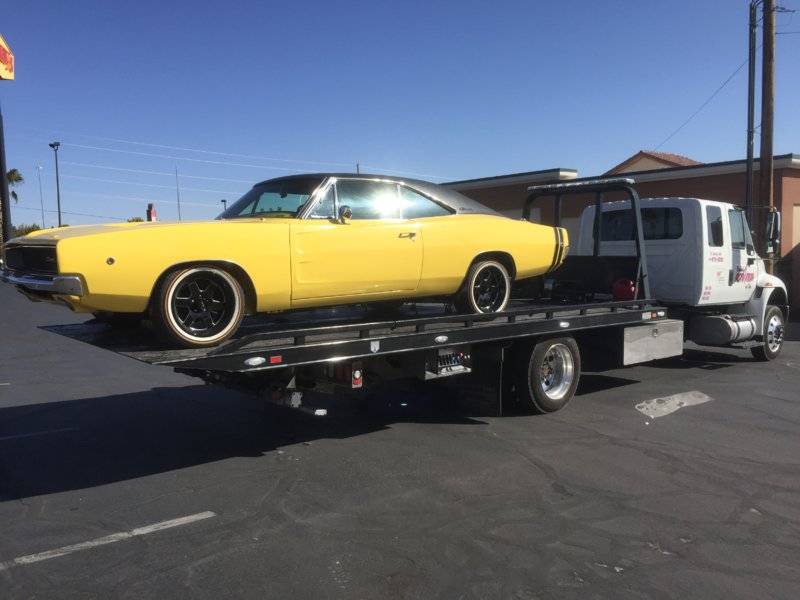

Still trying to fine tune things. I still hadn’t figured how to get my transmission to kick down so I decided to drive it to town and have the transmission shop check it over and make the settings and adjustments needed. Just as I was pulling off the interstate it coughed sputtered and died. I coasted off and could not get it started. I thought maybe my distributor slipped setting but could not get it to run. I had to get it towed to the shop. It was hard to see her on the tow truck.
They found out that the pickup coil went bad in my distributor. They also got my transmission kick down to work correctly. She now seems to be running and working well.
bummer but glad they helped get things sorted

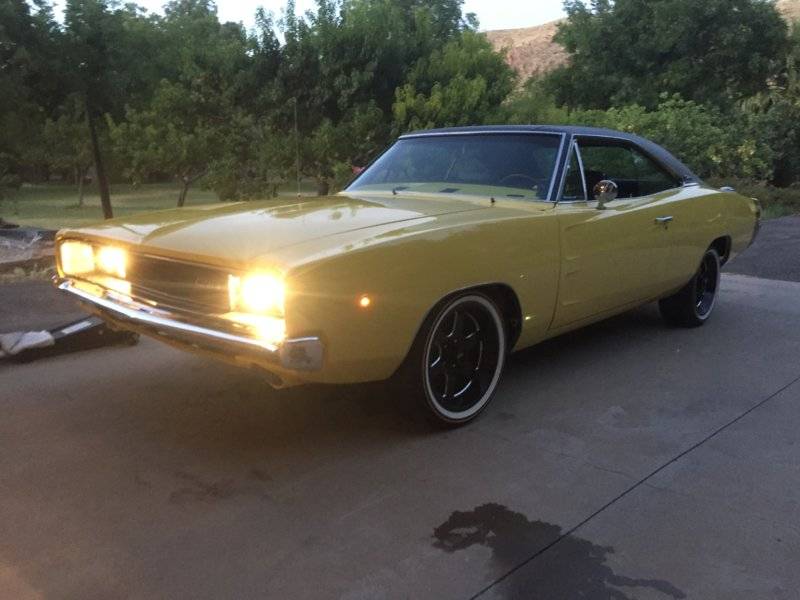

I've been working on my front running lights/turn signals and was thinking that they should to be on with the headlights. I've seen pics of chargers with them on and off with headlights on. So I remembered this pic of yours and I see that they're not on. Mine only come on in the mid position of the switch. I'm guessing that is how they're supposed to work?, maybe just on 68s..
I thought that I did something wrong. I also wanted them to be on with the headlights. Mine also come on in the mid position running light switch so maybe that is how it was for the 68's.
My '69 is like that too. I swear it was different before the restoration where they were on with the headlights but maybe i am suffering from CRS... ;-)
