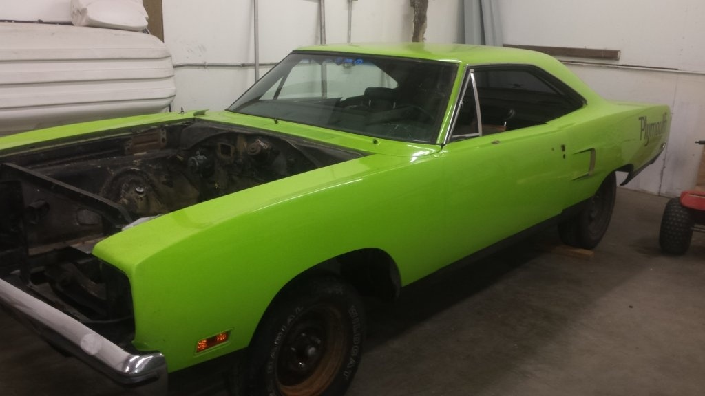

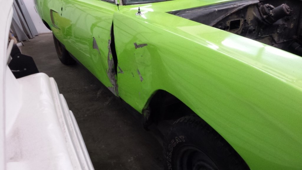

Hey Guys,
Hopefully I can can get some feedback on my 1970 Plymouth Satellite. Can anyone provide some advice on repairing or replacing the door and fender (see pics). I've been searching for awhile and haven't had any luck in my local area with finding a replacement door and fender. So I'm thinking that it may be best to find someone to repair this locally. In your opinion...Can this be repaired easier than replacing or would you replace rather than hassle with the repair?

You need to replace both the door and fender. It must be a '70 Roadrunner/GTX/Satellite/Belvedere fender. The door can come off of any '69-'70 B-body I believe. The '68 doors will fit, but the door lock/unlock knob is in a different location (relatively easy to switch over). I've got a '68 Coronet door on my '70 Roadrunner.
