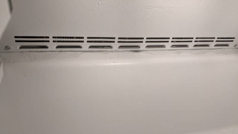

maytag french door/bottom freezer configuration fridge that has started to leak water into the freezer from some vents at the back. I've disconnected the water so it's not that. Must be the evaporation system's condensation? Every couple days it is creating a frozen pond I have to break up and remove before it starts leaking through the seal. Any ideas as to whether it can be fixed? Availability of replacement fridges that fit our space is very difficult, I'm not finding anything in stock

well, I tore the back apart, the drain tube assembly seemed all fine...and dry. The little 'lip grommet' thing had some gunk on it but nothing I would think would keep it from flowing. It also seemed to have larger 'lips' like replacement ones I saw on youtube. I chipped all the ice out from the back of the inside and watched a video for how to take that all apart and defrost. I'm guessing that's what I'll end up needing to do.
I spent 90min 'inside' the freezer thurs night. The drain trough under the condenser was iced up to the condenser and the drain funnel was solid ice. Took quite awhile to break up and fish out all that and then the hairdryer on the funnel. Working correctly since then, hopefully we don't get iced up again. I did find a youtube video of a guy taking our exact model apart so that made it much easier to not be rammy and break things :thumbsup:
