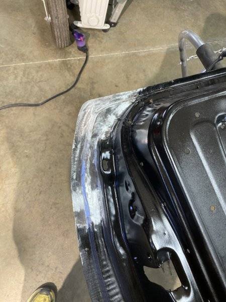

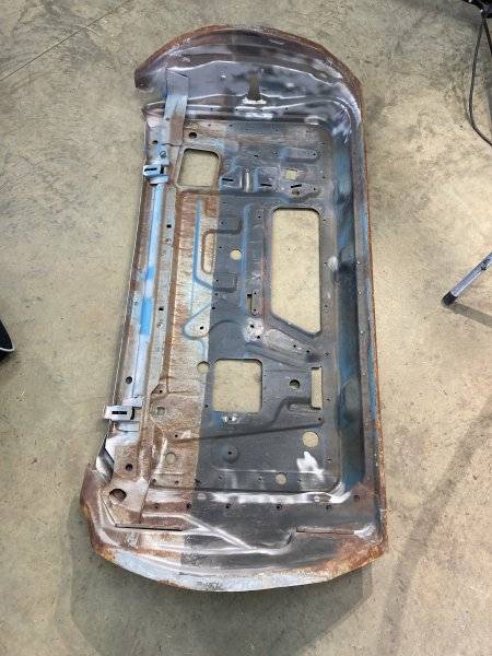

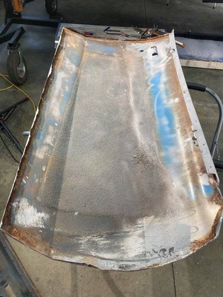

I got some more work done on the deck lid. I sanded the skin and treated the remaining rust. I then spayed 3 good coats of epoxy primer on the back side. I also spayed the lip of the frame that will be covered by the skin when it’s folded back over. I will spray the entire lid with SPI epoxy once it’s back together. I also cut the lock hole using a gasket as reference.
What I’m trying for:
Cut in:
Gasket:
Inside of skin coated:
Lip on frame coated:
I’m hoping to get the deck lid back together next weekend. We’ll see...

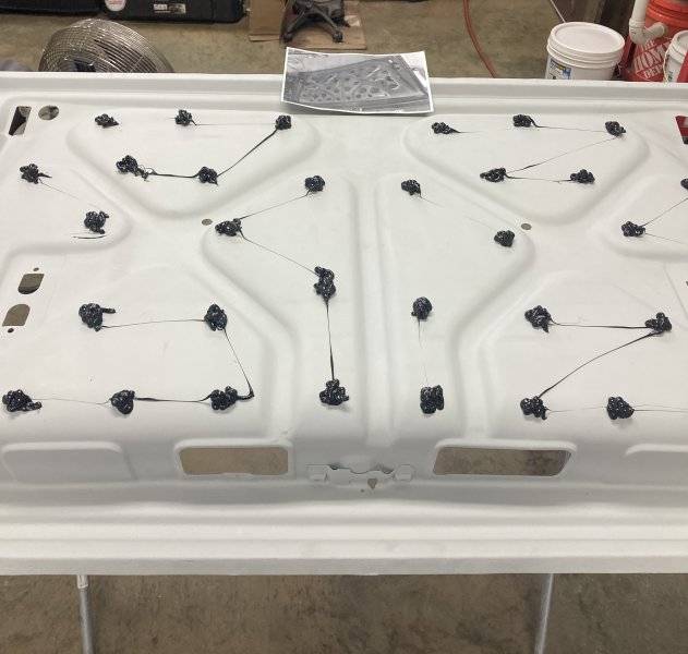

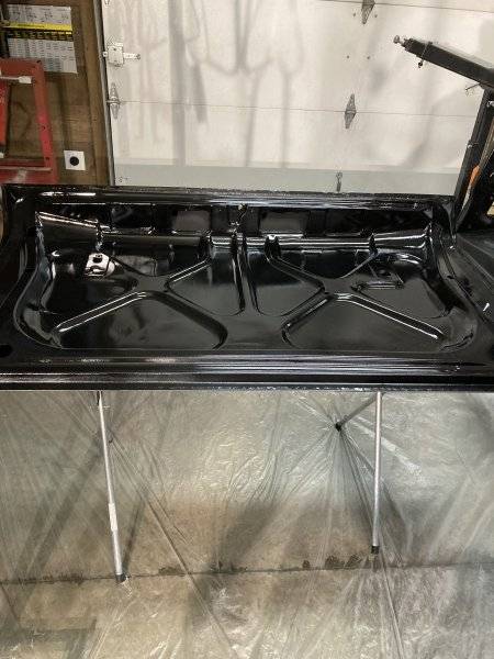

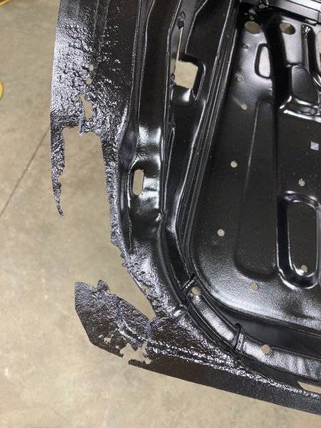

This weekend I got the trunk put back together. I used a photo I took when I first pulled it apart to get the factory locations for the globs of seam sealer before joining the two halves. I then bent the flange over slightly with a hammer and dolly and then broke out my new toy. It’s an Astro Pneumatic flange tool. Wicked easy to use and folded the flange over with zero issues. It was pretty fast too. I also had a few sections of the flange to weld back up because it split when I was removing it.
Seam Sealer:
Weighted down while sealer set:
Flange split a bit:
Welded up:
My new toy:

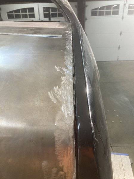

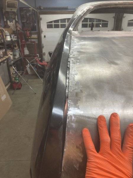

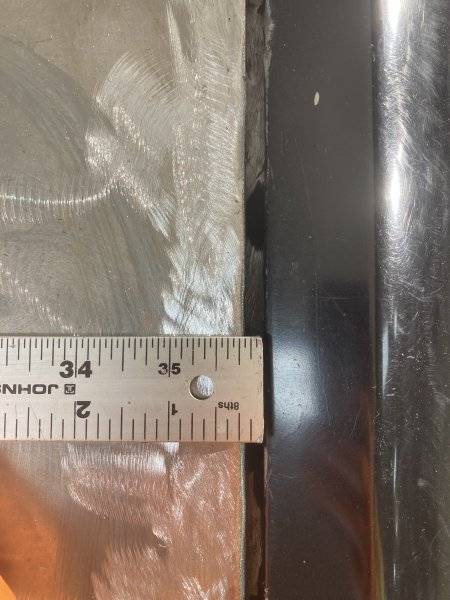

After getting the trunk lid back together, I mounted it back on the car. After installing the quarters, months ago, I could not get the gaps between the trunk lid sides and quarters any closer than about 5/16” on both sides. I literally messed around with it for days. I decided to weld a 1/8” tig rod to each side of the trunk lid to make up the difference.
About 5/16” gap:
Tig rod tacked on:
Roughed in, about 3/16” ish now:
Right side:
Left side:
I still need to fine tune both sides. I will also have to cut a slit at the bottom 3-4” of each quarter and weld up as they angle in too much. You can see it in the pic above, to the left of my orange glove.

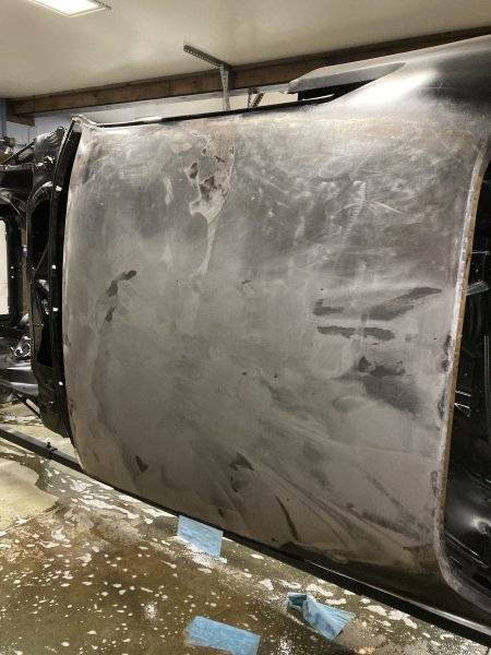

I took the week off and got some more work done on the car. I sanded off all of the surface rust from exposed areas and sprayed everything in epoxy primer. I took advantage of the balmy 43 degree day yesterday and washed the car down with Dawn dish soap. I then gave everything a good wipe down with wax and grease remover after drying it off.
SPI Epoxy:
Note to self, after completing a section/repair - cover with primer when done. It took forever to get everything sanded and prepped prior to spraying it.

Trunk lid came out great,that was the way to go,no surprises to come through the new paint later on.

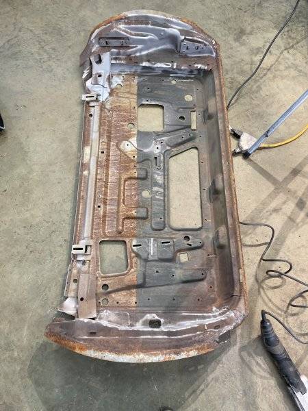

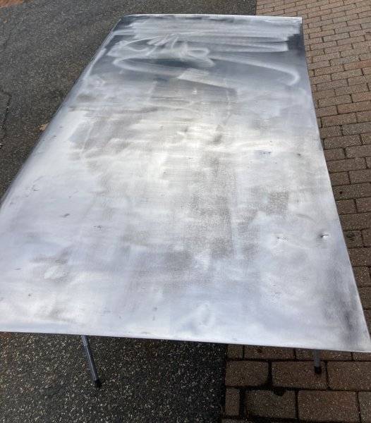

When I first bought this car, the roof did not have any paint or primer on it. It did have a crap ton of rust. I sanded the roof a bit with 80 grit and sprayed 3 coats of rattle can primer on it - that was about 10 years ago. Fast forward to now, I stripped the primer off and was immediately reminded of the nasty rust on the roof. I tried Ospho first but it didn’t really do anything. I decided to try a process that I saw Wray Schelin - Pro Shaper - do on his YouTube channel. Basically, he set up a tub underneath a ‘50 something Caddy filled with Rust911. He then pumped Rust911 through a series of sprinklers to treat all of the rust underneath the car. He also used a bunch of tarps to keep the spray contained. Borrowing this idea, I used a plastic bin, a sump pump I already had, a sprinkler, plastic and a crap load of clamps. I set this up Friday night and let it run for about 4 hours with 6 gallons of Rust911. The solution turned orange after about an hour an then black after 4 hours. When it turns black, it doesn’t work anymore. I did 3 more batches of 6 gallons for 4 hours on Saturday. The Rust911 removed almost all of the rust!! What was left, I was able to remove with a wire brush. I then then sanded it with 80 grit and primed it with epoxy. And, of course, I almost broke my neck while spraying. My feet got caught up between the oversized Tyvec suit I was wearing and the hose to my spray gun. I almost fell off the platform I was moving along and fat-fingered the spray gun and put a pretty good run on the roof. ****! I also started spraying primer on the trunk lid, I got the inside done. I also sprayed some of the parts to the trunk lid.
Rust!:
System set up, I didn’t end up using the bucket to put sprinkler on:
Spa treatment:
Doing its thing:
This is what I used:
The solution turns black when it’s used up:
The result:
Wire-wheeled and sanded:
Primered:
Trunk lid:
Happy New Year and thanks for looking!

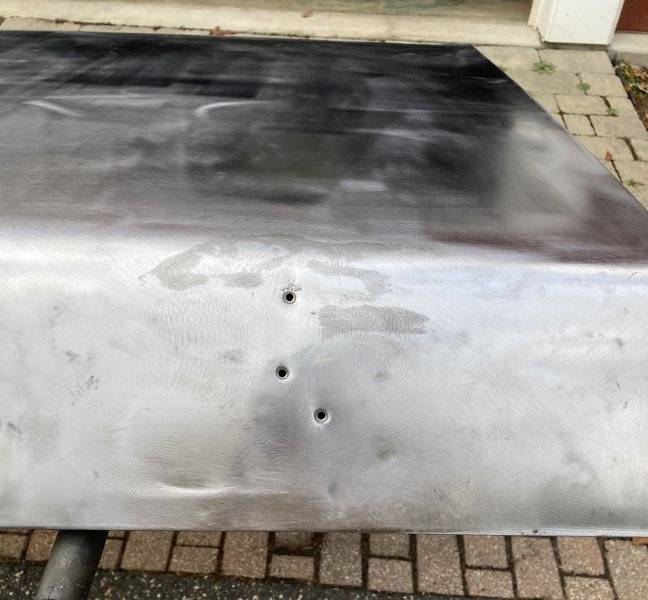

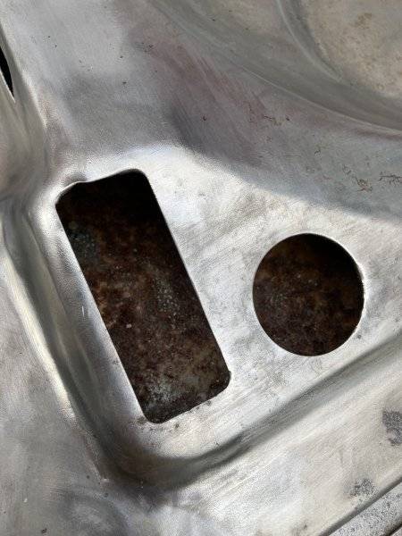

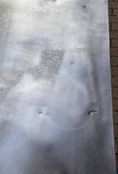

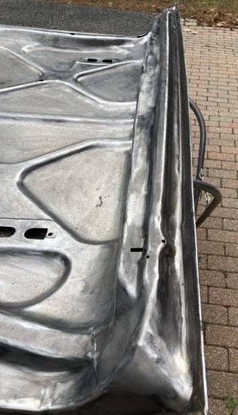

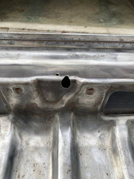

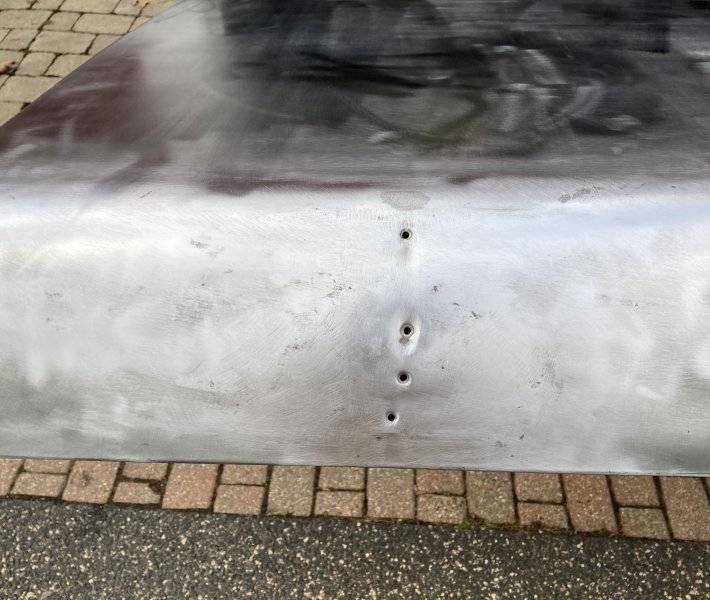

More..
No damage:
Small hole to fix:
Some small dents:
Holes, both sides:
Rust:
I’m really happy with this deck lid. Should be pretty straightforward to fix. Thanks again Brett!!
Hey you are welcome. Just saw this post. That’s a lot of work for sure. It’s always crazy wondering what is under 30-40 years of paint.. Funny thing that it was originally the color of your car.. It was nice meeting you and sorry to hear about the traffic on the way home been there done that. Glad I could help keep your car moving along over winter. Still hoping to empty my one storage one day so one deck lid, hood etc at a time!!

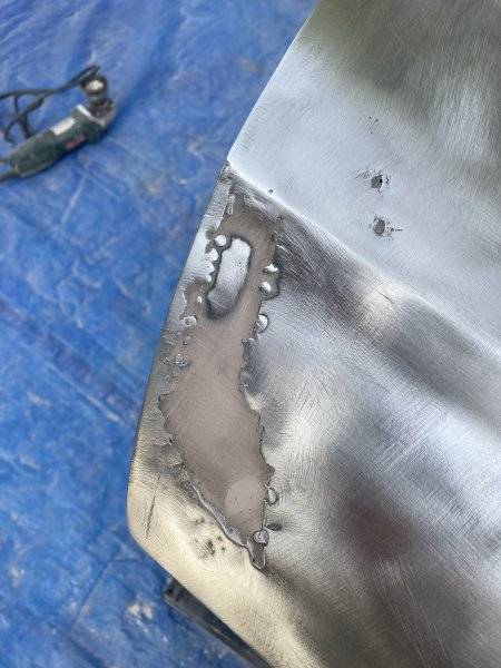

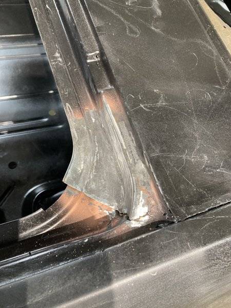

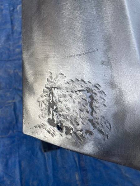

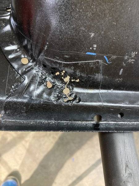

I’m still plugging away. Last weekend I decided to fix the top corner of the trunk gutter on the passenger’s side. When I removed the old primer from the deck filler and top of gutter, I blew through in a few areas on the gutter corner. I had to make a patch panel out of 4 separate pieces of metal. It was not the easiest thing in the world. That corner has a lot of angles and curves. It took me a bit to figure it out but I think the patch came out pretty good. After welding it in, I brushed on some epoxy primer for protection.
Holes:
Patch piece:
Welded in:
Epoxy:
No bad for me, I guess.

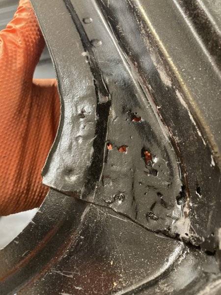

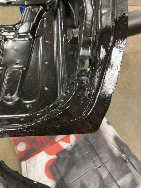

I started on the doors. First up, the frames. Both lower corners on the passenger’s door are toast so, I will need to replace them. The right bottom corner of the driver’s door is crap too. I started with the passenger’s door: It was beyond my skill to make the patch out of one piece, believe me, I tried. So, I made it out of two and welded them together. I did the same for the driver’s side corner, as well. After getting the corners fabed up and welded in, I covered everything with epoxy.
This corner was gone:
Patch:
Welded in:
Bottom:
other side:
Other door:
Epoxy:
I also had another small area to fix on the passenger’s door:
