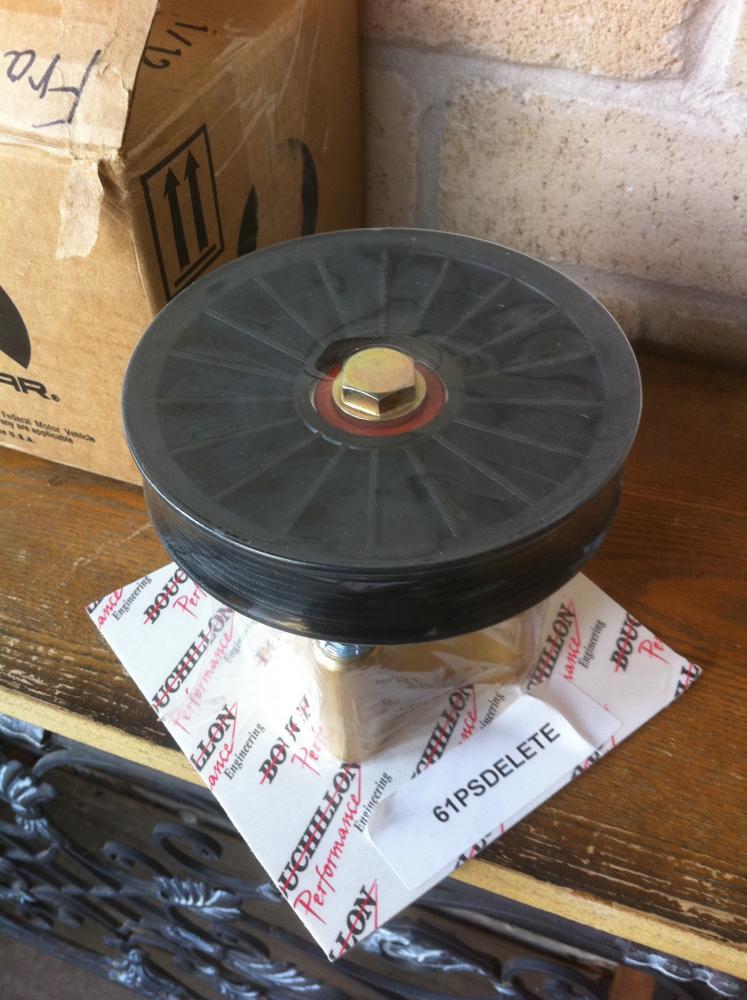

i have to pic up some small items such as the water pump and the a/c and power steering delete pullies. i think i am just going to run the bouchillion performance parts. they seem to be decent looking stuff.
other option is to make my own.

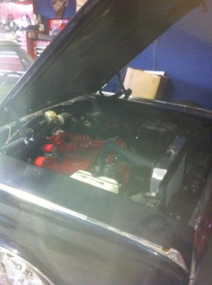

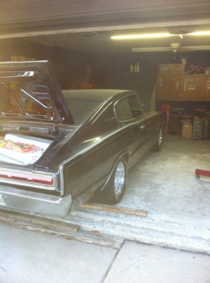

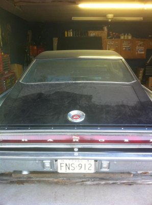

ok, today the work started.
i opened up the car hole and moved the car. first time this has happened in several years. the car was obviously covered in dust and cob webs.
that will soon change.
the 727 is removed and found a new home in a local ta challenger. 340 car that was stroked.
the 408 thats in my car currently is about two bolts shy of being pulled in this photo spread. its a stout 408 i built some years ago and will also find a new home in a second local to me challenger TA car.
tomorrow i will start laying out the hemi parts and do some mock ups.

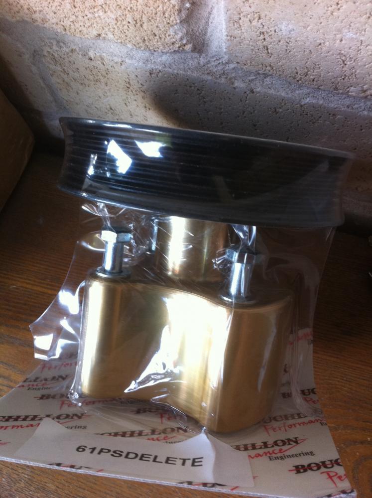

the guys at bouchillion performance are cool.
ordered up there power steering delete pully btw. should be here soon.

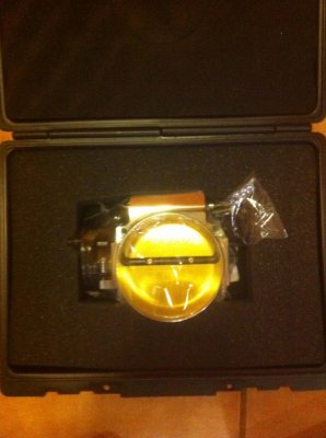

trying one more but these pics for some reason wont download.
and im not unpacking the boxes again tonight.

power steering and air conditioning? no way...this little gem keeps you from needing to run all that crap

You aren't going to run power steering or A/C? Seems everybody has to have that these days.
