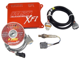

im not sure who i am going to use for the tune yet. i have some experience with it, just not with the fast xvi yet.
i was leanig towards a friend of mine up at arrington.
but i also know about fastman efi also. he is the guy who tuned on 340 ricks car..
im open for all options at this point.
