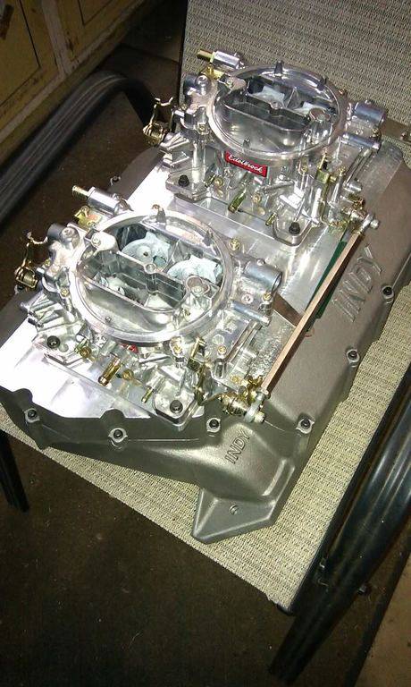

I am NSS legal now. Last year my A&A trans and this year the intake. Damn show makes me spend the money, just to many shiney things to buy. Who has the air bells for sale?

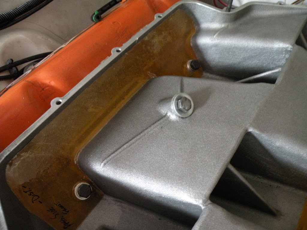

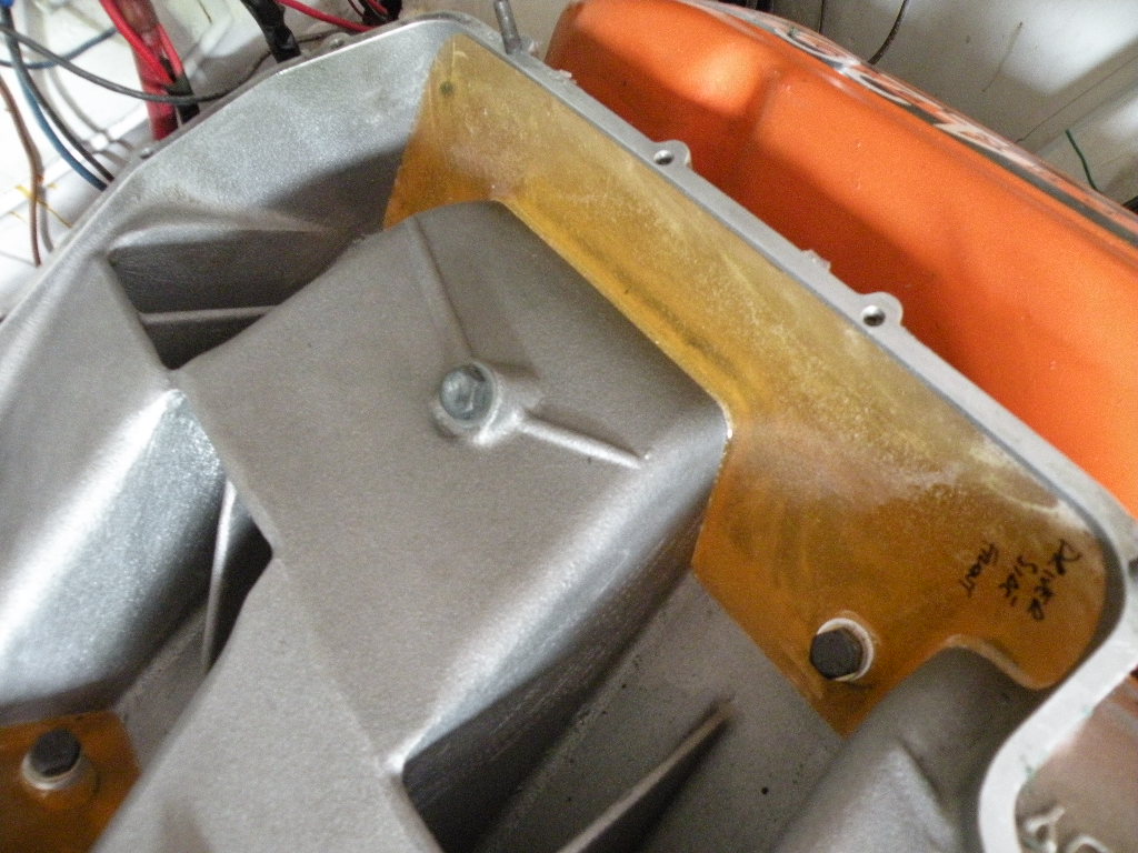

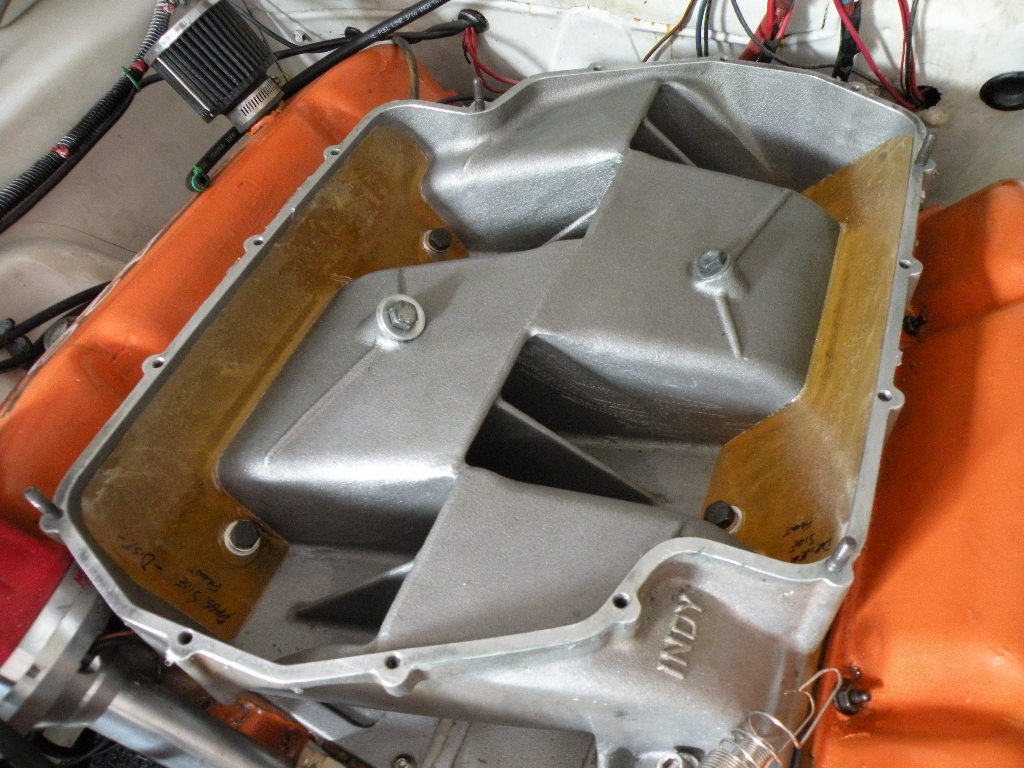

If you want to go .15-.2 faster I have these for sale. Intake stuffers from Indy. Easy bolt in a go faster.

SSR, I have seen those before. I just read an article in a Mopar Muscle Magazine. They Dynoed them with and without. It only netted them 1.5hp. You said you have them for sale but no price?

I went from 10.27 to 10.03 with them. My best was 9.96 they are in my 500 ci maxwedge savoy. i had them in my 588 but decided to just go w/o them in my new bullet right now but might try them during the season. that is if i dont get in the 8's

and about the stuffers, dont bother with them we did back to back testing with them at Norwalk two years ago and saw no improvements. waste of 125 bucks.
another guy bought a set at the same time and he said they might have pick up a couple hundredths and 1 mph...
