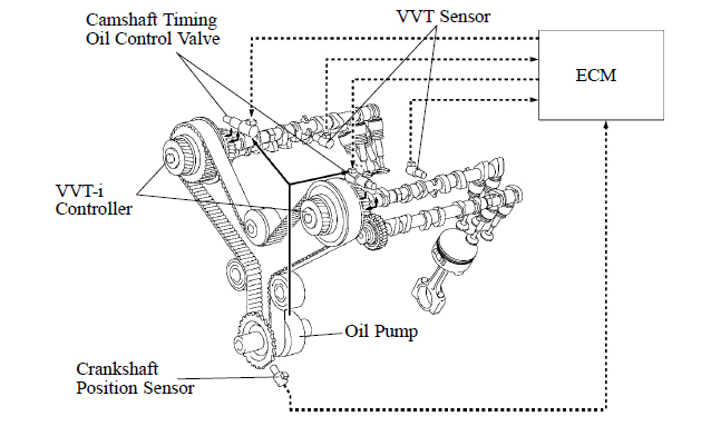

Jimi, sump pan - if you mean the engine oil pan - removable. My car sump is at the rear, but if your engine is from an LS it should be at the front. Oil pump is front mounted and crank driven.
Yours won't have the VVT stuff but the rest will be the same.
Some other points of interest to occupy you before the engine shows up:
http://www.lexusv8engines.co.za/1uz-fe-non-vvt-4l-v8/

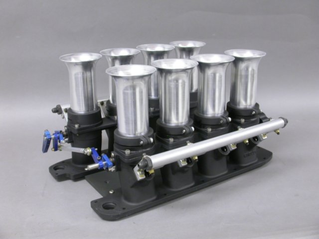

Well i am pumped about kinsler injection, who is in Troy, Mich and its AMERICAN, hardware, software, kinsler is from old skool drags, oval and bonneville, the selections are phenomenol, pre fab, custom machining and all axis of injection modes..lots of Mopar applications. A complete DIY design and build your own by their playbook, seems they try to cater to many different sets of needs, phone call today was very enlightening. This is good, i send them oem manifold and they machine ports EXACT match from blank manifolds, either cast or billet, to MY oem manifold, on this end ill get the head ports deburred and smooth without changing port dimension. Cross flow is too rich for me, but a raw cast, vertical, direct stack injection w brainage, looms, linkages, complete, ready to bolt amd wire in, is going to run about 7k, but before cams & what not, i will see a horsepower gain....im 250 stock and im only looking for another 50. This is not going to be cheap, but this is FAMILY, so im willing to go as far as i can go. I highly reccomend taking the time to check these People out for your induction needs, save for carbureted systems. Its my yello brick road i think.

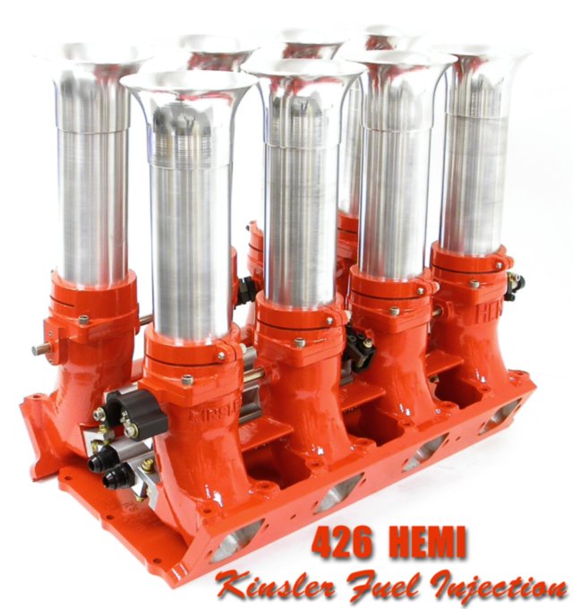

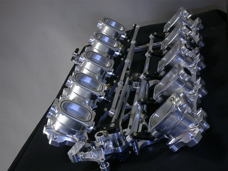

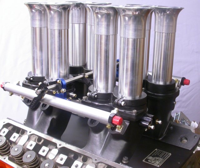

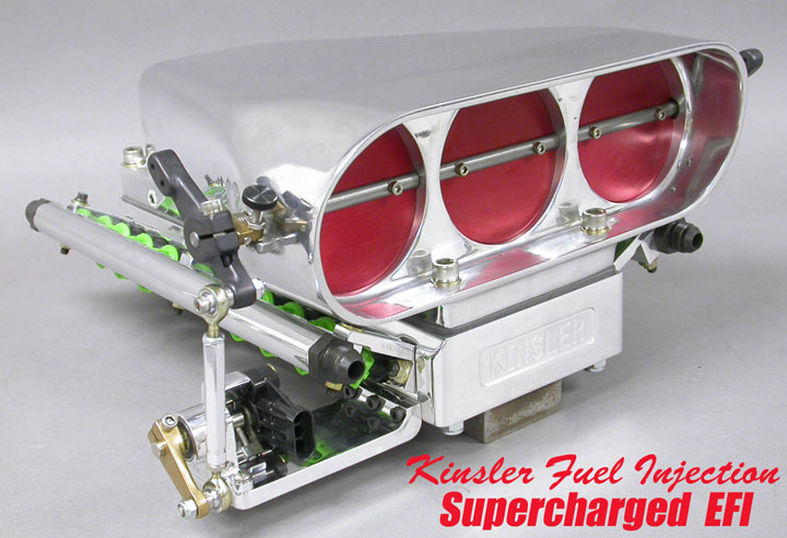

Jimi's phone troubles wouldn't let him upload some pictures so I'm just placing them for Bladecutter to insert his comments. These are from Kinsler Fuel Injection, the guys to whom Jimi has been speaking regarding an intake system for his Bug project.
Thanks Photon!
See if i got this right.......
The 1st rig is similar to what im looking at for lexi, i send my oem manifold to them they match ports exact, tuner on this end will clean up head ports w/o changing shape.
I think this is a 440 rig, thats a 440 head isnt it?
An EFI supercharger rig
426 rig
The Billet Viper rig didnt make it, but all systems can be cast or billet, there are cross flow and cross ram for all big three BB & SB. Kinsler is industry standard in outlaw sprint and far more, including Cadillac racing. They are Big on old skool Lucas type mechanical injection on steroids in combo w/ my favorite, Scintilla Vertex Magnetos Which my Partner Paul may do on His BB chebelle....billet cross ram.
Oh right...well here's the billet Viper rig: (777) Bless You Sir Photon! OK Mopes, this is getting me jazzed.....this is le Billet....zoom on the bodies & fuel rail tubes....the welds could have a micrometer run on them w/o much variance pool to pool. If i dint have to spend on ecu & brain crap, i could do billet...the welds on my front subframe and suspension pieces are damn near this tight , i dont see how it can get better than this! I am lucky lucky to have found this outfit in Good ol US of A. Only because they are so heavily involved in racing, do they cover the lexi, otherwise there isnt much aftermkt support for the lex/toy motor and toy/trd are snots, unwilling to divulge info and their brain boxes are fairly closed affairs, no flexibility in parameters. Waiting on motor to show. ZOOM the Billet!.777

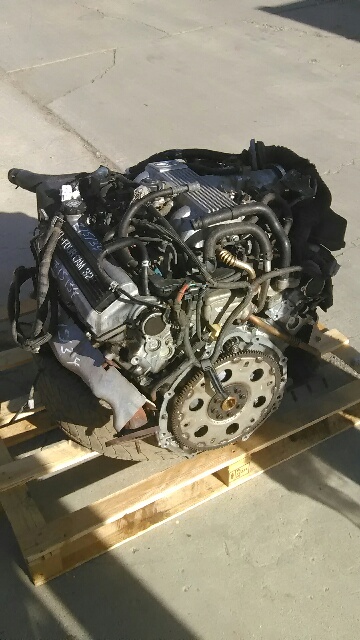

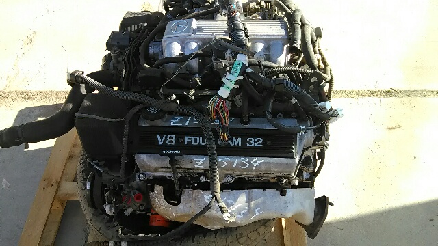

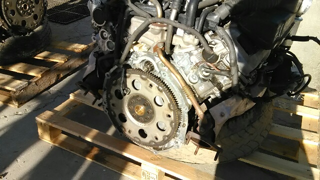

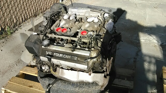

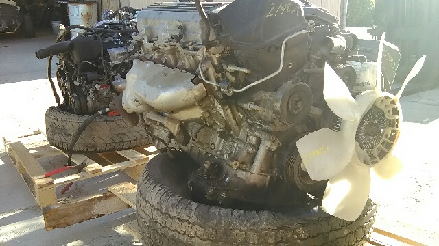

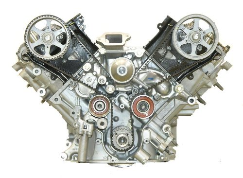

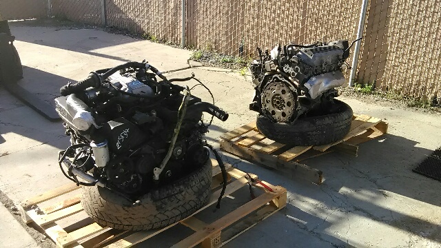

Here you are, one of these engines will be powering the Bug. 4.0 Litres (244 cubic inches) of aluminum block, light weight zoom.

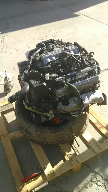

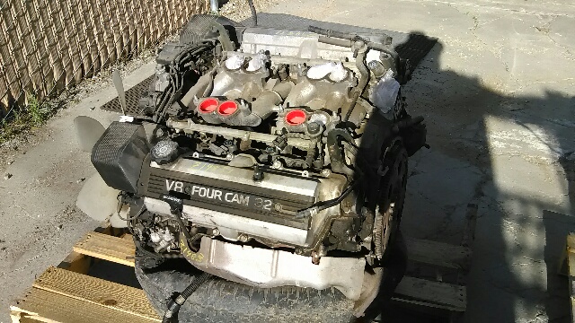

PART_1455147346723_IMG_20160210_1528241.jpgPART_1455148515302_IMG_20160210_1527381.jpgPART_1455148553567_IMG_20160210_1531041.jpgPART_1455148577719_IMG_20160210_1530061.jpgPART_1455148624159_IMG_20160210_1529141.jpgPART_1455148638961_IMG_20160210_1528261.jpgPART_1455148657612_IMG_20160210_1502201.jpgPART_1455148682175_IMG_20160210_1502051.jpg
