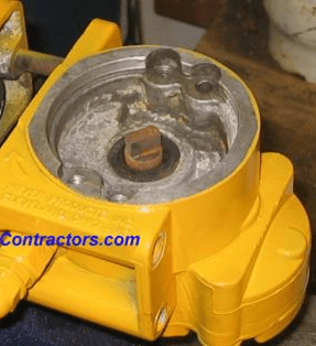

Well gents - revisiting my old post as the plow gremlins won't go away...back looking for some tips. The plow 'works' but ahh...like chit. Super-super slow and will decide to respond to controls and more not so much. I've swapped the A and B coils, cleaned the filters, and today put it back in the vice pulling the motor. When I took it off, fluid leaks through the motor shaft seal like nuts. So might assume that seal is bad and getting one from a supply store tomorrow for $15. Anyone replaced this seal (see pasted photo around the slot/drive shaft)? I ordered a seal kit (for the ram I'm waiting on) and getting a nice deal on a new motor so ordered that too. I've read about how this seal can be removed by drilling a small hole in it, inserting a screw to pop this off. Interested to know what you folks having messed with these have done. Thanks!
I've never had good luck removing seals like you suggested...drill hole/insert screw and out she comes. I bought a complete Meyer E47 re-sealrebuild kit for my unit since it performed like you describe, think I got it from a plow supplier on E-bay. After that it works great, nice and quick on all the movements.

It took a while to remove the seal drilling two holes on each side inserting screws. Bugger wasn't wanting to come out. What I finally found helped, was to give a sharp tap one side of the seal while pulling up on other side of it with my needle nose pliers then popped out. Was close to disassembling the gear box; but Meyer's guides say don't do this as there's no servicing it and those cost 200+ bucks. The new seal is a hard press on and guess needs to be to create a 'seal' huh. I lubricated it well as well as the outer seat before tapping it in. Then went to re-do the ram taking it apart, cleaning, new seals, etc. using the kit. New motor should arrive today or tomorrow and will see if I have a plow I can depend on again when I need it...

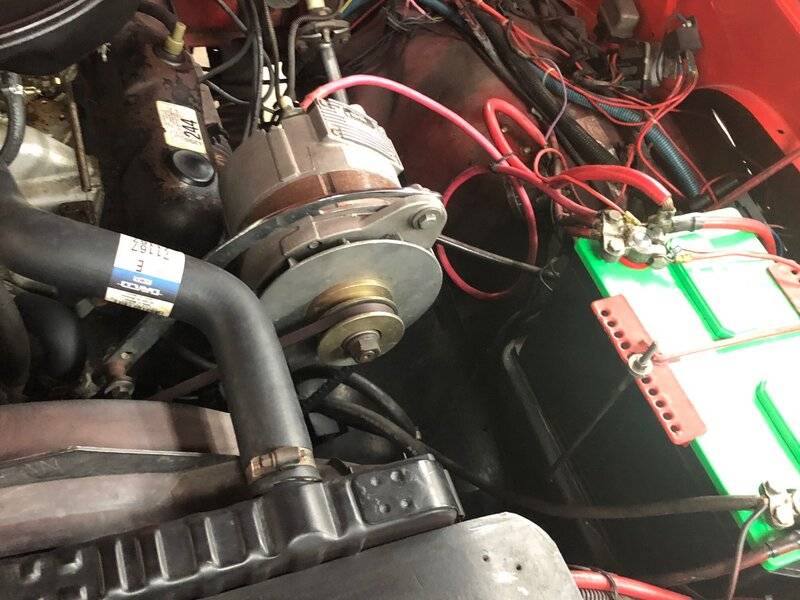

I had a 69 3/4 ton Chevy with 456 rears that I plowed snow with for some years. Id fill two 35 gallon drums with water and strap them in the bed. I had thick lugged tires on all 4 wheels and that truck nothing would stop it until that one night in a large parking lot surrounded by two feet of snow, I hit the button to raise the plow and the truck stalled and the battery was dead
The alternator wasn't putting out enough amps.....No cell phones to call my buddy at another location
Gotta keep your rig and plow maintained carry spare parts and tools as I had to learn the hard way like most everything else
