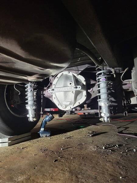

I started out a couple weeks ago by installing new rear shocks and springs. I also moved weight around with the 4 link bars. The weather has been terrible here so I had no time to test.

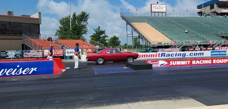

Friday we got 2 time shots. There was a gamblers race that evening but I passed on that this year.
1st shot the car ran good. 9.68@ 138.88.
I felt a little shimmy at the top end but nothing bad.

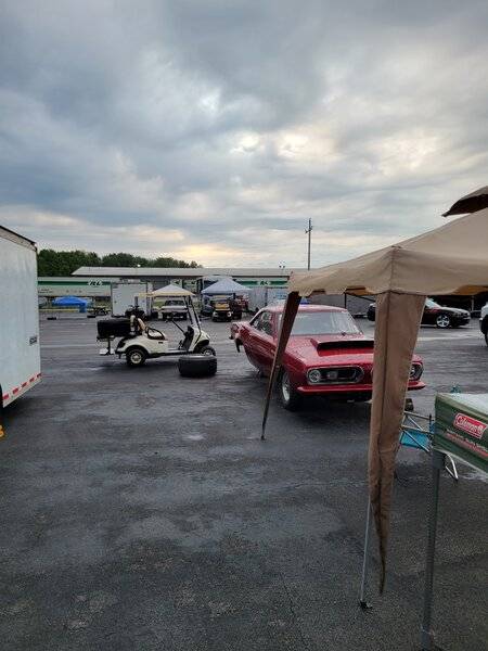

Saturday morning it was raining so we had some time.
Sprayed the tire again and found an old nail hole.
Back to the tire shop and he patched it.
Got everything back together and waited for the rain to stop.
