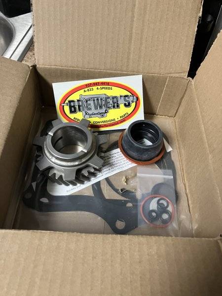

After getting the trans back together and running it a few weekends I have a bad vibration that comes on especially over 5k rpms.
I’m wondering if I possibly bent the input shaft. I didn’t inspect it for straightness when I had it apart.
Does anyone have experience with a 3rd gear failure like this?
