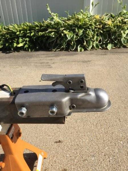

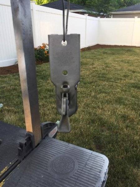

I'd say it worked! Im a believer!
Before
After
Before
After

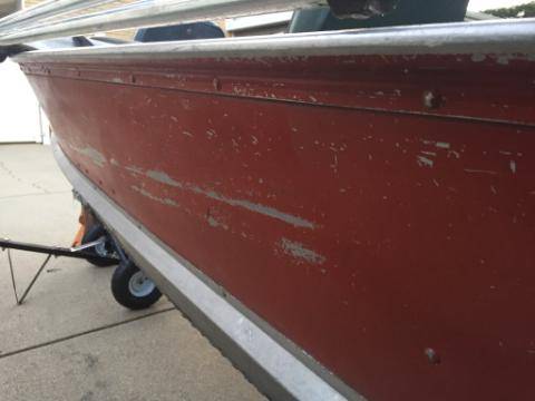

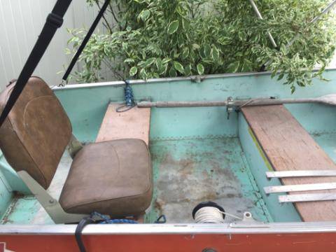

Looking to repaint Reba inside and out.
1) do I need to take it down to bare aluminum?
2) I assume there is a special paint / primer to stick to said aluminum?

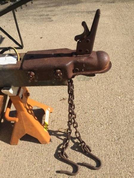

I would, Mario. Looks great!Im wondering if I should spray the hitch with a clear coat of some sort so it doesn't flash rust?

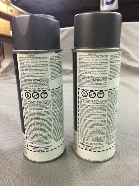

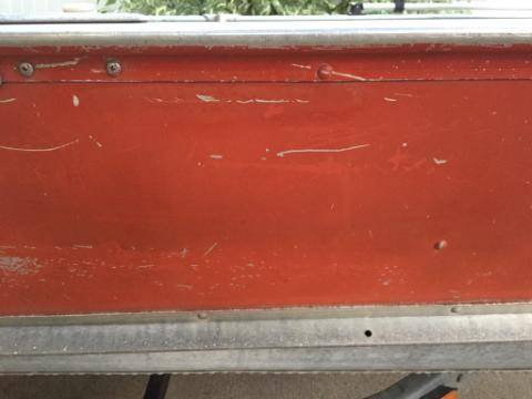

IMHO, I would take it down only as far as required....to solid primer - whereby nothing is flaking off, or any deep edges. If the original primer is feathering out OK, I would run with that. Check first to make sure that your new paint will not 'fry' on the old surface....if it doesn't - you're good to go.A couple of cringe-worthy questions for the group...and they both involve aerosol cans View attachment 1304713

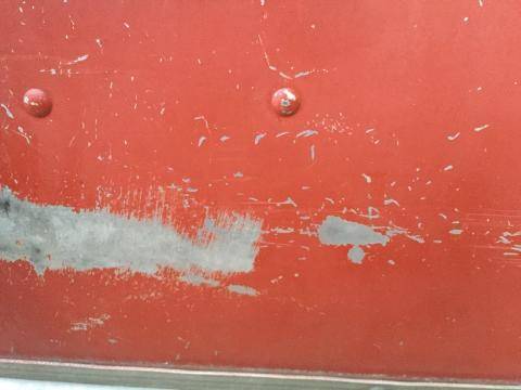

I am using 1k self-etching primer in an aerosol. Do I take it all the way down to bare aluminum? Can I sand the current paint down enough to where the primer will stick? I am painting over the primer with automotive-grade paint (in an aerosol) and then a 2k urethane gloss clearcoat (yes, that damn aerosol again lol) over the color.
It's not chalky. Im thinking if I hit it with a DA and 400 grit, the substrate should be pretty flat. Also, the 1k primer is a filler/primer. They called it a 'wash primer.' So that'll help. lol
The gray is the bare aluminum of the boat. The other side is a little bit better. What say ye?
View attachment 1304719View attachment 1304720View attachment 1304721

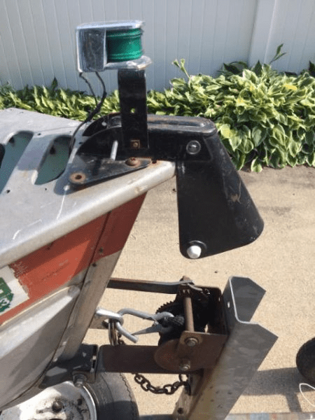

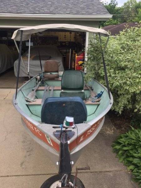

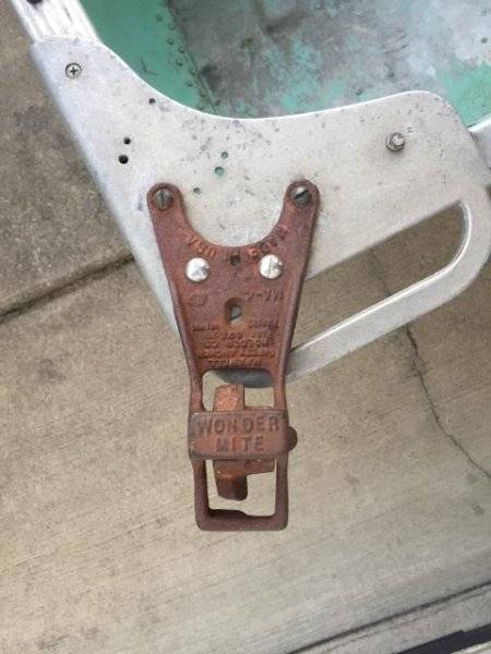

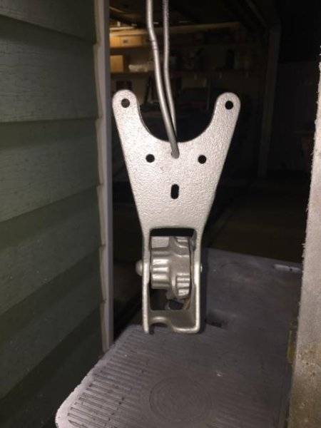

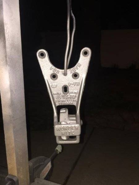

That is called an 'Anchor Mate'. The anchor is supposed sit under the hood. It has a rope and pulley system along the port side all the way back to the helm.
Of courseIMHO, I would take it down only as far as required....to solid primer - whereby nothing is flaking off, or any deep edges. If the original primer is feathering out OK, I would run with that. Check first to make sure that your new paint will not 'fry' on the old surface....if it doesn't - you're good to go.
My opinion only of course. I have done a ton of painting, but I am far short of being an expert.![]()
