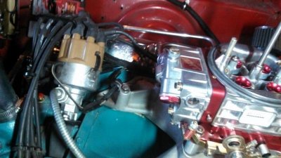

ResizedImage_1407699592297.jpgThanks for putting that back up. I get discouraged by the trolls on this web site and just end up removing about half of my posts. This particular tach is a Jones-Motorola 4" tattle tale sold by Moroso. It even has the original gold anodized bracket found on almost every pro stock mopar dash board of the era. It is hooked up to a factory electronic tach drive distributor that I found in the clearance section of 440source.com of all places. It is basically an aluminum copy of a prestolite dual point distributor. I have a cast iron unit that is exactly the same outside of the casting material. One item of note is that the advance plate on the early electronic distributors required replacement of the magnetic pickup itself not the entire assembly like the late style distributors. Here is the other end:

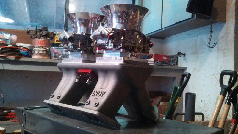

Thank you for all of the feedback. I am most likely going to mount the tach forward and facing the driver more once we get the dash pad back in. The clutch exploded last Tuesday night so we have all new stuff coming from Passon Performance. Once I get the dash finished, windows rebuilt, and roll bar reinstalled we will pull the drive train. Out with the old 499 RB and in with a 511" low deck with MW CNC Edelbrock victors and a big solid roller. Still up in the air on using my 400-2 Indy and the HVH 250hp spray bar deal or the Indy tunnel ram. If we could sell our silver car there is a race car I'd like to pick up and use the spare 511" we have with the tunnel ram and a 4-speed lenco. Might make a cool street-strip deal.

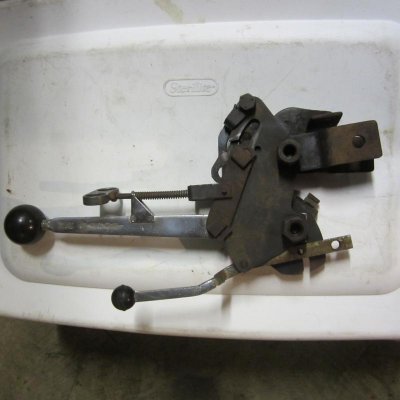

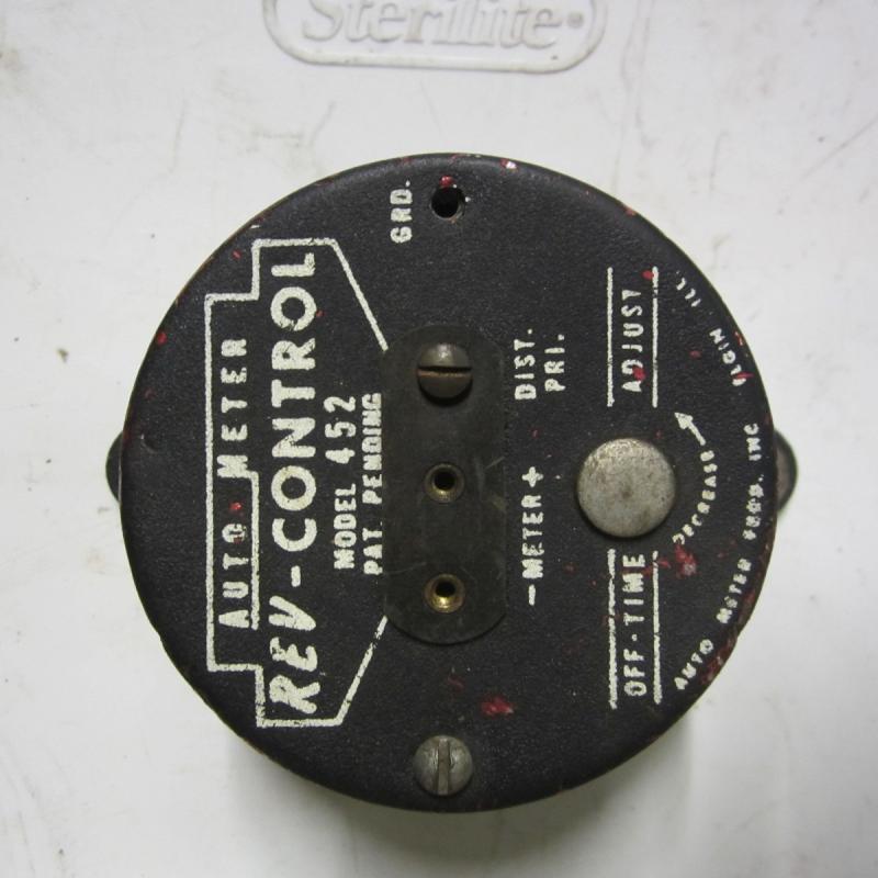

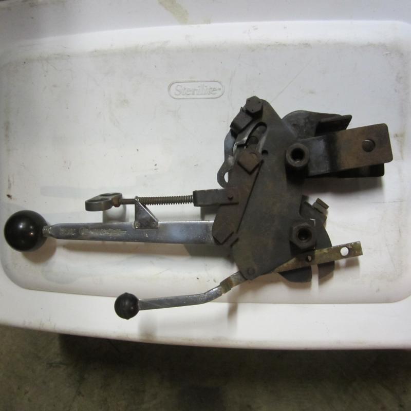

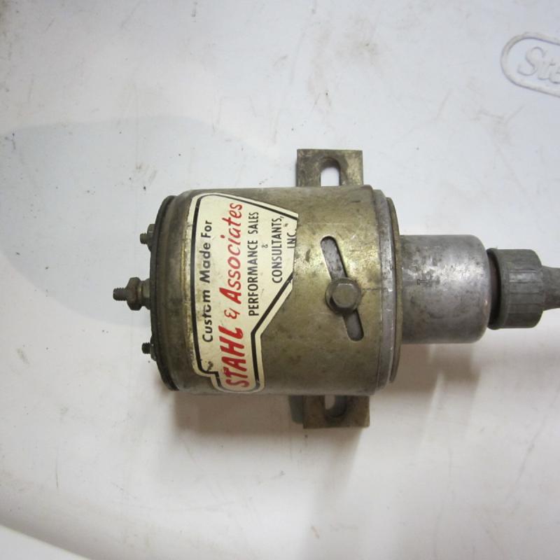

I still have a Mr. Gasket Vert-i-Gate shifter from the first drag car and swapped some stuff years ago for a couple cable driven Rev-limiters. You know your getting old when stuff you bought new is now considered "Vintage"!

You can't just post cool stuff like that without explaining how it works. Is there a splitter that runs the tach and RPM limiter?
I never could get used to the vertigate I had in a different car than the Charger above. I have been thinking about trying it again but hate to hack up the floor. How much has to be trimmed to fit that setup?
