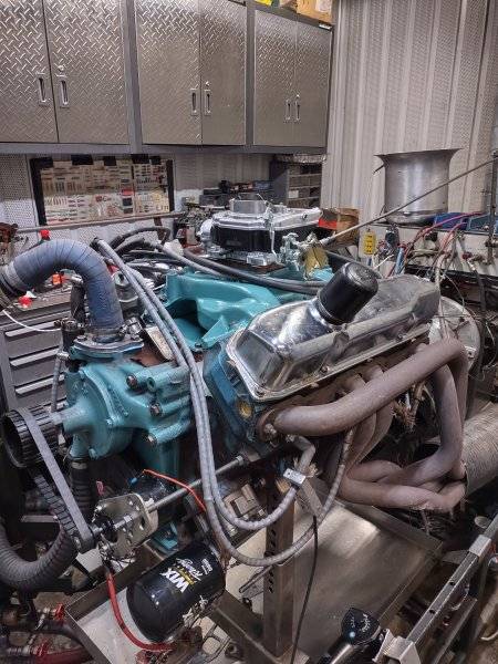

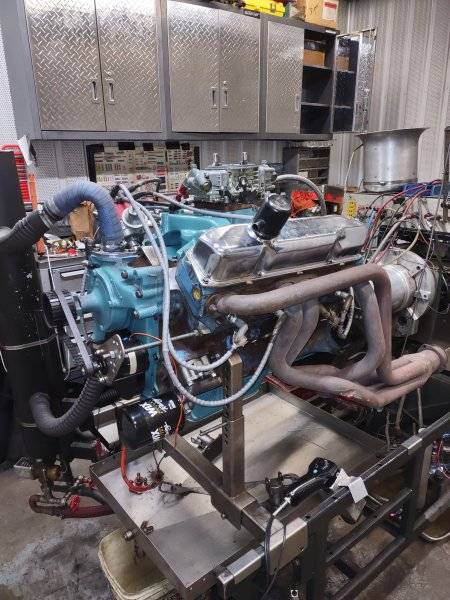

That is very cool... there isn't a lot of info/testing of those carbs and i wanted small primaries also.. Plus how could i hate a GogglevalveYes, the shop breaks everything in using their 650 Holley DP. The plan is to have them optimize the tune with the dyno carb, and the switch to the Demon, and then try the AFB. They are both 625's so it should be a pretty fair comparison. The AFB was on the car when I bought it, but the manifold setup was terrible, so it never really had a chance. I bought the Demon for the small primaries, to try and balance economy and power. We'll see.
You're probably about right Dave. The old 400 was only 9:1 but it had 10 degrees more camshaft and it made just over 400 HP. Lower than 375 would be disappointing , but anything higher would be a bonus. I am almost more interested in the torque curve, that is what this heavy car needs.What are you looking at for horse power? Considering low compression, I am guessing around 375.
what brand Dyno are they using ?I talked to the shop this morning, and they are going to glass bead the runners and run the heads through the washer again, to clean up some of the areas I couldn't reach with my short carbide. I know it won't increase the flow, but I will feel better that everything is clean.

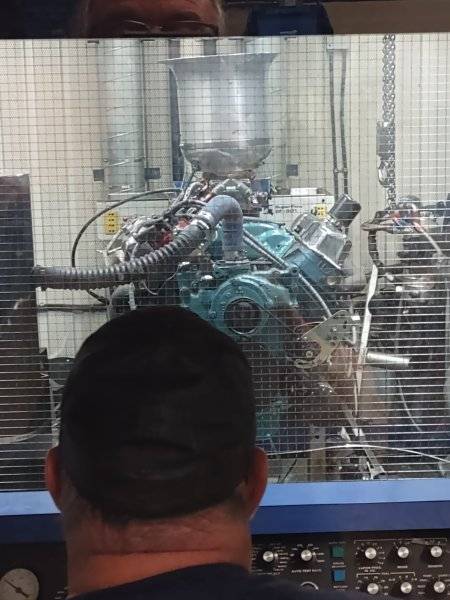

They are also ordering the KB 240 pistons today .030 over, so we are starting to make progress. Not sure if I mentioned it before, but we will be running it on the dyno to break in the cam, and get some numbers. They have dynoed the last two engines I built, so looking forward to it.
What were the other carbs?Well after a tiring day I am home relaxing. The good news is there were no oil leaks or water leaks, and the cam broke in just fine. We made 7 pulls in total after break in. The best pull was with the 650 DP dyno carb, no surprise there. It made 420 lb/ft of torque at 3900 with over 400 lb/ ft from 3000 to 4300. Horsepower was a little disappointing with only 340 at 4800 rpm. I guess I needed more cam, but I did say low end torque was the goal.
It was a good day, thanks. I failed to mention that the Holley was a 650 and both the AFB and the SD were 625'sWhat were the other carbs?
