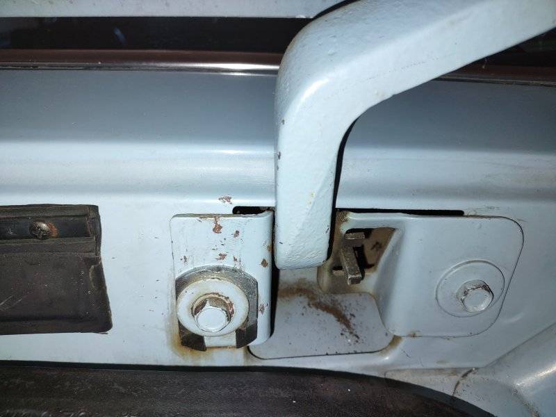

I did a nut and bolt check on the car today. I found a couple of loose exhaust hangers and a loose fan belt. I noticed a loose trunk hinge bolt at the last car show, but when I went to tighten it the inside nut was seized and everything just spun. I cobbled up a tapered shim out of a washer and pounded it in with a drift punch. Problem solved, I think.

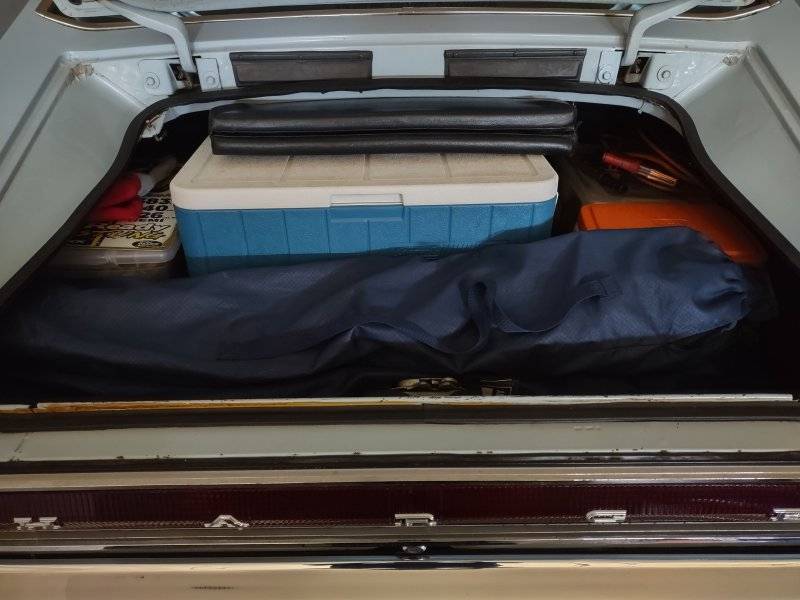

I painted the trunk hinge repair and loaded the trunk for the trip. Just need to pack my suitcase.
