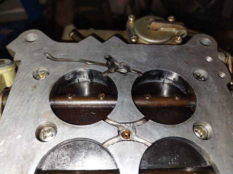

I assume you’re running vac advance.
Ported or full time?
In this pic you posted, if that’s the position the blades are in currently, they’re open too far.
Insomuch as most of the transfer slot is already exposed, which means there’s very little left to be exposed during tip in.
It also appears there is a baseplate screw missing in the front center.
If there are only 6 screws in the baseplate, I prefer to put 3/3 in the front/rear, and leave the ones in the middle out.
Most(all?) new carbs have done away with the ones in the middle.
