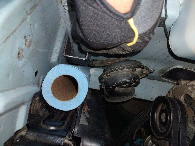

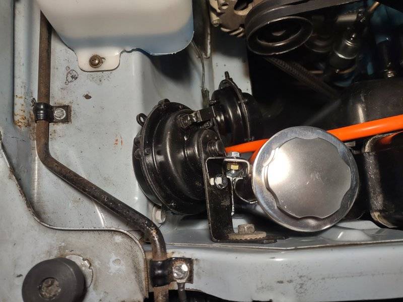

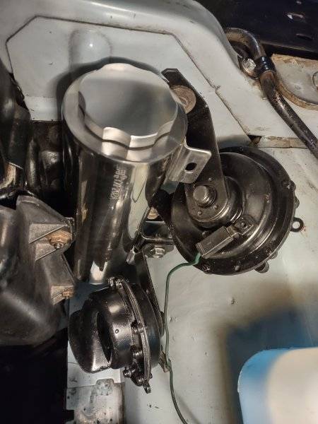

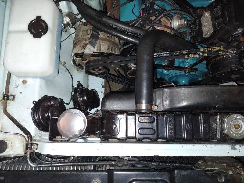

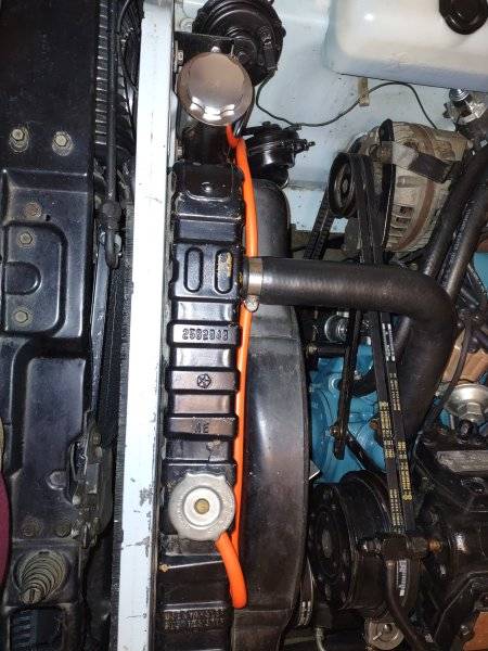

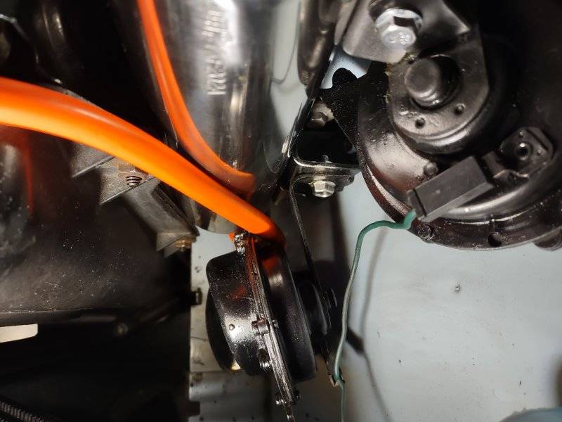

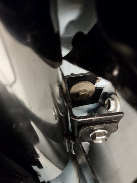

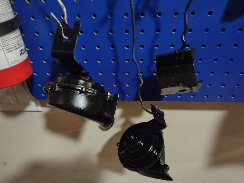

Due to my overheating problems, I decided to add a coolant recovery tank. The issue is finding some real estate to mount it. The driver's side is out due to the battery tray and my headlight relays. On the passenger side I have the horns occupying a lot of the space. I found a 3 inch round by 10 inch deep stainless steel tank that might work. Looking around I found that my towel roll was down to exactly 3 inches by 11 inches, so it became the template. I also found that if I spaced out the lower horn bracket about two inches it would clear. I happened to have some 2X3 tubing left over so I cut a small spacer. The upper horn is okay. A quick test fit and I think I will be good to go! When I have the rad recored I will have them turn the filler neck so the outlet faces the passenger side.
