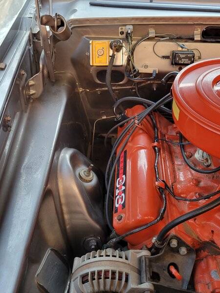

Nipples? Why yes!Are the 64s the same as a 62 where the nipples come out behind the motor on the drivers side?
(they are on the drivers side of the firewall)Nipples? Why yes!Are the 64s the same as a 62 where the nipples come out behind the motor on the drivers side?
(they are on the drivers side of the firewall)I couldn't think of a better word for some reason.. my brain is brokenNipples? Why yes!(they are on the drivers side of the firewall)
All good. I knew exactly what you meant.I couldn't think of a better word for some reason.. my brain is brokenInlet/outlet tubes

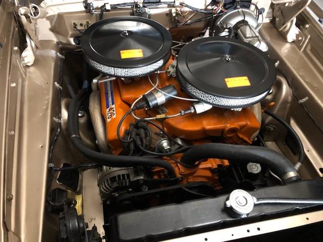

Mike, you have to paint that air cleaner black. I hurts my eyes every time I see it (lol)

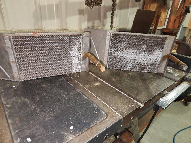

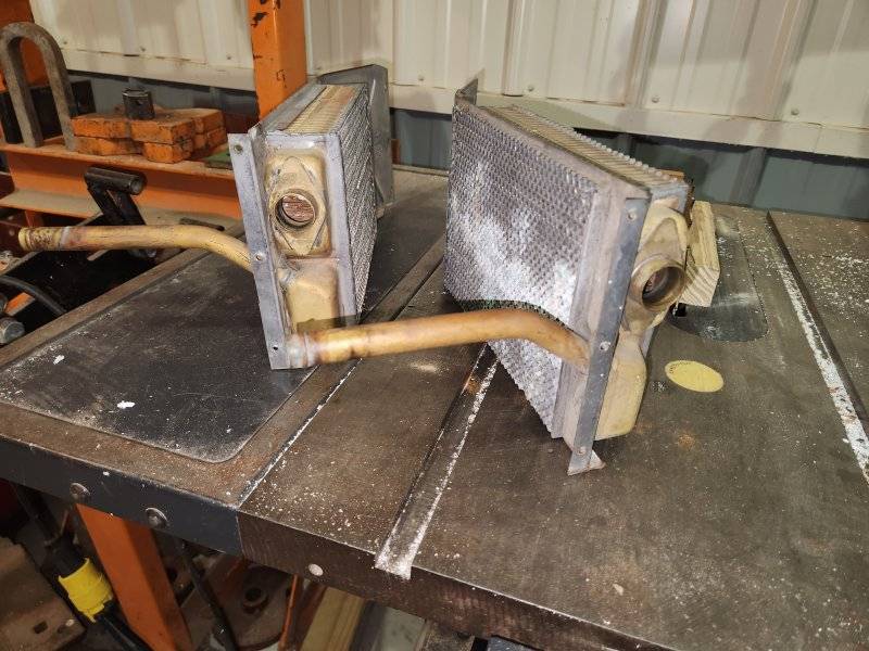

I see only 1 pipe. Does the valve go in the big hole on the end?These are from a 64 fury. Both were leaking some. Any question PM me.
I dont want to jump in this thread.
May be that's what started leaking on mine.Mike. Yes and a o ring on the valve end. You can change the valve by it self and not remove any other part of the heater. And makes it easier to line only one pipe if you are installing the heater box.
