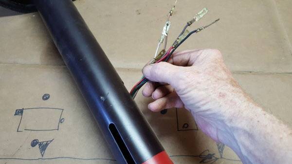

If feeding the wires down the column is a major issue, I might think about cut, strip, solder, and heat shrink up closer to the switch. As long as the wires and the connector are good. (probably not) LOL

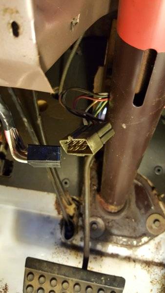

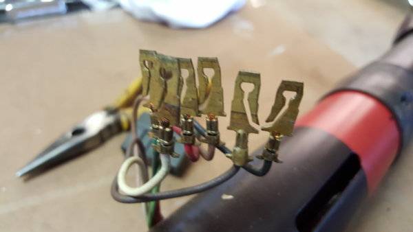

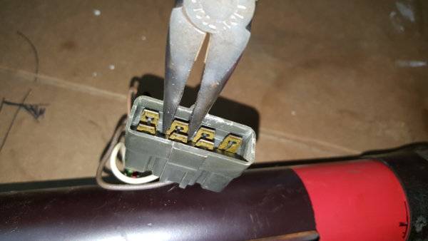

Here's the type connection that you have.
Use needle nose pliers to gently release each one. Just draw a diagram of each color and location. If you forget just look on the other half in the car.

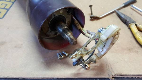

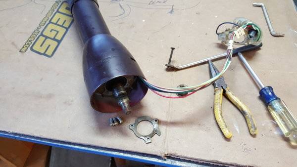

Then you can remove the screws on the turn signal switch and pull them through the column.

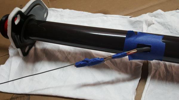

To install, do everything in reverse. Tape the wires all together along with a piece of stiff wire, to fish them back down where they come out.

Before you pull the wires up through the column, tape the wire terminals under the dash together as tightly as you can, with another piece of wire included in the bundle. as you pull the old switch out, this length of wire will be pulled up through the column. Snip this wire off at the old terminals, and attach it firmly to the new ones on the new switch. Grab the end of this wire, under the dash, and slowly and carefully pull it through the column, pulling the new wires in. Attach the terminals to the correct holes in the block, and plug back in.

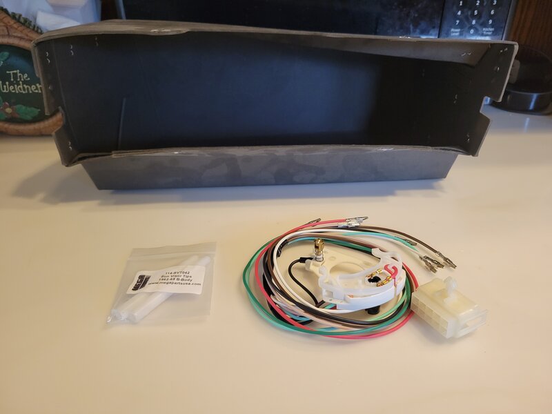

Well, time to complain. I put my turn signal switch in and it works better but I still don't have brake lights on one side or the other like before. They don't work after using the turn signals. It's the same problem others have had and some new switches fixed the issue and some didn't. I got a OER brand and I heard a few had issues with those. I'm lost for now.

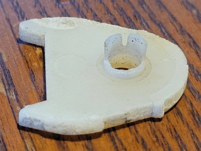

Oh and funny but not funny. I was setting in the car putting the steering wheel back together and I heard a strange crash noise. The body side molding on the RF fender just fell off the car. WTF !!!! Of course the clips are unobtainable. If I had a good clip I would see if someone could 3D print me some. This photo is from The Layson's website. The pin that goes in the hole in the fender is split into 4 and should have a little flare at the end to hold onto the hole in the fender. I suppose I could silicone them in. That would be better than loosing a molding while driving down the road (or loose one in the driveway) LOL
Mike won't a pop rivet work or a bolt and nut if you can get at the back side. I have a good supply of old clips but not that one.
You can use a blue butt connector . Cut to fit
I'll have to give those a try. Thanks. I haven't looked through the clips at the parts store for something that might work.
