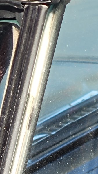

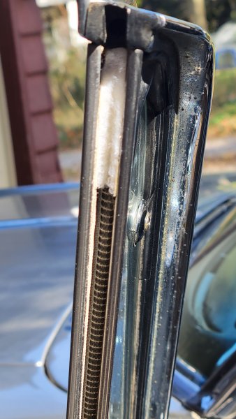

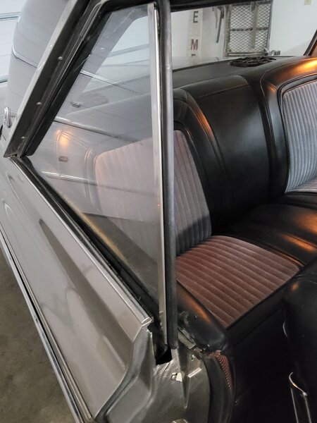

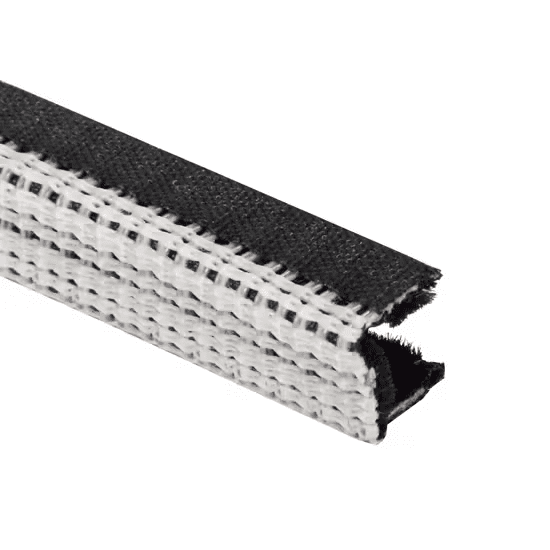

Hey @icetech, I tried a little trick I heard from you. You used the fuzzy side of Velcro in your window channels. My seals are completely gone and the door glass rattles really bad. I had some white Velcro (wrong color but just an experiment) I cut a couple of 2" long pieces and stuck them in the channel and rolled the window up. Rattle 99% gone! Just a test that worked.

awesome... And i think i got that trick from Khryslerkid... i can't stand doors that rattle when they close, if you do the whole channel make sure to use something to hold the velcro really tight in place while the adhesive sets up, my drivers one gets hard to roll up bout 3/4 of the way

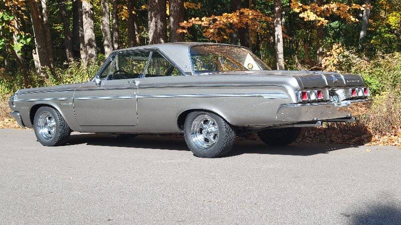

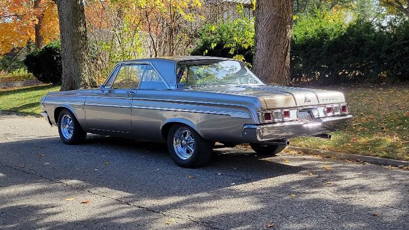

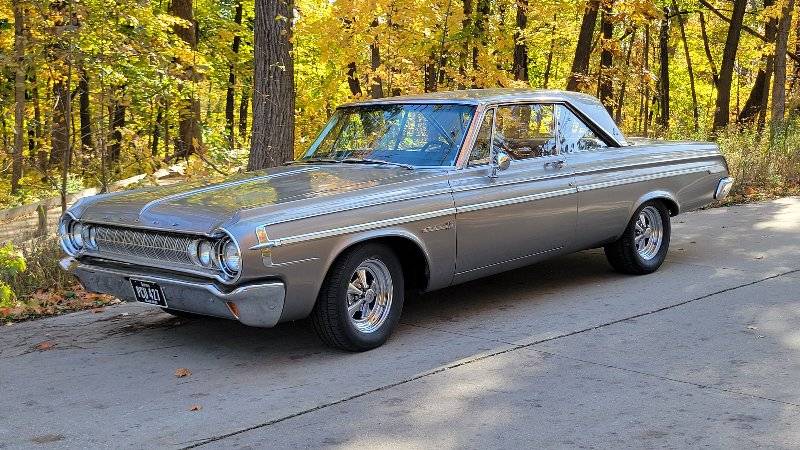

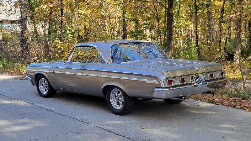

I drove around and took some fall pics yesterday. The ol' girl makes me smile.

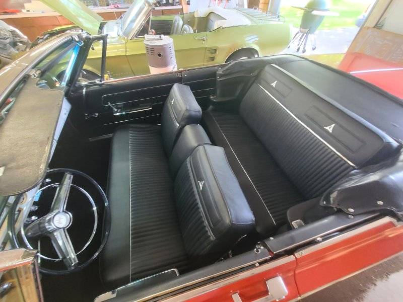

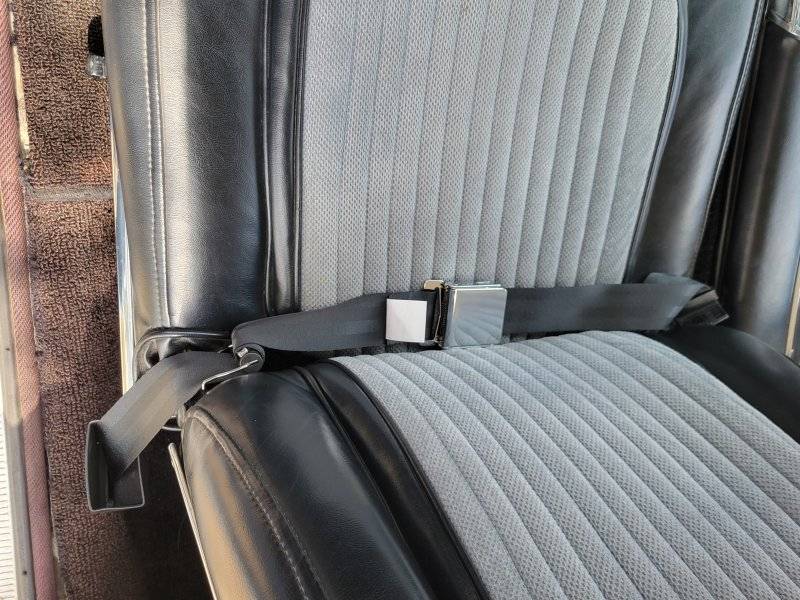

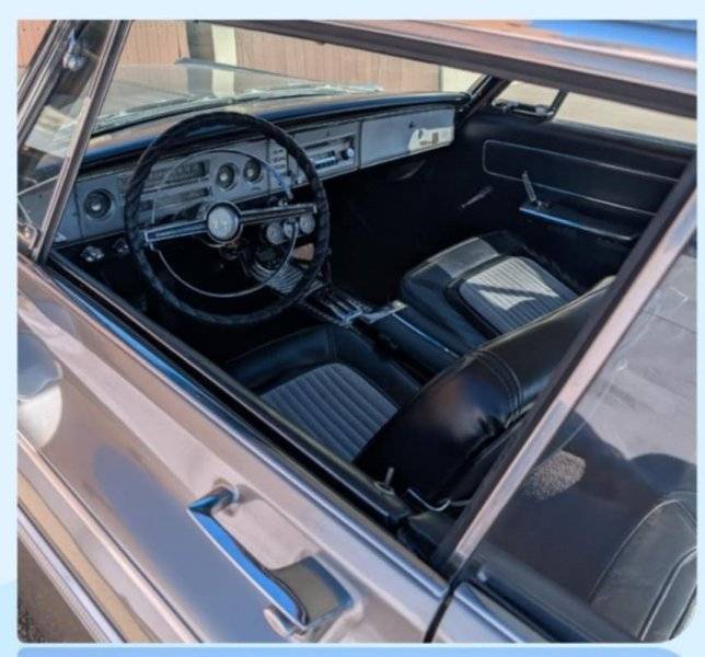

If you decide to do an interior, I'm really happy with the seat covers I got from Legendary. Mine is the bench seat. Yours looks to be the 500 with the front buckets.
Home made upholstery not done too bad. The seats are uncomfortable and the upholstery is thick and stiff. I may buy seat foam and upholstery and next year get the door panels. Your's looks great.

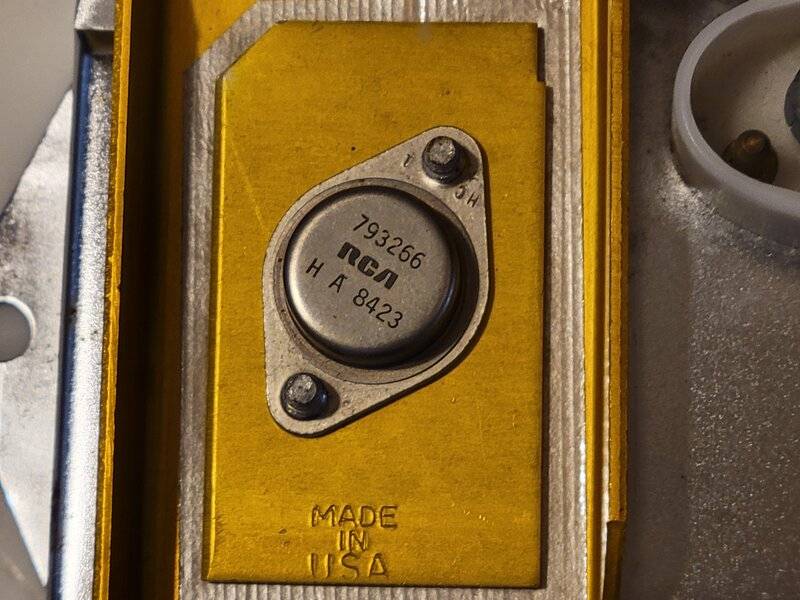

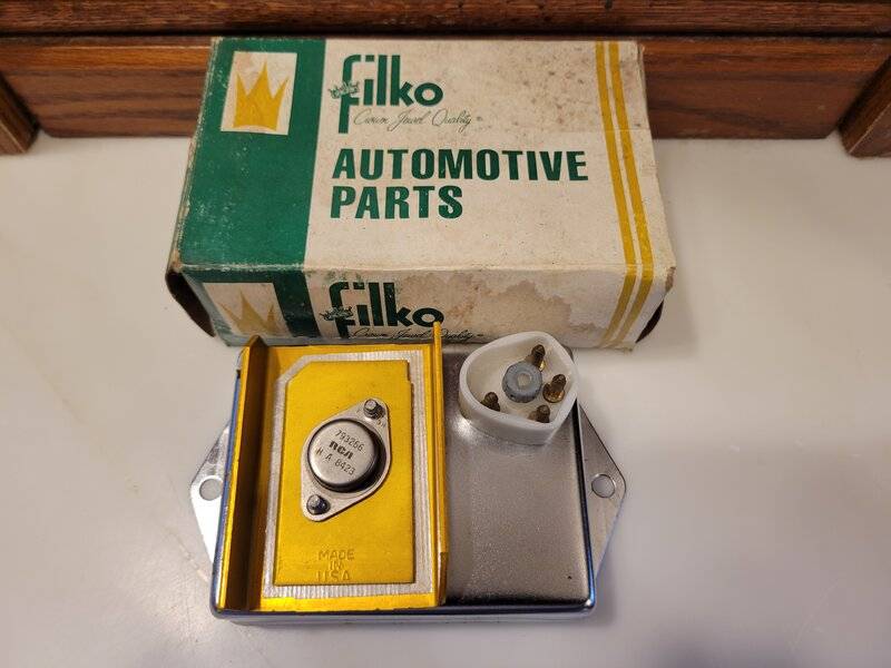

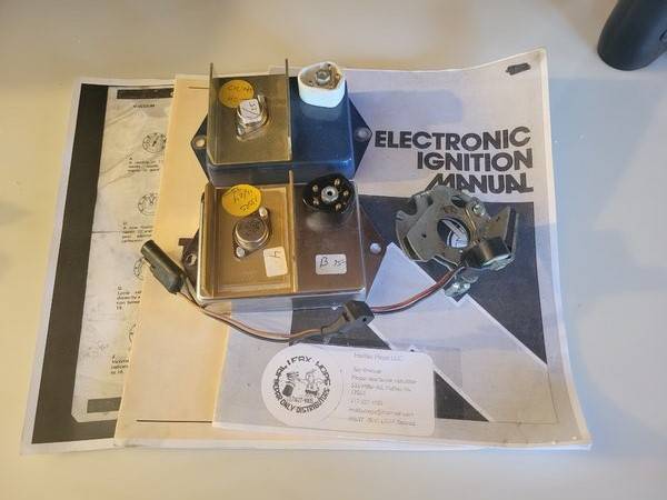

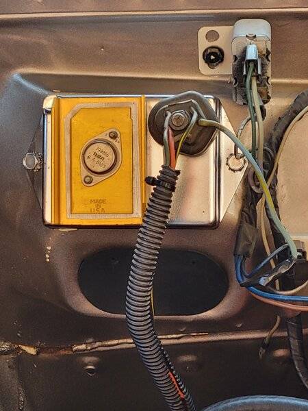

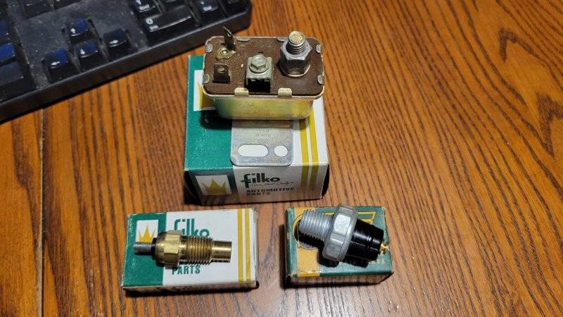

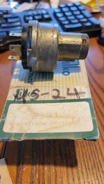

I have been on a NORS parts kick lately since I straightened out my ignition system. I sold Filko Ignition back in the 70's so that's what I buy. I have 3 catalogs and I look for parts on the internet. I have oil pressure and water temp senders, an ignition switch, starter relays and extra electronic ignition ECU's. That reminds me, I need to get a ballast resistor or two. Hoppy fixed me up with a magnetic Puck up for inside the distributor.

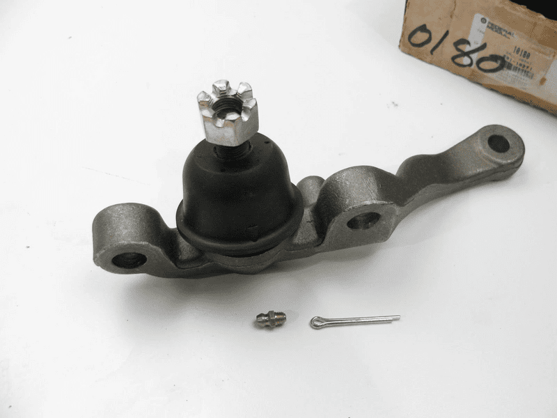

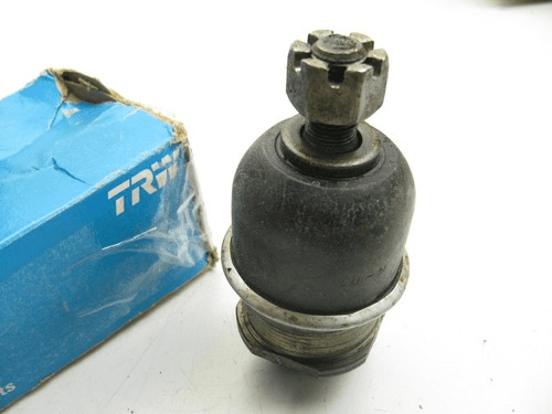

Now, let's switch gears to suspension. I had the alignment checked earlier this year and the tech said the lower ball joints are pretty worn. Well, I used to sell TRW at the parts store so I found a catalog on E bay and I did some shopping today. Hey, I found some nice lowers and 2 uppers as well. All TRW and all Made in the USA.

Are you selling some of them?? I need a water temp sensor for my 64 Polara. The one I bought has resistance readings from 675 cold to 90 hot. I understand the correct readings should be around 90 to 10.
Correct Ohm reading on a 68/70F shop temperature sender should be about 360 ohms. Once the engine heats up the gauge will read correctly as it goes through it's 72 or so ohm "cold" (gauge just starting to move) to 10 ohm full "hot" on the gauge.
