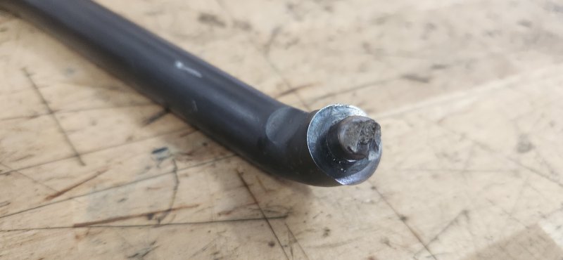

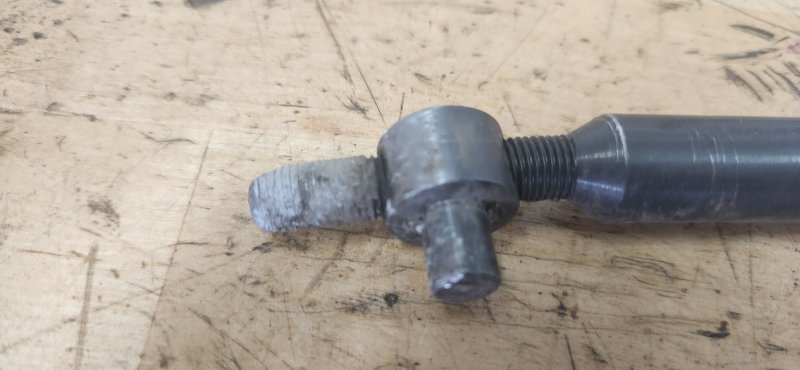

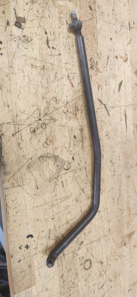

I took The Beast out for a drive on this sunny spring day. Shifting out of first and into second under moderate acceleration I feel a pop in the shifter followed by the sound of something dragging on the road. I immediately slow down and pull to the shoulder and the car hops a bit and I come to a stop. I take a look under the car and find my reverse shift rod laying on the ground. Looks like the cotter pin fell out on the transmission side, I dragged it for a bit until I hit the soft ground of the shoulder where it immediately dug in and snapped the end of the rod off, bending the reverse shift lever on the way out.

I had the correct washers and spring clips. This is a fairly new build using a kit from Brewers that came with everything so it was together with the correct hardware......although I guess the spring clip wasn't seated all the way otherwise it wouldn't have fallen out.
Weld a 1/4 inch bolt onto it and drill a hole in it for a cotter pin. It will get you by until the new piece can be sourced.

Cotter pins are soft, wouldn't use them on shifting rods. The clips are hardened.
