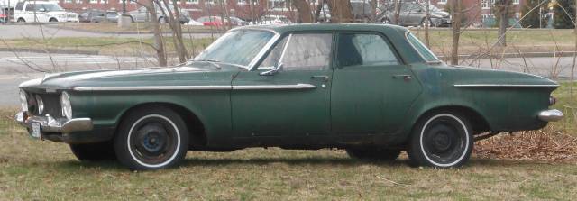

Hi Scott,
I was just searching this site and found your post, great looking sleeper and impressive times. I was about to post if anyone ever did a 62 fury 4 door sleeper. There is one for sale near my house and my son was interested in building one with me. It has the original 318 running although tired, push button trans and a little rocker panel rust. Same color as yours! I'm not sure what I'm getting into yet as I have been playing with buicks my last 27 years but maybe time for a change.
Greg
