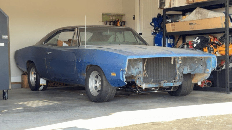

Well it has been nearly 3 years exactly since we've posted on the forum. Some big life changes but the Charger remains in the family. I recently got a job product managing MSD, Accel and Racepak with Holley Performance, so Bailee, the kids and I have moved down to Bowling Green, Kentucky!
Due to some tempting employee discounts, the car has started its transformation. Since the last update, we invested in and installed a QA1 front coil over conversion sub-assembly, paving the way for new-school handling and old-school looks!
Now we turn our attention to the engine. This RB440 is receiving a complete makeover thrusting it into the 21st century with Holley EFI (Terminator X), Multiport Fuel Injection and Coil-Near-Plug conversion using MSD Dual Sync distributor.

Man, I dig those wheels and tires! What are the specs on those? Size, width and brand?
Those are Aero Racing circle track wheels - series 50 - 15x8 - 4.0" BS - 5x4.5 - Aero 50-084540
on Nitto Drag Radial NT555RII P275/50R15 (25.87" tall x 11.18" wide)
Same size all 4 corners, they're a little short in the rear, but we wanted to run uniform sizing for a true circle-track look. We'll probably raise the front of the car .5" and lower the rear .25-.5" to achieve better stance.

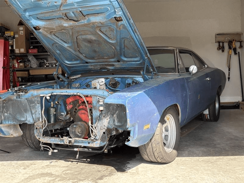

Looks good. Looks like you need an engine for that thing now.
Gotta get fuel in there somehow!
