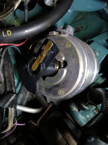

Anyone have a clue as to what l have here. Says China and either a 6000 or 8000 number.

Best thing to do is consider replacing it with something more current....your choice of brand or as Ray Brenner at @HALLIFAXHOPS for his opinion. The pix of the rotor assembly looks like it came from a Prestolite Dual point distributor although I'm sure it's not but some type of magnetic pickup distributor. Replace it b4 it leaves you along the road somewhere ......just my opinion......

Likely a knockoff that you can't get parts for when you're on the side of the road,like Renton saidI just put points in a 66 Mustang Saturday.:usflag:
Thanks guys! Yea that's what l was thinking as l'd like to go back to an OEM style.

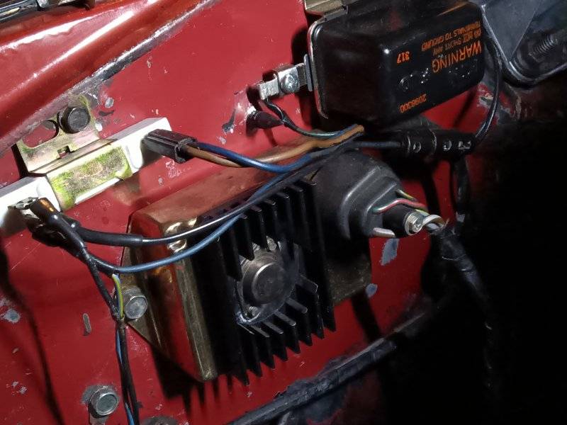

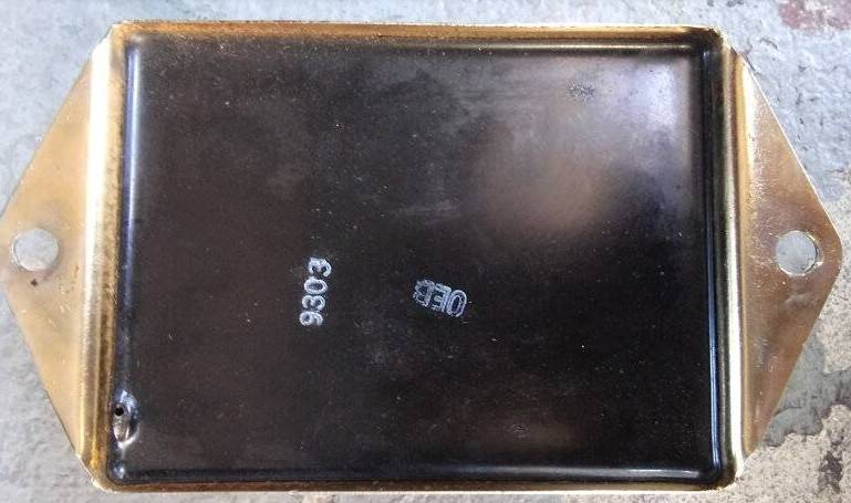

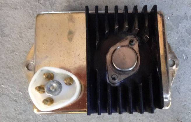

Here are the pictures of the ECU we talked about that I have no idea what the numbers on the back mean.

Awesome. So if I'm reading this correctly mine is the last one?
seems like it. Do not use the recomeneded ballast on the street it will burn it up.
You do know there's a screw missing on the transistor?
Thanks. I'm using the one in my pictures, No issues so far after a few years with it on. Should I be using something different?
I think that's the picture as l just checked and both screws are there.
That one is OK the 1/4 ohm is pretty large. Around twice the girth. Race only thing cools down between runs.
