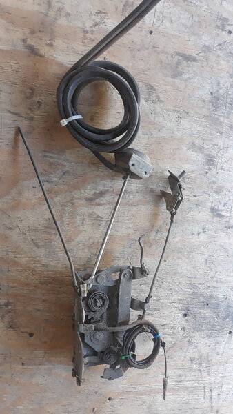

Mystery Part ID needed.
Rat Rod Al
10:19 PM
Nov 5, 2020
857
797
Lecanto Florida

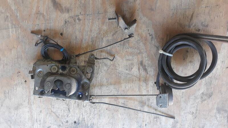

What the heck is this and what years?
It has a wire and vacuum can .
Any help is appreciated!
Door lock assy w/vacuum lock actuator...
Vacuum operated trunk latch.
I have both an electric and a vacuum Mopar trunk latches and they are nothing like that so I can tell you what it isn't.
I don't really think that it is anything for 1962-74 Mopar except maybe a tail gate latch for like a Chrysler TC wagon, maybe?
Actually looks more Ford than Mopar to me.
My remote trunk latch looks like this LOL:
There’s a section on power vacuum door locks in a ‘64 Dodge 880 service manual I have.
