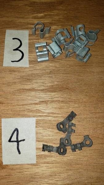

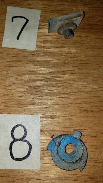

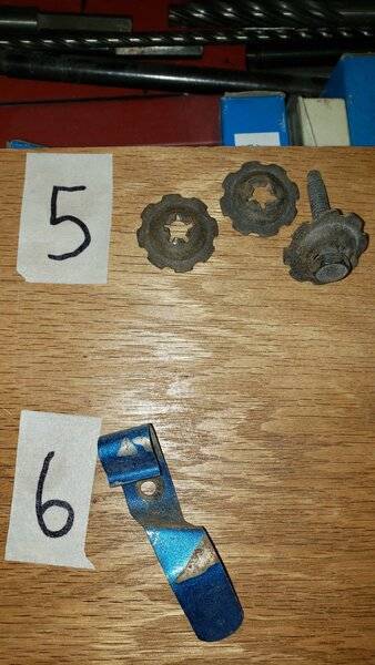

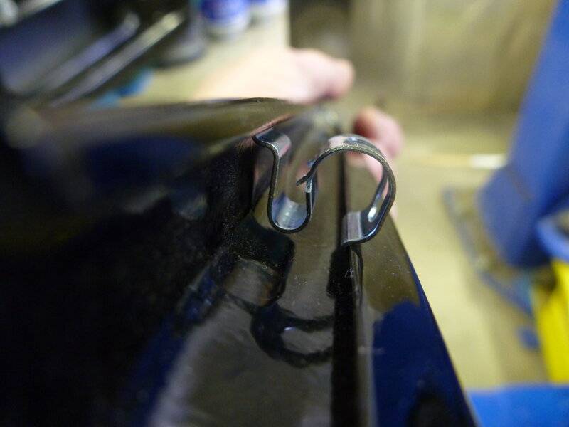

I'mgoing through my plastic bags an trying to identify loose hardware.
With some help from Yuse Guys, I'll be able to figure out what I've got!
Thanks!

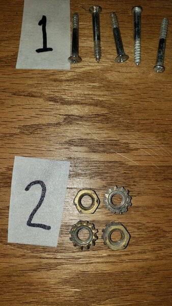

1 = screws for headliner side trim

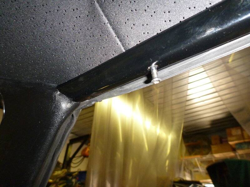

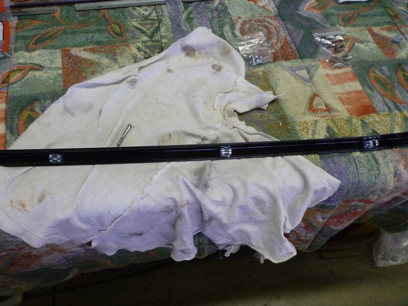

3 = headliner trim rail clips
5 = steering column retainer plate bolts/washers

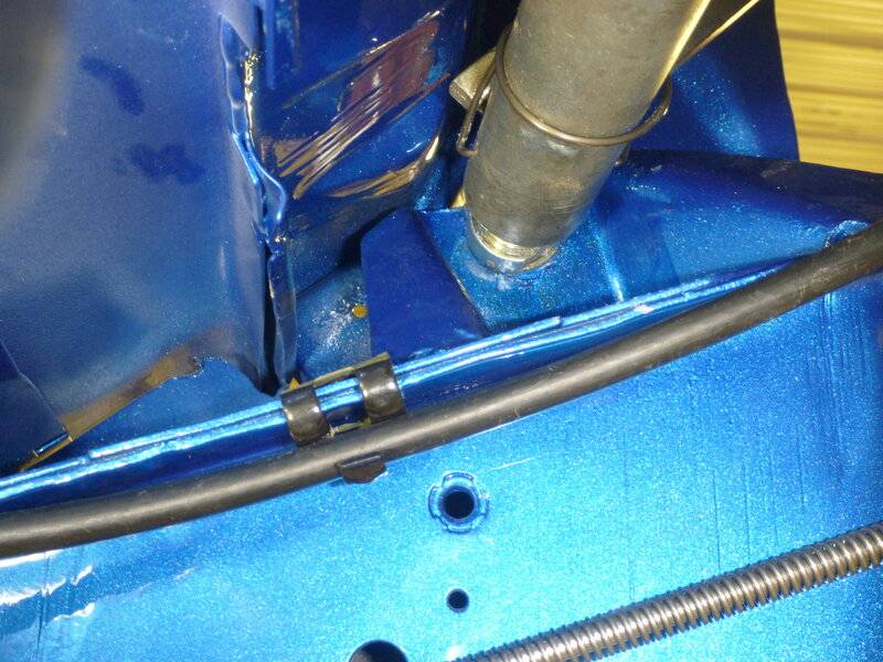

6 = speedo cable and brake line clip
7 = vent frame retainer for door glass

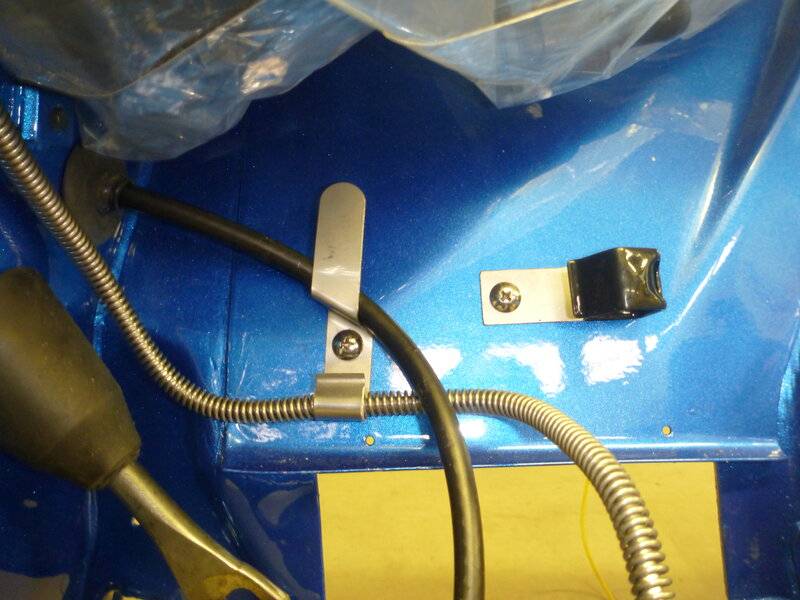

9 = what looks like the speedo cable clip for the frame rail

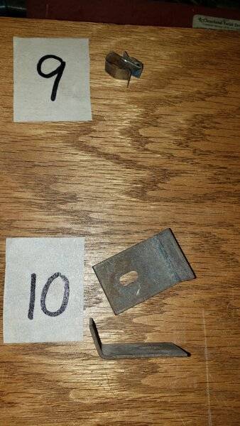

10 = retainer plates for the back seat hardboard trunk separation panel.
1) Look like interior screws for sure, like the under column bezel or some sort of dash or seat fasteners.
2) master cylinder studs?
3) look like line clips, maybe transmission cooler?
4) throttle or transmission linkage rod clips
5) under dash steering column - missing two nuts?
6) it's painted so could in the engine bay, maybe for wiring or a cable?
7) windshield washer line clip?
8,9,10) no clue!
1=kick panel screws 2=master cylinder nuts 4=door rod or choke rod lock clips 8=wiper motor cam
#1.....kick panels
#4.....retainer/lock carburetor
#5.....steering column to dash
#6.....speedometer cable support
#9.....wire retainer- lower dash lip
#8 wiper motor cam?
#9 speedometer cable clip on drivers side frame?
WoW! Thanks Guys! The light bulb is starting to flicker! The clip that holds the Speedo cable had me stumped bad. I love the pic's guys. I'm going to put them on my laptop
for reference.
1) screws for ends of sill plates, only half threads
2) MC nuts
3) roof rail retainer clips 68-70 2dr B-body & others
4) choke linkage clips, 6 pack end carb linkage clips. Not used in doors That I’ve seen
5) washers that hold steering column to dash, nuts are missing. Bolt goes forward on the bracket. 68-70
6) speedo cable bracket to inner fender, not for park brake cable.
7) Allen bold and nut holds wing frame to door on 68-70 2 doors. It’s under that little plastic push in nub by remote mirror control.
8) wiper cam in end of linkage to motor arm.
9) clip that holds remote mirror cables. They do make them for wiring with rubber on the end, but these are bare.
10) package tray retainer clips, 68-70 2door B-body
9 looks like a fuel line clip that goes in the engine compartment before it gets to the pump.
Looks like a box of Mopar stuff at Carlisle.
I offer $10
I'll even pay for shipping
OR, I'll trade 1 unobtanium undersize pilot bushing from my secret stash
:lol:can't help it, I'm a Mopar hoarder....
Think you got all the pieces correctly identified!
The first thing I have to do is glue in the trunk seal weather stripping in, hang the deck lid,
align it, install the taillights with the new bezels and quarter extensions, install the new rear
finish panel, and install the rear bumper. Whew!
