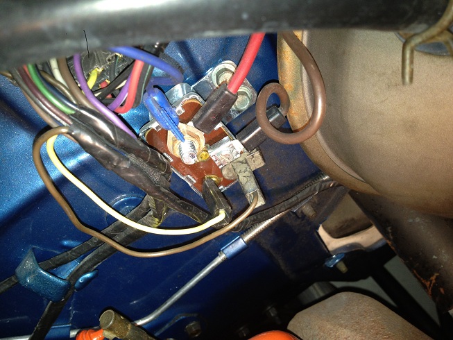

Thanks! I checked and this silver box (regulator?) is loose and all the wires seem loose as well. Considering there's power going through it I will remove the battery and tighten everything down.
I think this MAY be the problem!

that " silver box"...is the starter relay... clean up all those connections too. thats the main link between the battery,,,the key switch,,,and the starter itself!

STARTER RELAY! OK... now I know one more thing! Thanks tpo!
I dunno about too much advance.. once it decides to turn over, it usually starts right away. I'll drive around tomorrow if it doesn't rain and see if tightening everything down helped.
That second bottom bolt on the relay wouldn't tighten down. seemed to be spinning with no nut behind it but the top one has it pretty well sungged down. I guess eventually I will squeeze my fat *** under the dash and try to find out what's the deal with that second bolt.
You may be on to it.
Starter relay has to be grounded and connections tight lol nice find glad it worked out.

Just get a bigger tek bolt for it, no nut there.
Thanks everyone! Looks like that was it. Drove around all day yesterday and it was great. No stutter. Started up every time..
