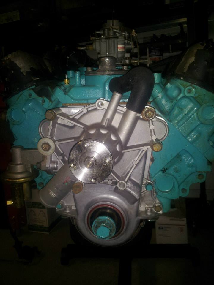

Hi looking to find what is missing here its a 318 2 barrel ,from a 1974 sate with Californian emission spec,
any help would be a big help. I haven't been able to upload my own pics yet but I found this one courtesy of fbbo
what I am looking for is next to the osac valve roughly circled in the pic.
thanks again Ell.

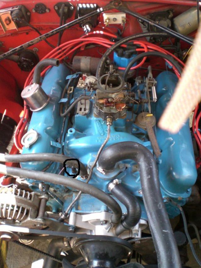

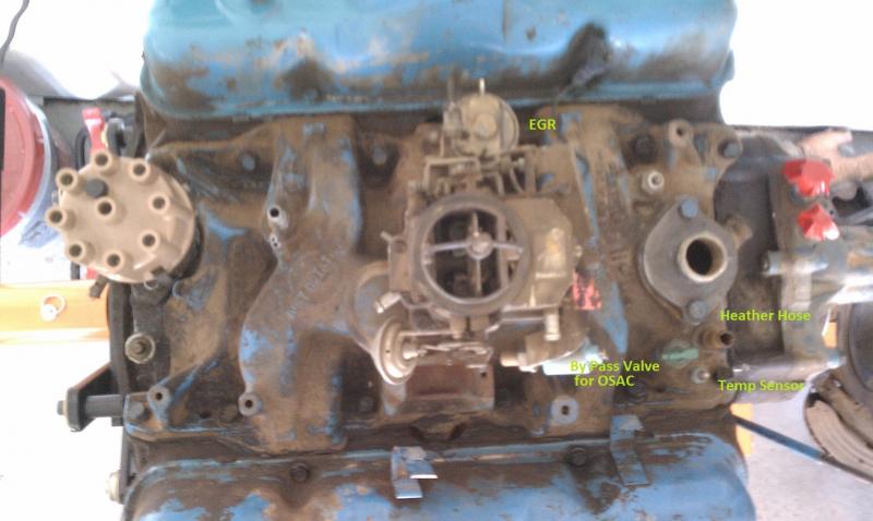

That appears to be the temp sensor should go. Here is a top view of a similar 318, newer 77, but I think should be the same.
Concur with the others. I have a 71 318 and that's exactly where my temp sender and temp sensor boot go.
